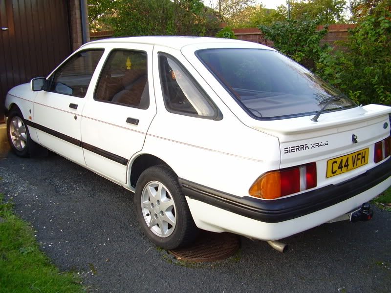

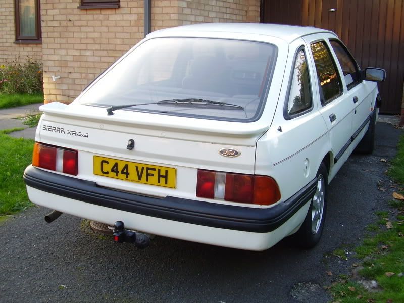

The other car is a 1985 Ford Sierra Mk1 Xr4x4
Standard condition, my aim is to refurb the mechanics and use the car as a fun track tool and possibly go to the ring.
The car benefits from a full service history and only two owners from new.
I have replaced the front and rear shocks, front springs and bushes, and fitted new discs with EBC green stuff pads.
Engine wise it just has had a full service with all fluids done and pulls really well for a 20+ year old ford.
Its not mint, as it has seen some welding but the structure is sound.
