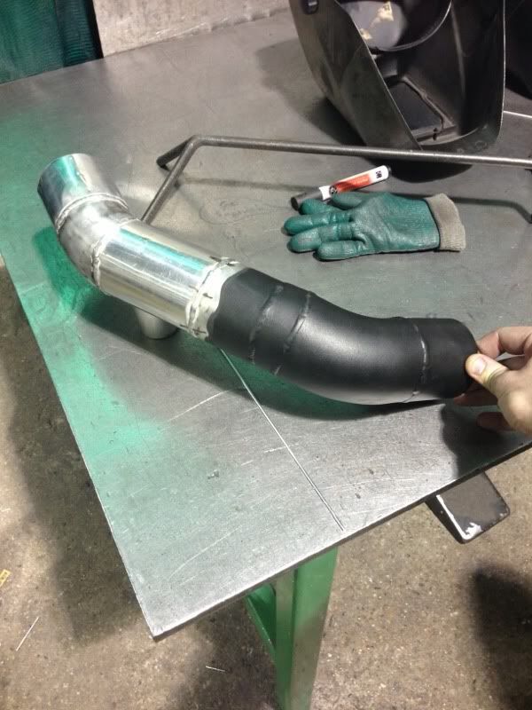

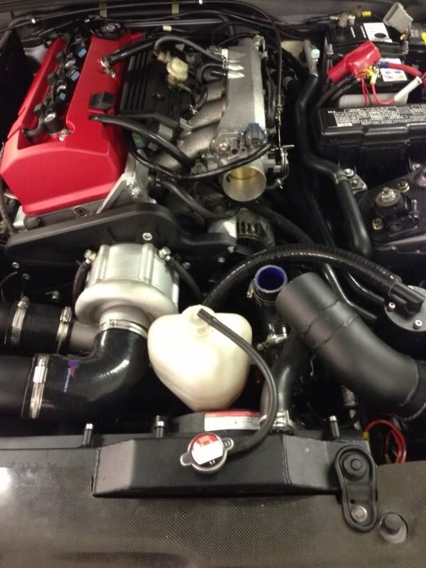

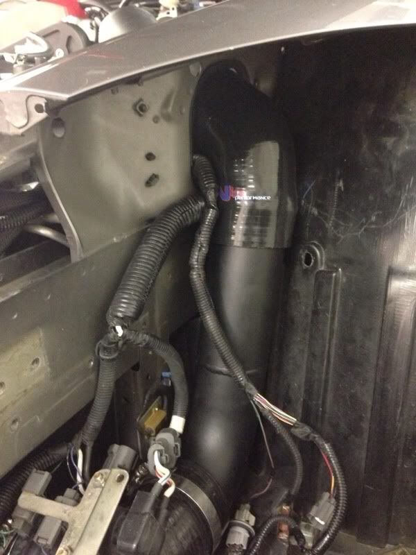

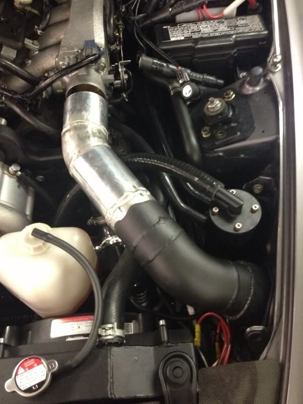

Anyway decided to chop my boost pipe around as wasn't happy with it. Just waiting on a new loom to be made for the new ecu so car can't be used at the moment plus its shite outside. I basically cocked up as I made this piece in one which meant I had to take the bumper off to take the pipe off. So I have cut it in half and made it fit better,

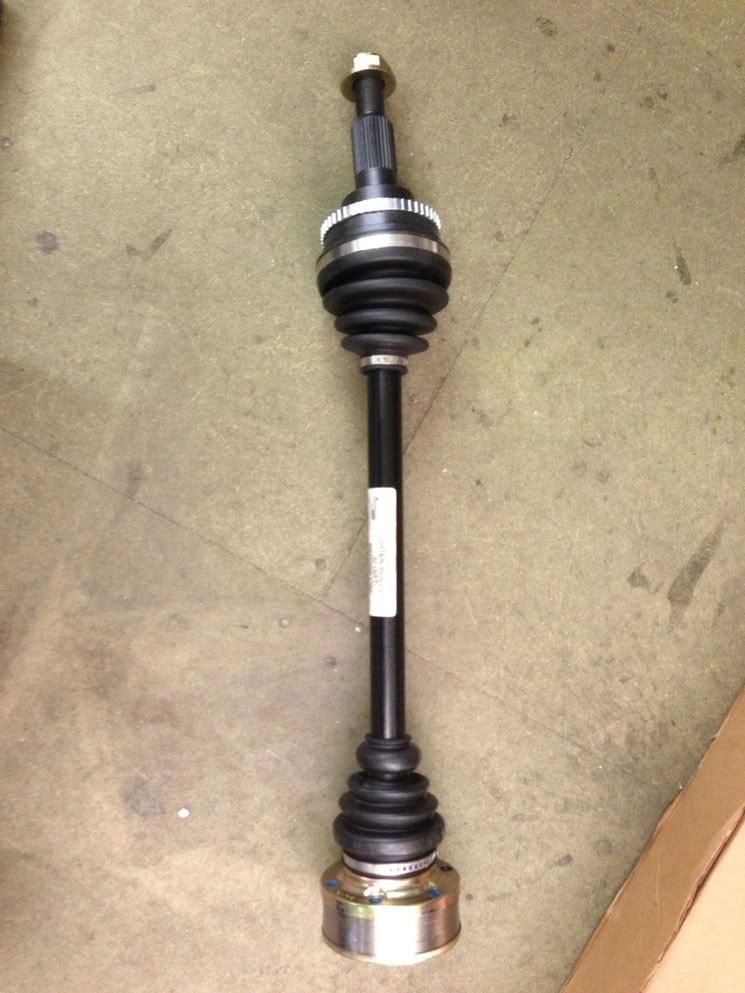

The pallet from America came today. Had to sort it out as there wasn't just my stuff on there.

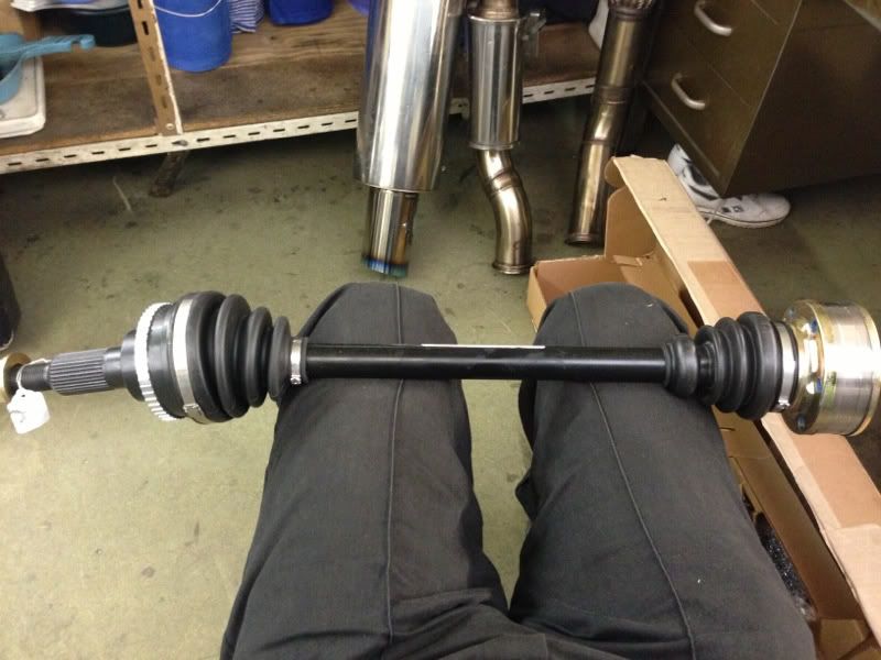

I have now got my new rear end kit. Driveshafts and propshaft looks great. I forgot to take any pictures of the diff mounting brackets and the new 74mm tb. It should aid for air flow into the engine as the stock one is about 62.8mm at the smallest point and the new one is 74mm at the smallest point.
I also haven't taken pictures of the flanges that bolt to the shafts. Also it has new hubs as they use larger splines that I have to swap out with new extended studs.

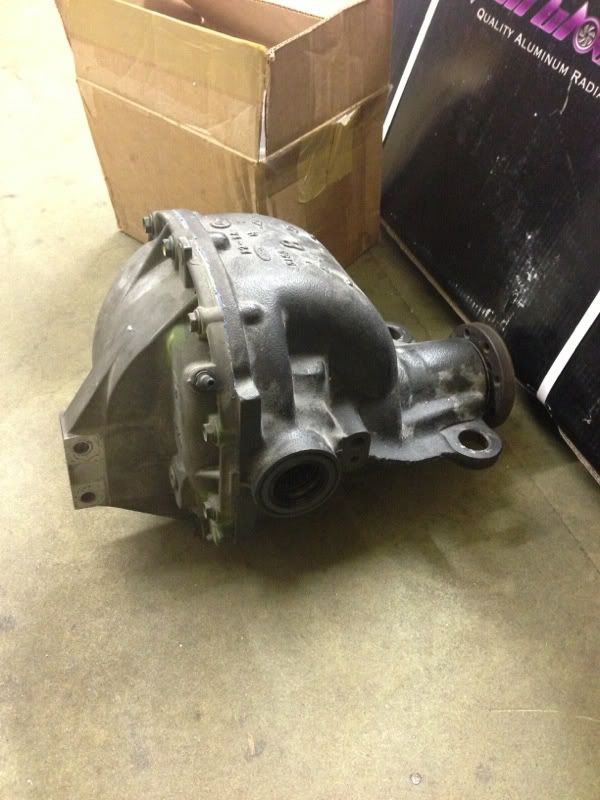

Taking the 300zx NA diff to have the new quaife LSD put in it as I just can't be bothered to do it myself as I have enough to do to the car before its mapped after Xmas. Oh and my girlfriend has brought me a new large capacity diff cover for Xmas.
