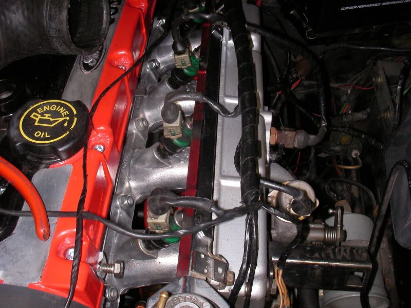

the car has now had the wiring loom fitted into the car
this is the only pic i took today
also the following jobs have been done and compleated now
