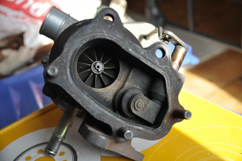

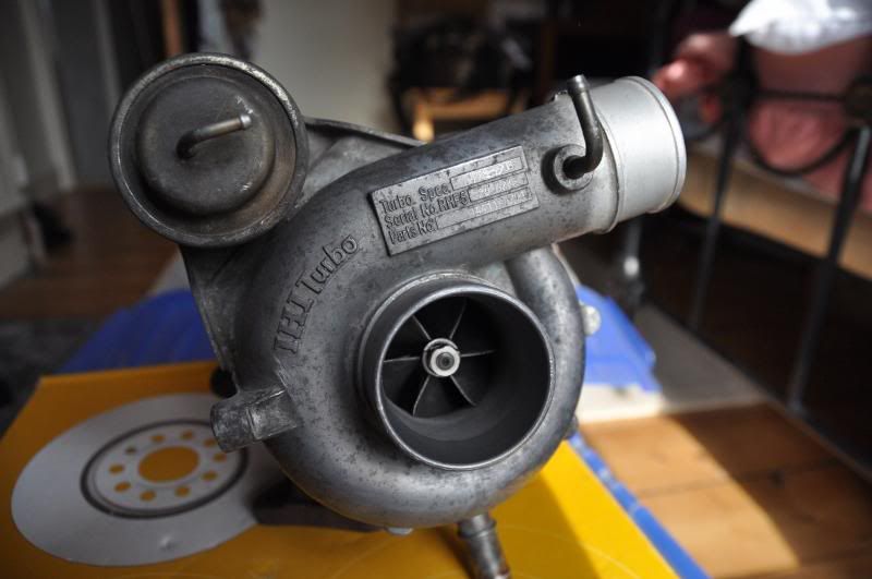

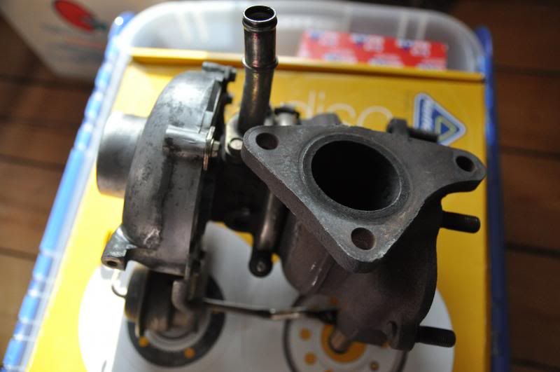

My turbo has been annoying me with a whine on shut down, it runs fine, no smoke, doesn't burn oil but just sounds whinney - So, bought another turbo :) .. hurrah.
No play in the shaft, runs smoothly so rather pleased. Still amazed at the good value the parts for the impreza are.

99% of the IHI VF series whine on spool down due to the roller bearing
