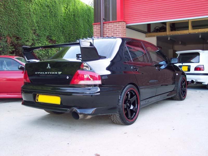

few more of bottom end complete...roll on head parts..............
gary@apt
Posts: 1527
Post by gary@apt »
and a few off the new wheels and tyres.....
rota gtr's 9.5x18 et30 with dunlop ssr's 255/35r18 :-D
