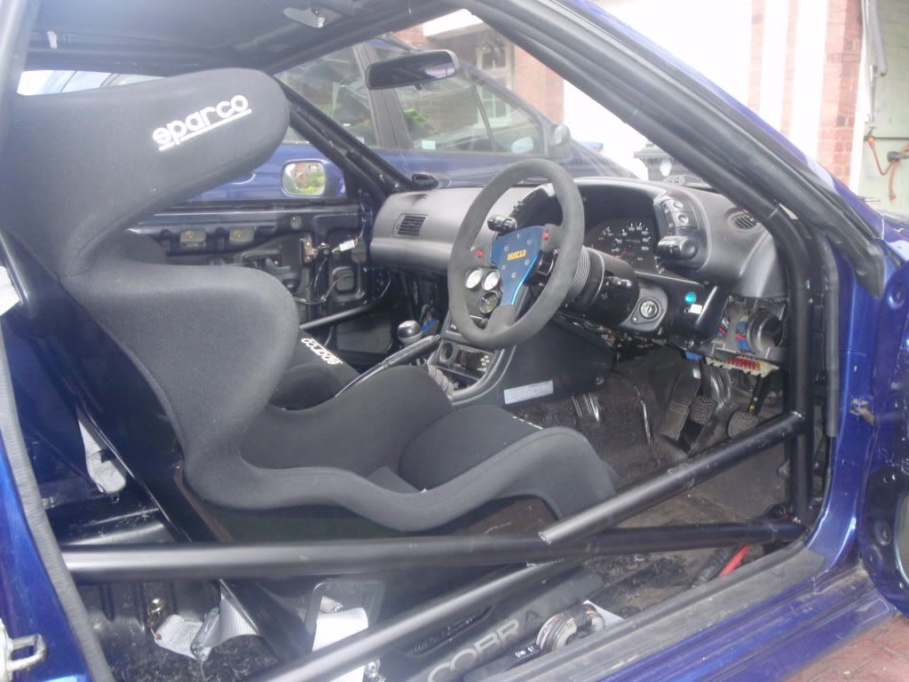

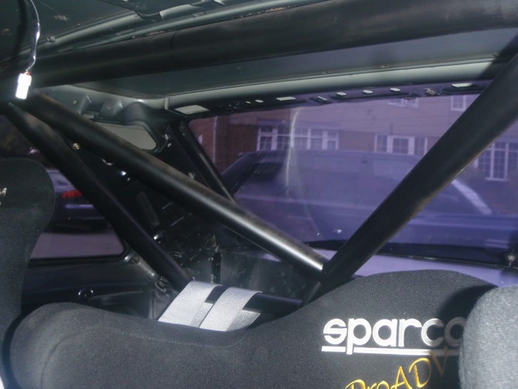

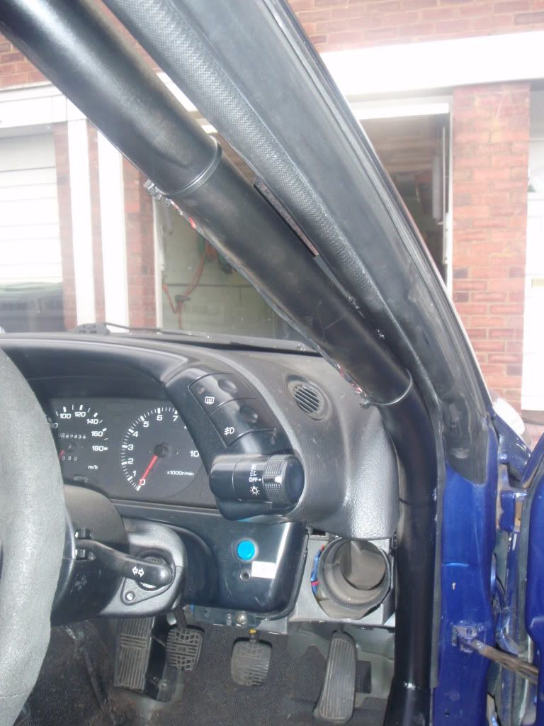

So another belated updated, although this time because progress has been slow rather than me not bothering :toetap05:
Picked the car up on saturday with the cage all finished, new rear bulkhead made up and front tow eye done.
I'm really pleased with the cage, great job and plenty of head space compared to the Zed in terms of not having my lid resting against it constantly. Steve managed to get the front of the cage down the sides of the dash so didn't even have to chop the dash up which is cool. Saying that, it does press against the doors making them v hard to shut, although I'm going to chop the doors out to get the weight down so this should be a temporary annoyance.
Unfortunately dud to time the rear arches weren't done so that's a job still to do, but as this doesn't stop me getting on track i don't really care.
Some pics, although hard to show anything really.

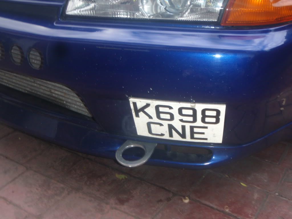

Tow eye, gotta paint it
