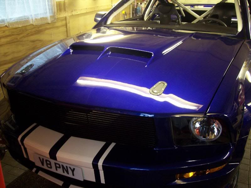

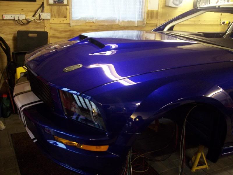

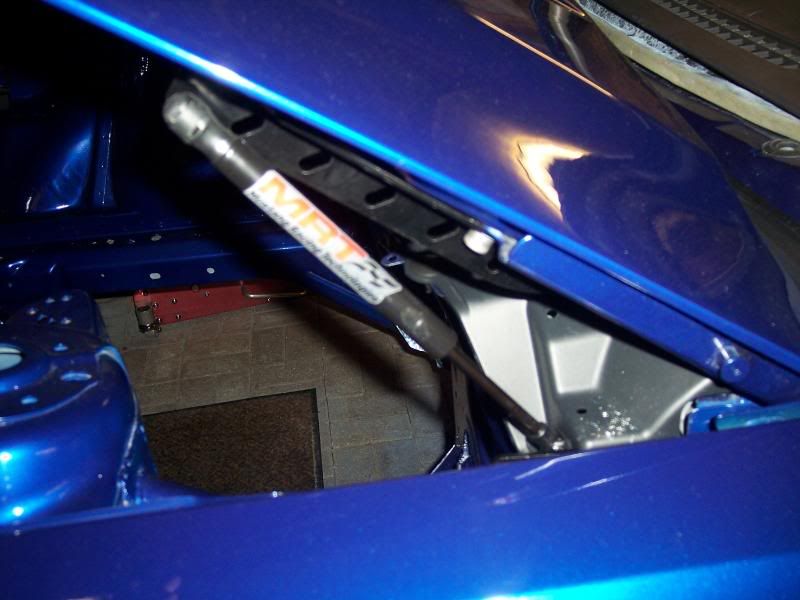

Got the hood back and fitted it to the car with aero catches and rams, big thanks to Stuart and the guys at Camul

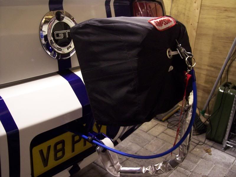

Finished off the parachute release cable and lever

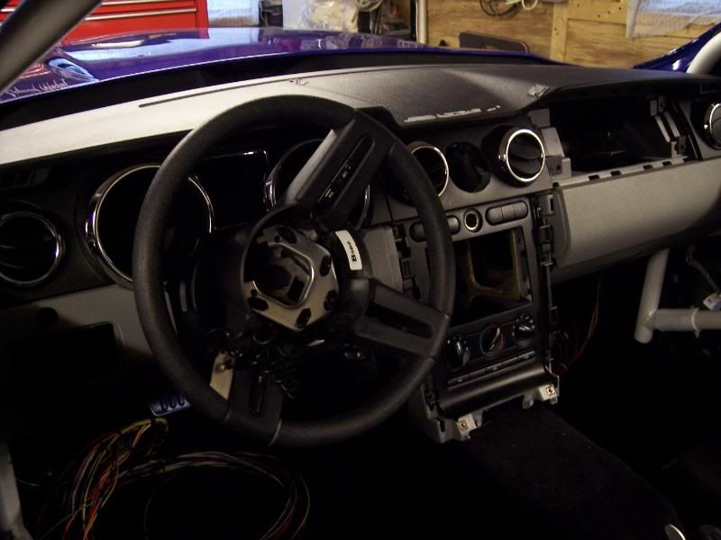

Started mocking up the dash so I can see where I need to feed wires and put gauges etc

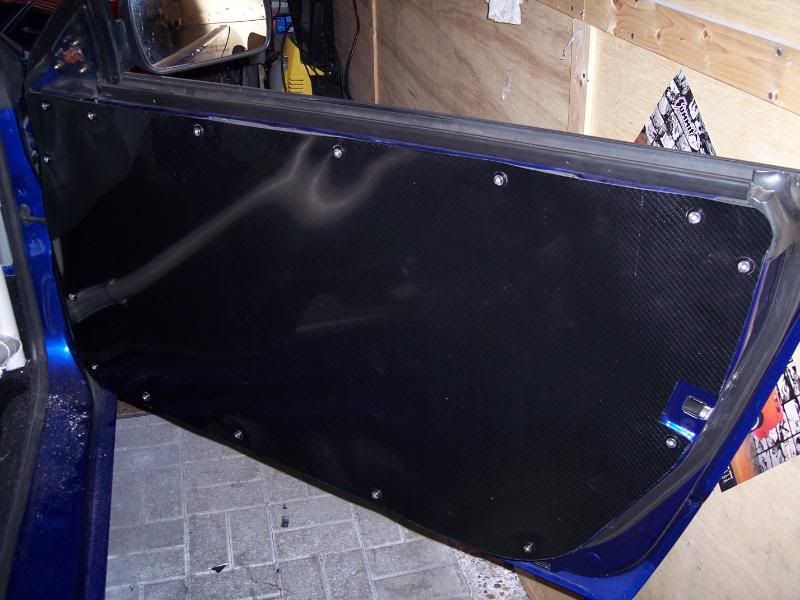

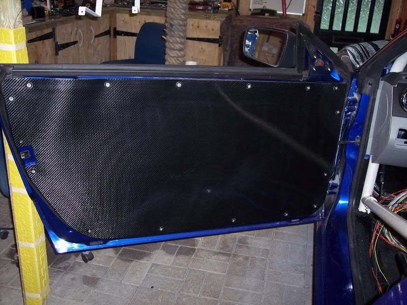

OK, thought I would bore you with details of the door panels only because it took a lot longer than I thought mainly because I didn't want to start hacking about the carbon without being sure I had the measurements right. That stuff is too expensive to keep buying a new sheet if you balls it up.

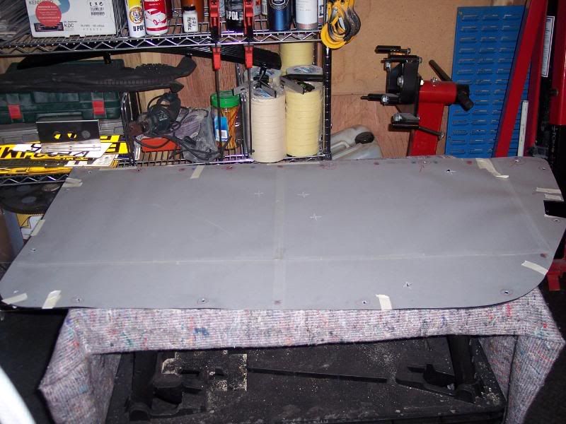

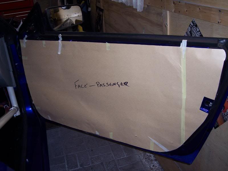

Anyway, started by cutting a template out of card

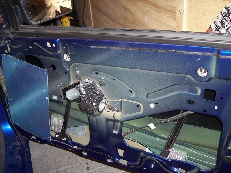

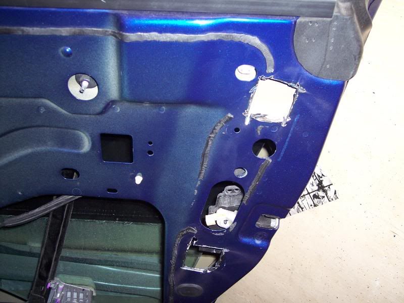

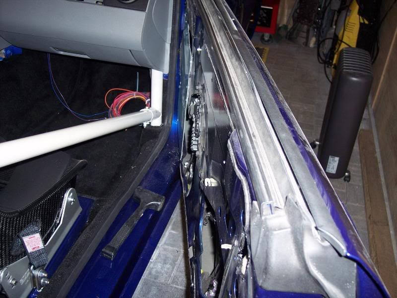

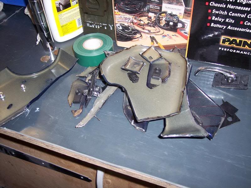

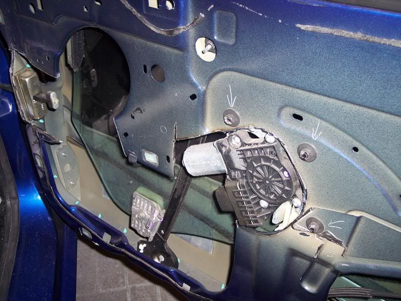

Once I was sure it was the right shape I took it off and started cutting out the inner door where it was sticking out for previous fixtures so I could get the panels as flat as possible
Where I had cut out the largest section I fixed an aluminium plate to add the strength back in

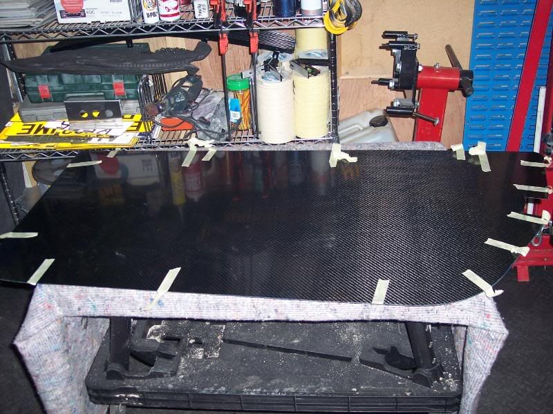

I then laid the card cutout on top of the carbon, marked it with a china-graph pencil and cut out the shape

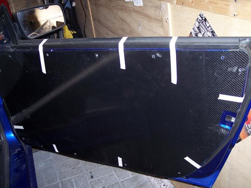

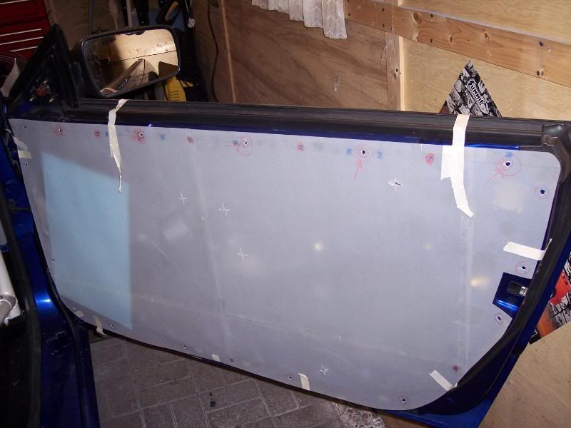

I taped the carbon to the door to make sure it was OK and wanted to mark out where the fixings would go but realised you can't see what is underneath and didn't want to drill where I wouldn't have a fixing underneath. I joined some tracing paper together and laid the card cut out on top and marked out the door panel on the tracing paper and hung it on the door
I could then see where to mark the drill holes, transferred the tracing paper onto the carbon and drilled through
I then hung the carbon back on the door so I could mark the door where I was going to drill

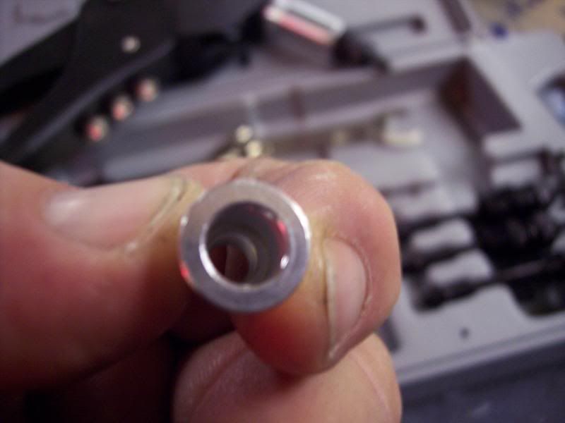

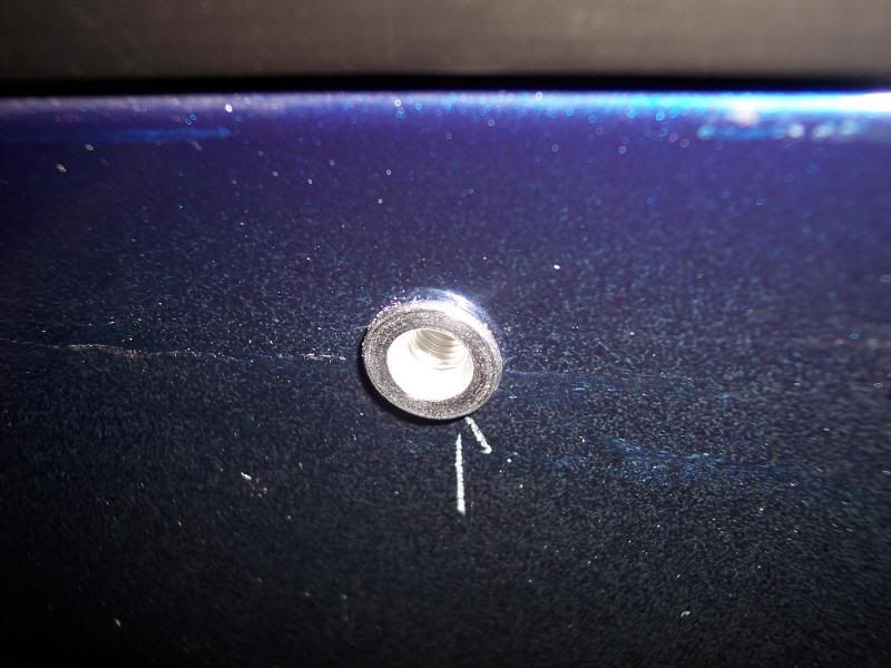

Once I had drilled the holes it was time to fix some threaded inserts so I could bolt the whole thing on

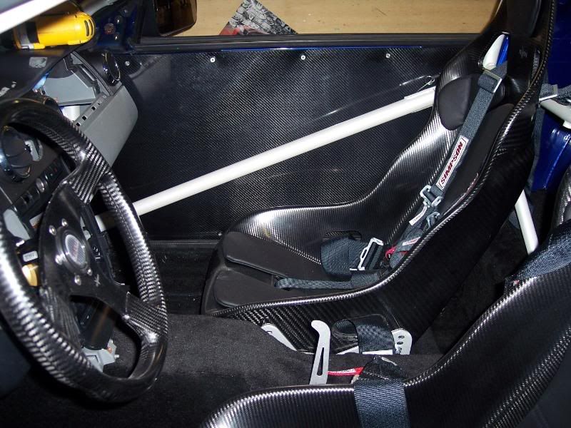

Once I had fitted the inserts I turned the carbon over and fixed some foam strips to the back of the panel, hopefully this will stop any vibration

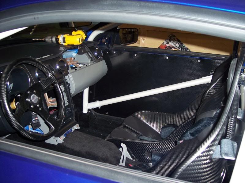

All that was left was to bolt on the panels
