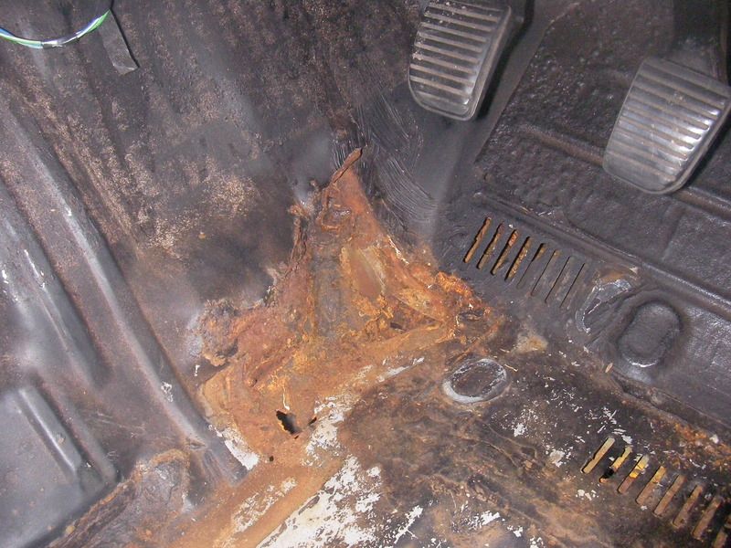

well between working on the garage and in the garage things are coming on nicely.

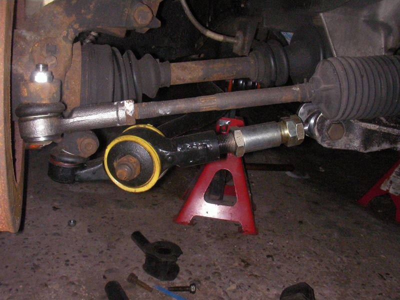

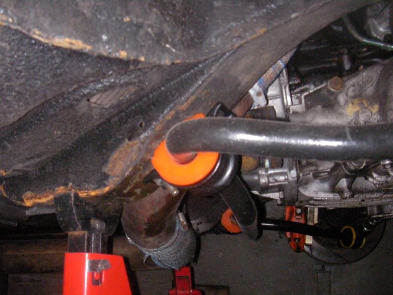

fitted the ARB polybushes but snapped a bolt in the chassis rail so had to dig the remainder of the nut and bolt out and replace it which was a pain in the backside.
the adjustable have been fitted as well at standard length for now until we can get 3degrees set up on them

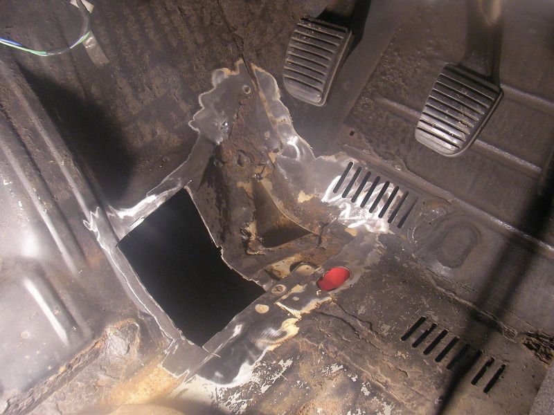

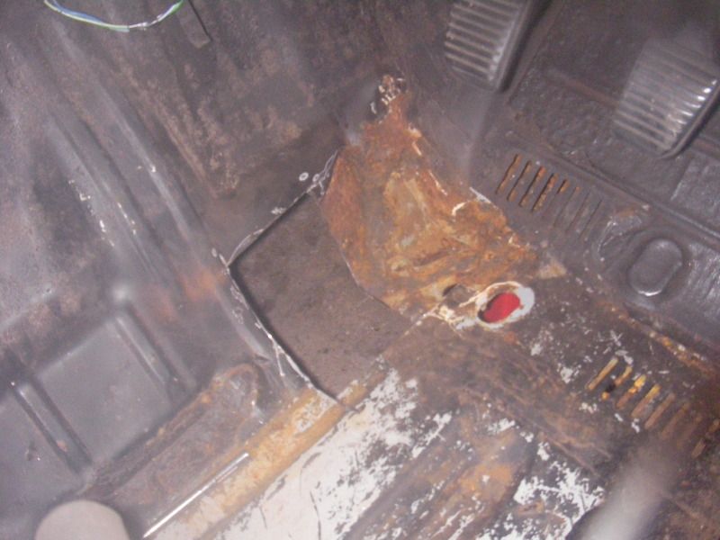

also while under the car doing the ARB I notice a small hole about the size my little finger and as we are having some welding done to the car tomorrow thought I would clean the area up for a small patch to go on
however with any old ford (Hay Dan) its never small.
pulled the carpet back and found this
so ended up cutting more out than first anticipated being careful not to cut into the gearbox

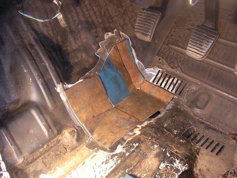

so cleaned up the area and fabricated some plates to go over it
plates have been cleaned up ready to weld into place.

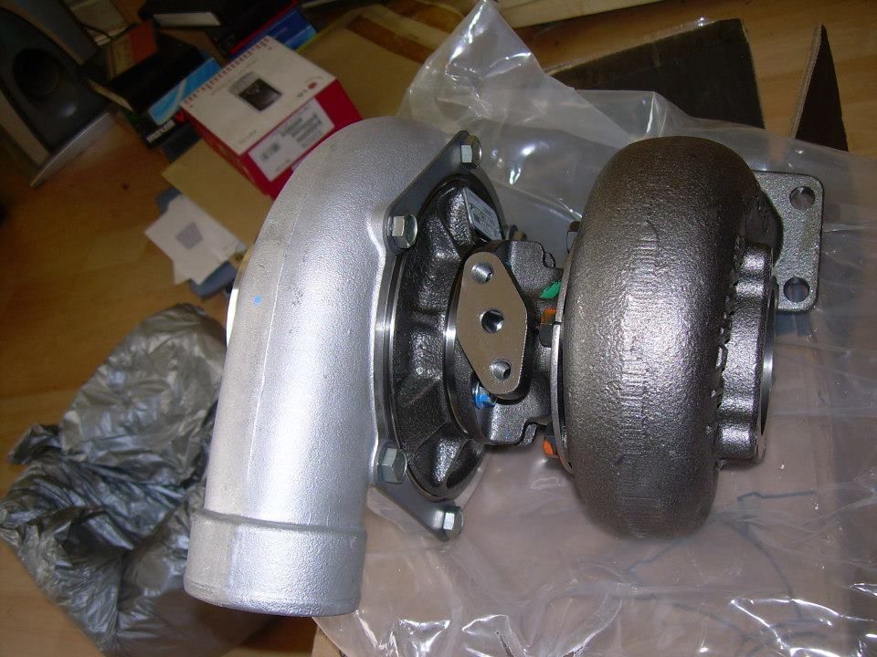

Had a nice surprise today the turbo is back from being rebuilt. Thanks to our new sponsor Turbo Technics
