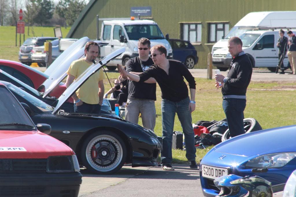

Yeah I thought you were saying 'up yours rotary!!' in the first pic mate !! Have to agree with Chris that it doesnt look like you at all.

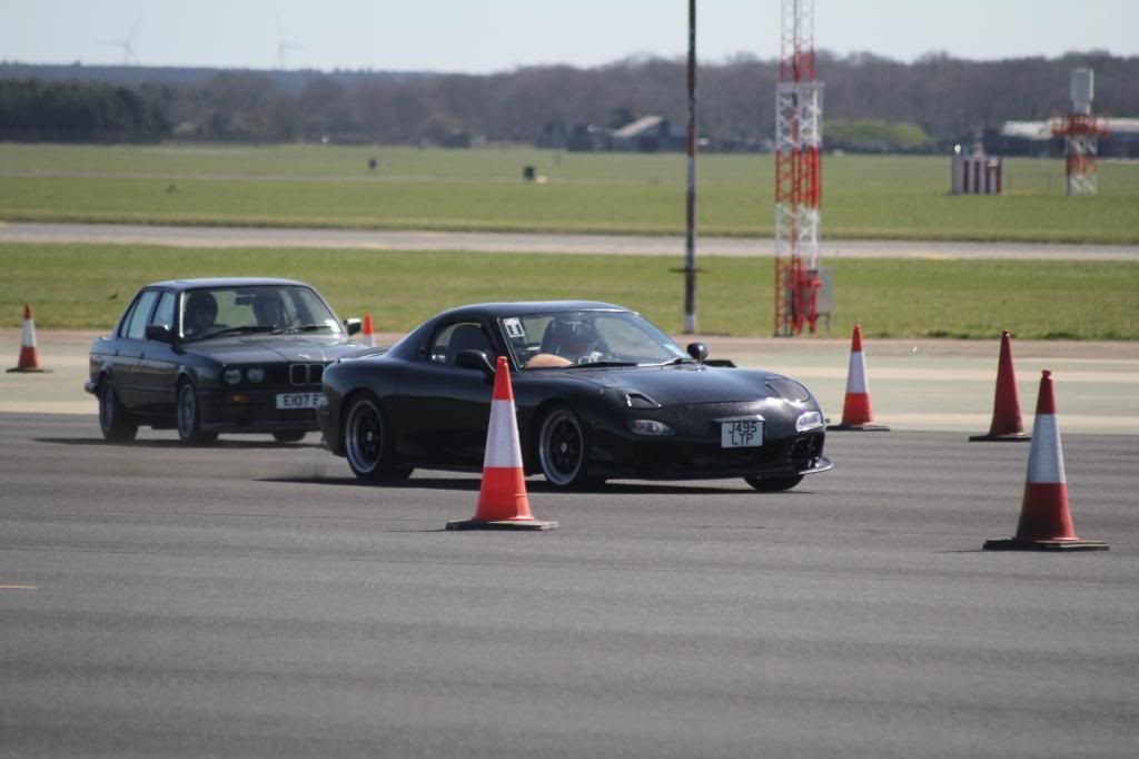

Yeah any airfield is a stonechip haven. Glad to hear the Rex went well though.
