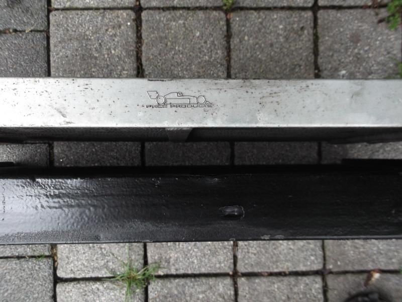

when I picked it up I had my suspicions that this was a RS500 intercooler from the pics.
the seller confirmed that this is indeed an original RS500 motorsport intercooler :sifone:

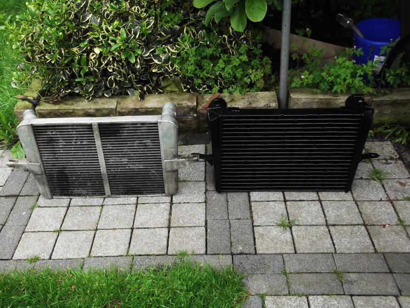

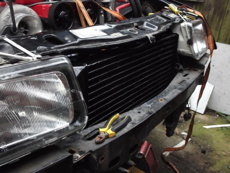

this morning got car up on the ramps and got the old one off and you can tell by the pics
how much bigge this one is.
core size is 20mm wider
15mm thicker
inlet and out let pipes are 3" against 2 1/2"
this is a tight fit into the car, fills the space a lot more.

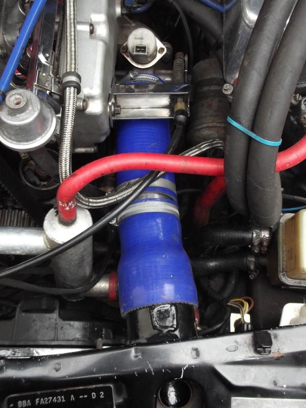

intercooler came with a reducer so was able to pipe up the intercooler to throttle body.
with Gary's top tip using hair spray sleeved in a pipe and fitted.
the other side, I have to buy some pipes to get it all connected up, hopefully be sorted by the weekend.

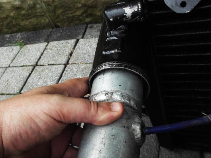

It was that session that made me realise just how laggy the turbo was but at the time i thought (wrongly so) that we needed to fit double valve springs to allow us to rev the engine higher. It was only when we took the car to the new tuner. As he wanted to check the car over and put it on his dyno to see where it was. That the real issue was high lighted.
Even though we had a plan of what we wanted to do he said the car should be making boost a lot earlier than that and the first thing he wanted to do was to check the turbo over and possibly change the housing. When Alan took the turbo off ready to send back to them he discovered all the leaks and problems.
The tuner agreed that we should fix all those little issues and then take it back to him and slap it on the dyno again, and then from there we can start planning the next step.
