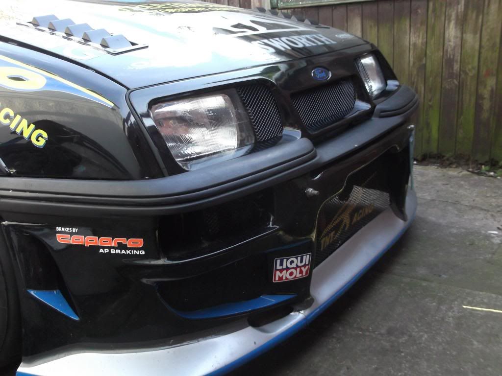

I think the youngsters refer to what you have as "hellaflush" and apparently i have " sunken battleship" . Pete
