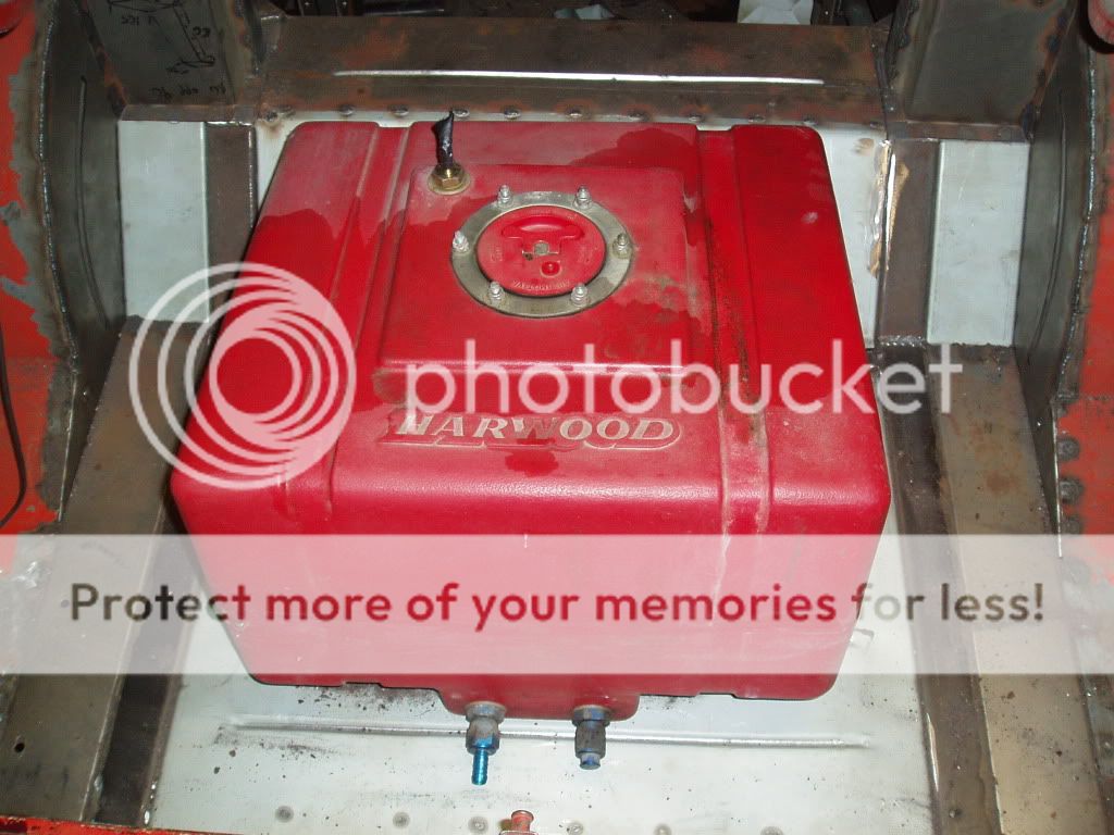

Swopped an old fuel tank for this foam filled one to go in the Prefect . I did away with the old fuel cap and welded up the hole , less weight , blimey fuel cells and weight saving its all going a bit hard core . The scoobys passed its MOT so thats all done now and i will give it a go tomorrow as its a bit shitty out today . its the first turbo motor ive had so i cant wait to get some fuel in the tank and give it a blast up the A11 , it needs it because it took several attempts to pass the emission test having been off the road for 2 years . I wont to see how it compares to a V8 . Pete:Chevy_anim:

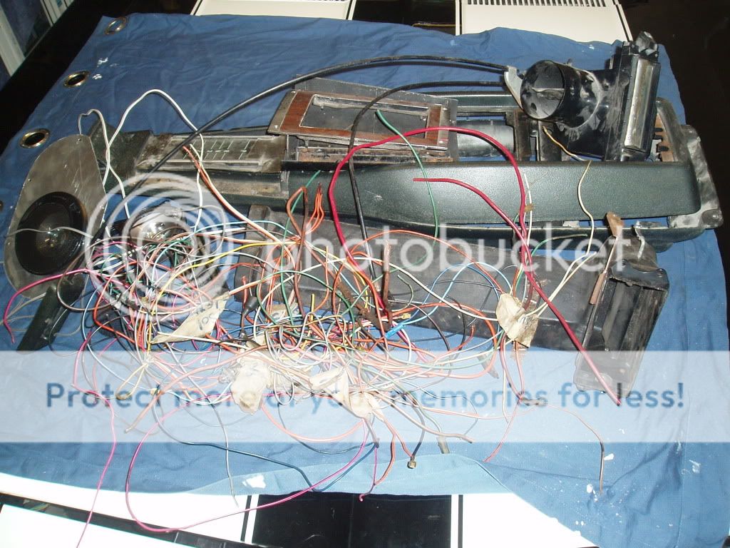

Been trying to find out why the Camaro has a misfire but iam not 100% sure its the dizzy so i thought i would check the wire loom . Its a real 42 year old birds nest with bits added / removed , taped up ends and wires going nowhere plus stuff hanging from under the dash . So armed with some cutters and a wiring diagram i spend an afternoon having great fun cutting out any unused wiring and i didnt just stop with the wire , out went speakers as theres no radio plus the under dash heating ducts as theres no heater . Out also went the center console which will give me room in future to fit a proper hand brake instead of the crappy foot operated cable thing that the MOT guy moans about every year . And here it all is
