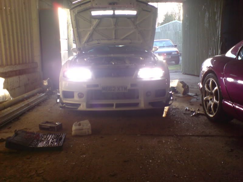

Bryan, you are not going to believe this mate but i actually got my kits from the states as the pound is so strong against the dollar at the moment i got two really good quality kits for a good price.
I researched which K rating to go for and in the end i went for 6000K as 8000K would have been a bit too 'blue'. I also went for a upgrade kit which run at 55Watts instead of 35 Watts for a bit more brightness!
I can give you all the details if you wanted a set.

Ok got this all sorted now, wired a set of one way diodes into the switch wires for the light circuits and the result is great!
Getting to all the wires was a bit tricky but its all good.
No more problems with warm up on the kits as my dipped beam is always on now.
