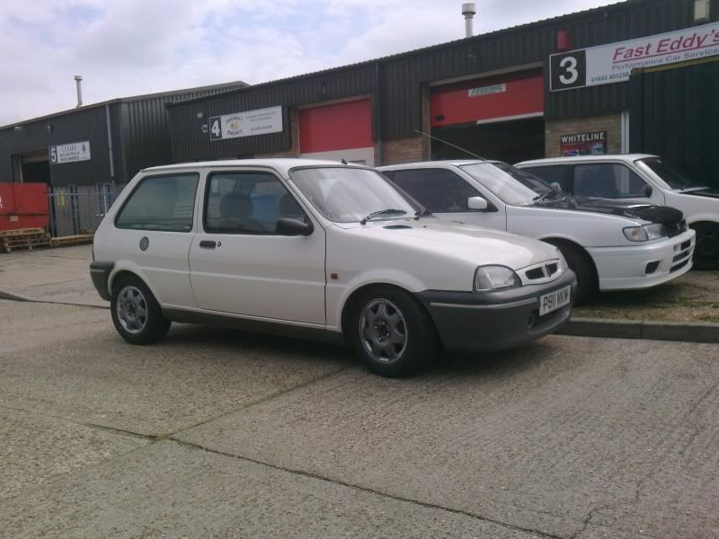

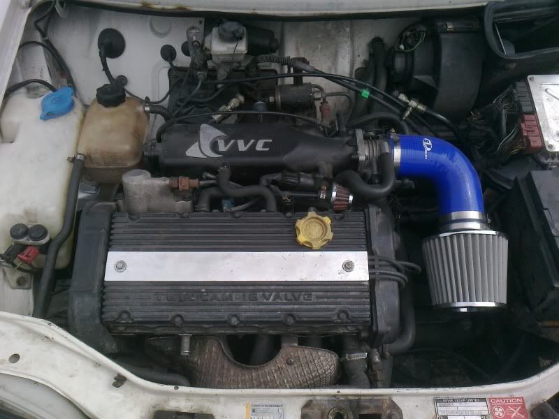

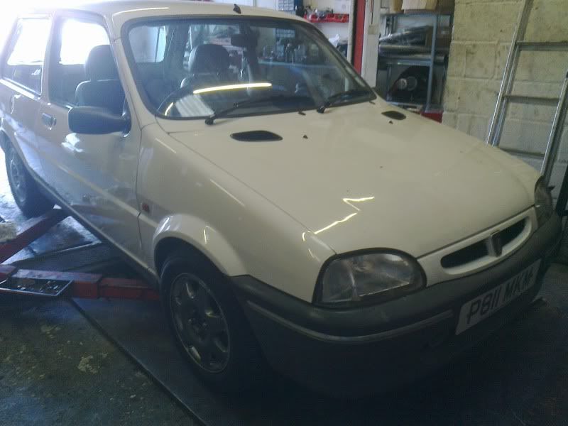

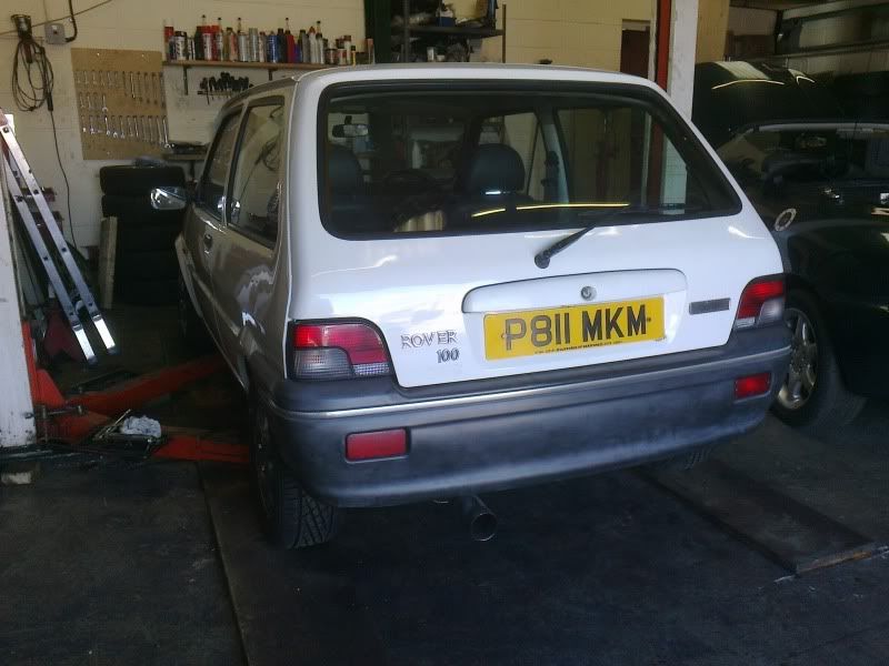

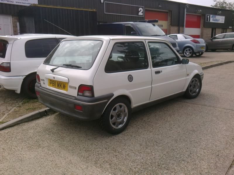

Well here it is. More or less finished for now. the customer takes delivery of it next week. He will get used to it and then add seats, harnesses, cage etc over the winter.
In the workshop getting finished off
The business end
Seeing the light of day after being on the ramp for 3 weeks
Spy the finished Pulsar in the background amidst the white car collection lol.
