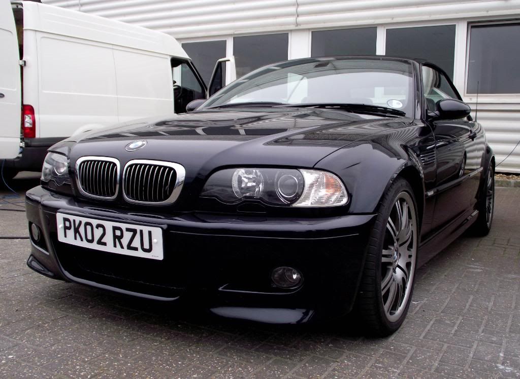

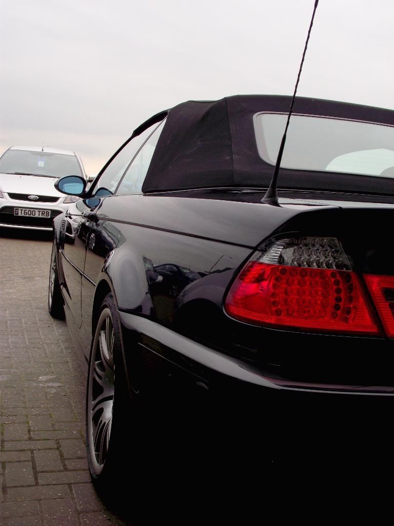

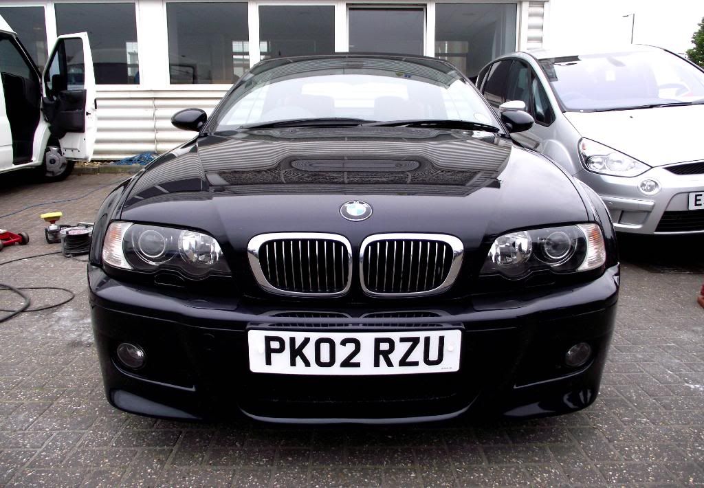

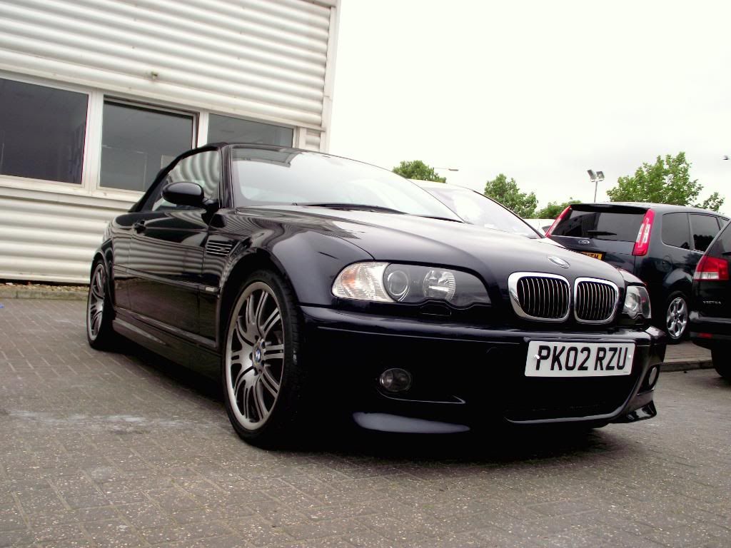

The lower half was literally a matt finish, it had been badly scuffed by years of auto car washes, the rear bumper was also in the same state.
Sadly i dont have any before pictures, as you can see i was pretty busy on it!
Started at 1030am and finished at 630pm.
I used 3m FCP on matching green compounding head, i did try Menz S100 but felt the 3M produced a better 'out the box' finish with less work.
I then went to 80349 Extra Fine on Yellow Waffle pad, which gave it a nice wet look. I ran out of time to use Ultrafina, so applied SRP by hand to finish it and give a bit of protection, i hope at some point to give it the Dodo Juice treatment.

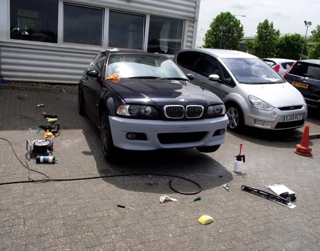

The front bumper was repainted as well, it had been done 5 times before! Massive improvement, one of the most satisfying jobs i have done in recent times.
Love the colour, Carbon Black is much nicer than a plain gloss black for these cars IMO.
