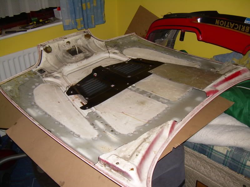

Thought Alan needed to have some fun today so let him loose on the bonnet :grin:
lmao 'barts room' :pmsl:
