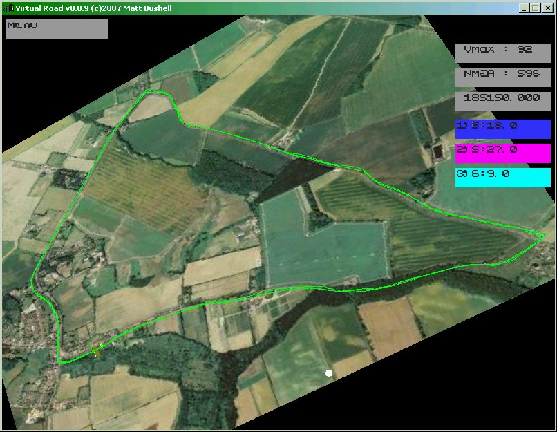

Local circular route, with lap times displayed

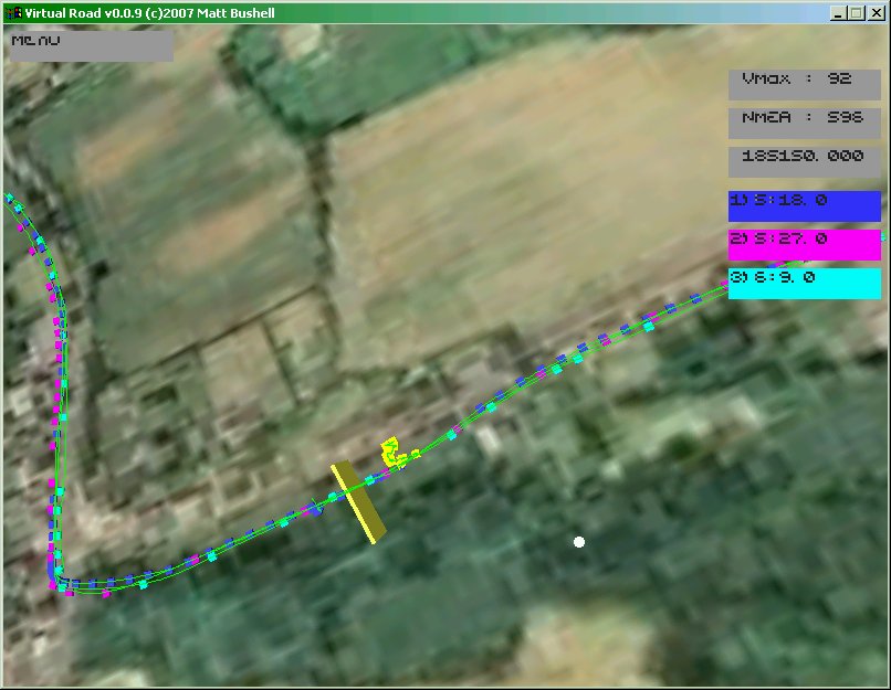

Close up showing a tight left turn at a junction, coloured lines indicate laps
Same junction but using cublic splines to show more acurate guestimated curves between points, this is actually a cheat at the moment as its not weighted by speed.
Each cube you see or node, is a data packet from the GPS hardware, and they come roughly 1 second apart, as a lot can happen in a second especialy on track databetween these points will all be calculated.
At the moment without calculating between points its acurate to the nearest second, but that refinement will come.
