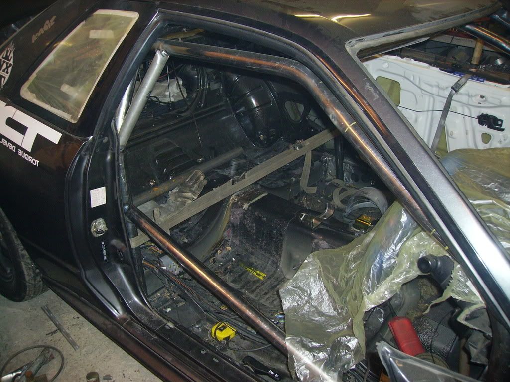

cage
Post by max1 »
some pics of the new cage Image

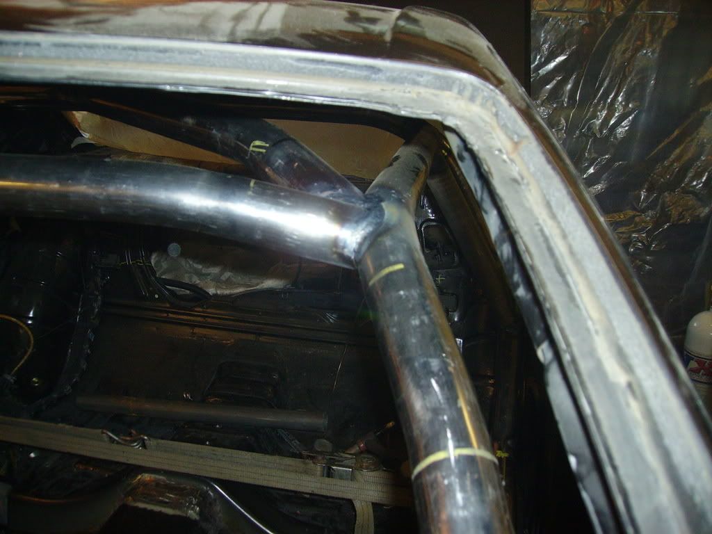

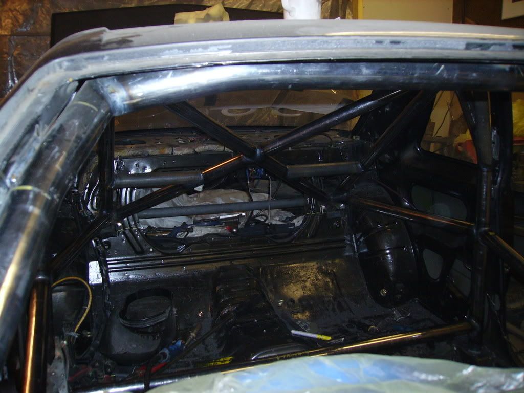

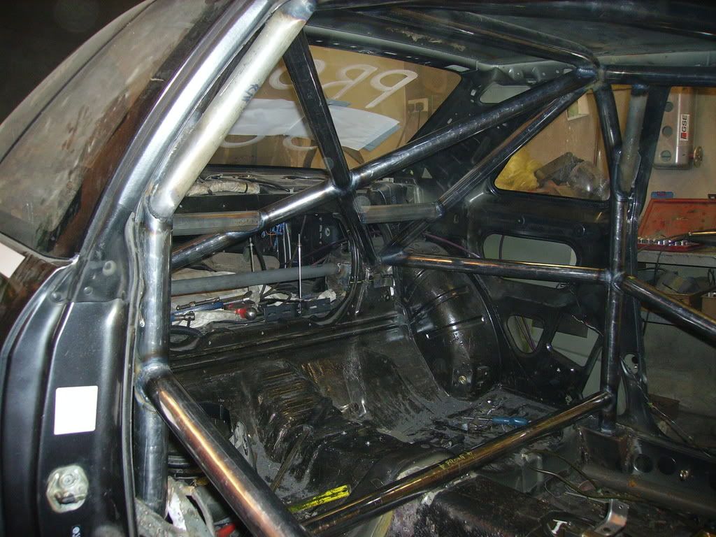

more
Post by max1 »

That looks really good Mark. Is the drop in angle from the front to the rear of the hoop that runs over the door deliberate? Any ideas why?

Looks very neat.
How did you cut the ends of the pipe so it would meet the round edge of the pipe you was welding onto?

think it a bit optical illusion on photo the bar follows the door upper exactly front pic is shown before it raised up to be welded in .the cage is built in situ then cramped together to drop it lower in order to weld upper joints then it is sprung into position and welded in higher up in the roof .does that make sense .you can see the straps pulling cage together in some pics .the cage was built by pro .woodsy07986491671.he will be able to give more info on specific cage and regulations for what you need .
