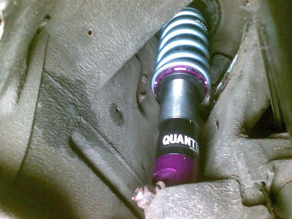

this week i have got the quantum suspension back from scm who fully refurbished the coil overs and new seals etc ,i have fitted them to the car .next was to tackle the camber and after finding out how much fully adjustable stuff was decieded to make my own ,i am re moving the lower front arms and re jigging to hole where the ball joint goes in to give a longer arm bit like the nismo track ones .i have altered the top arm mounts both sides to give approx 10 mm adjustment and fitted nismo top links with concentric bushes t give enen more camber. the front tie rods i have are already adjustable so prob jus tweek then in a bit .
next was the problem of the top mounts as now i had cambered the wheel in the coilover strutt did not meet up with the holes it origionaly bolted to so a little more fettleing was needed to slott holes to make them line up .aha finished ......not then i realised the strutt brace on top off the engine no longer fitted so this as well had to be altered ,i have just got to measure the full camber to see what i have ended up with and i rekon after a few drawings and my new tesco math set complete with protractor ill have it set up nicely.

Sounding good mate. That Quantum stuff is supposed to be really top draw.
Who are SCM?
When is the first proposed outing for the car too?

scm is a guy at kesgrave who does all kinds of suspension rebuilds car and bike ,works from home does a top job .tel 01473623250 deric tell him i gave you the number he jus done my quantum stuff.

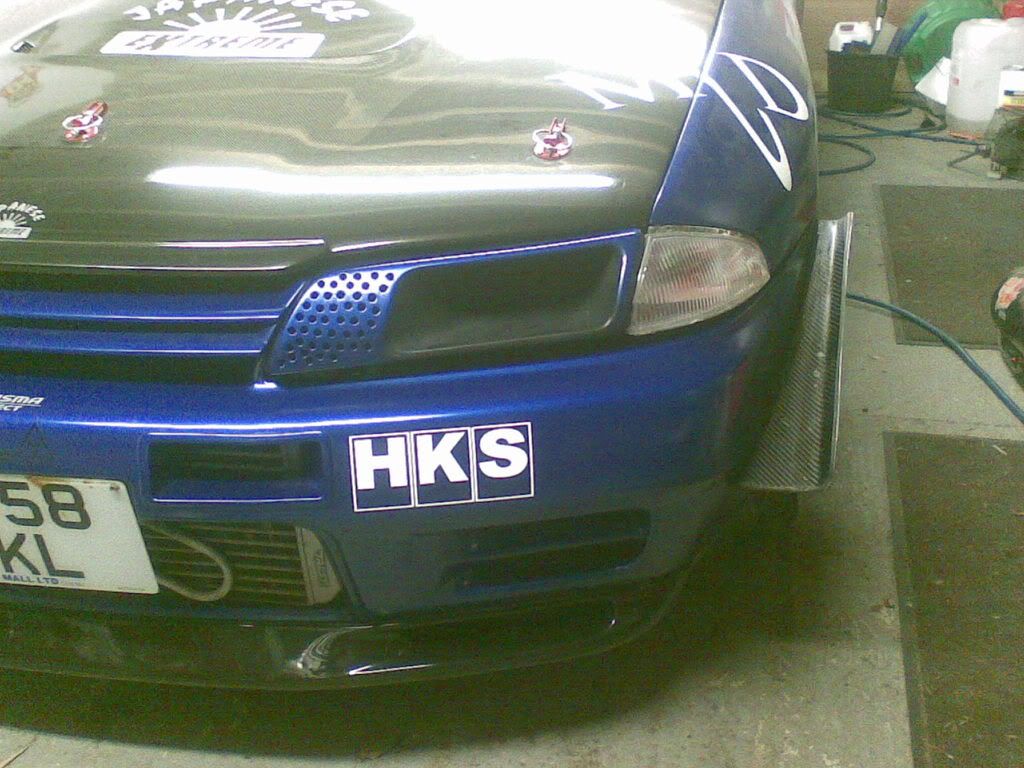

few pics today

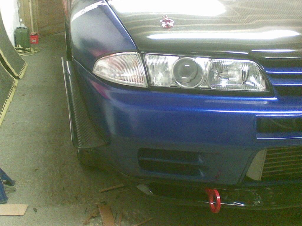

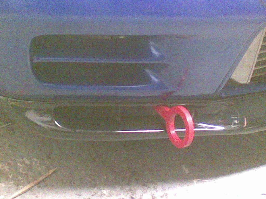

more...

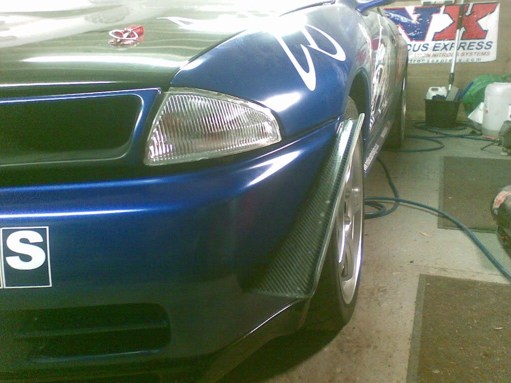

whats the verdict on my home made canards y/n was thinking of putting another underneath that one
