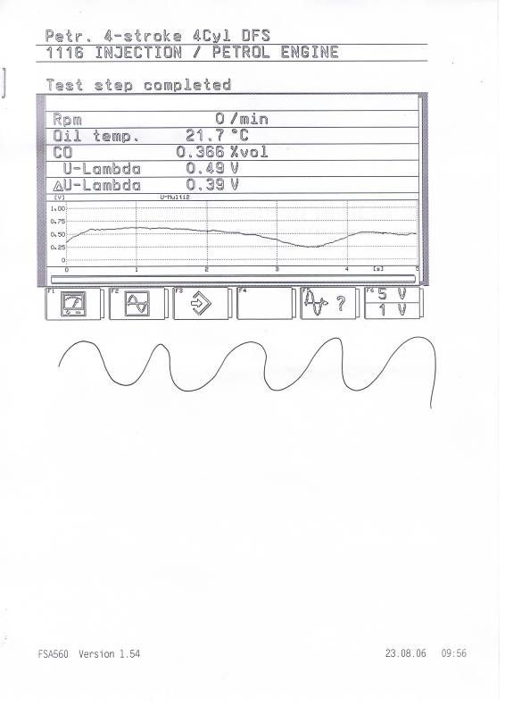

i was told i had a faulty lamda sensor which was only switching every 4 seconds!!
the exhaust was stock except a decat.

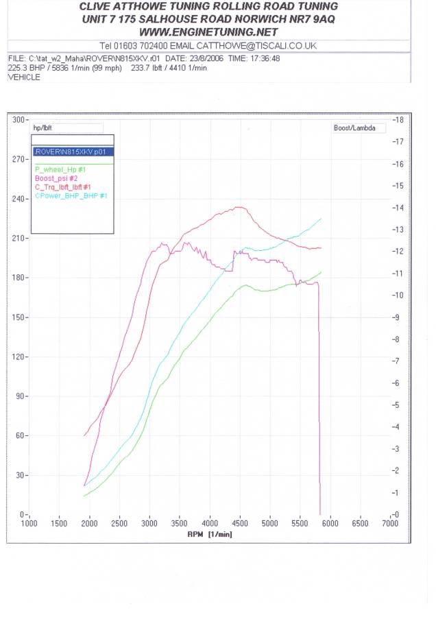

i had no idea what boost i was running coz i thought i had it set at 14psi but the gauge doesn't sit on zero when the engine is off, so must have been the reading of 12.5 psi. with a GT28R bb type tubby.......
clive also had problems getting her to sit on the dyno prperly due to the camber from having her lowered 30mm.
heres the vid...

the dodgy sensor results. note the drawing clive made to show what the wave should look like!!
