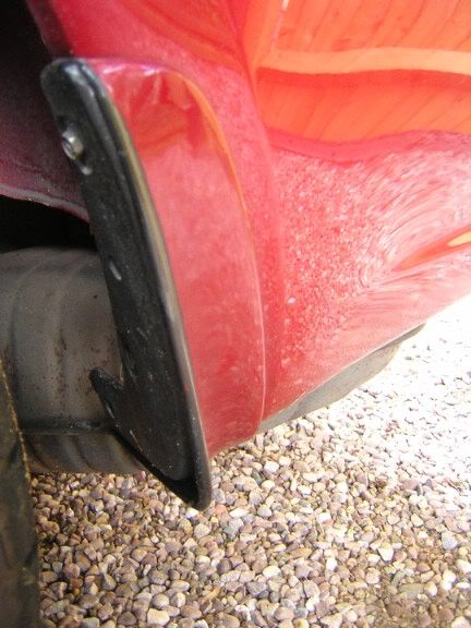

1. Check the front of the rear arches. Often aftermarket spats have been fitted. These can hide rust. I would strongly recommend removing the spats to check. They are only held on by two bolts each side. A 5 minute job to remove and replace.

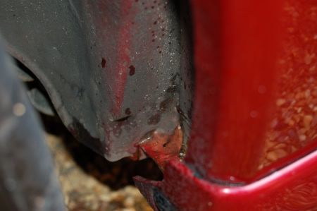

2. Check the rear inner sills.

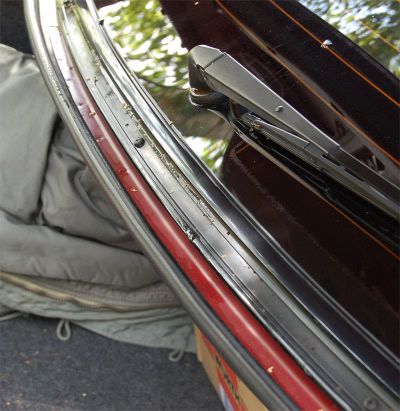

3. Boot rain gulley. Open the boot and run you finger (to clear the leaves and mess) along the gulley.
