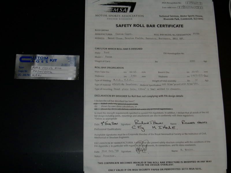

In a nutshell, FIA/MSA spec are very similar. Most of the race series that you're likely to compete in will all be covered by general cage specs, so even the cheapest 'proper' cages will be FIA or MSA spec. It is the cage design itself that earns the certificate, so as long as the cage is approved by the MSA (for example) then you'll be covered. Many of the manufacturers have embossed plates listing the date of fabrication, the regs that is passes or meets and who made it.
Something like this

As Stuart has stated an MSA log book would be required for any level of rallying. Below is a link to the certificate for my rollcage, as you can see, and as Stuart said, it is the design that is certificated and the installer. You can see how light my cage is on the certificate and this is down to the material and its strength, but its not cheap.
http://www.thesladefamily.co.uk/madcow/ ... Photo8.jpg
http://www.thesladefamily.co.uk/madcow/ ... Photo9.jpg
