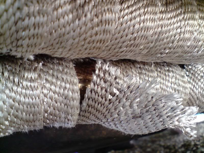

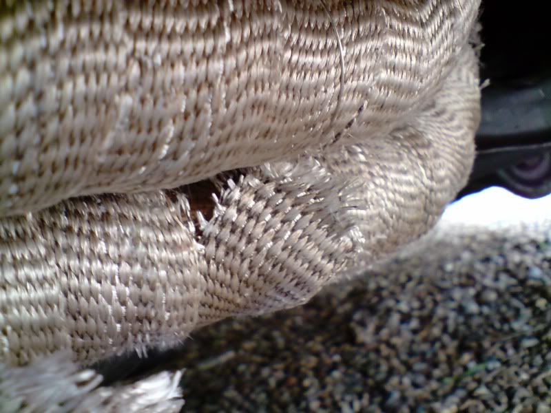

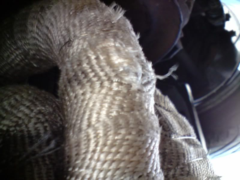

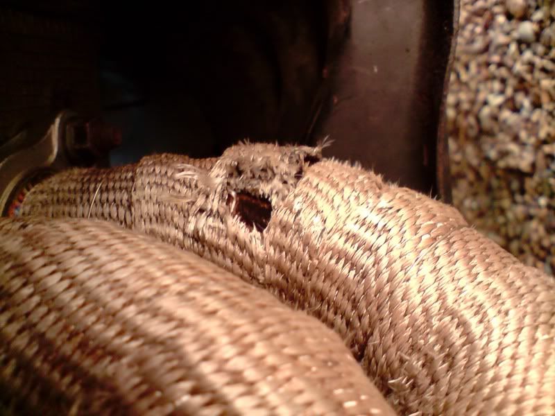

I fitted my gt-spec headers the other week, and wraped them in some good quailty heat wrap,and used stainless steel locking wire to hold it all in place.
the problem is, after a week the wrap is riping in a few places, and i do not think it will last long as it is starting to come off in a few places all ready.
is all most looks like the pipes expand to much for the wrap, and this causes it to tare.
i wraped each tube on its own, as far as i could.
so is there a problem with my wraping, or the wrap its self?

no, nothing touching them, some of the tairs are from between the pipes, one up near where it joins onto the flange onto the block
when the engine is cold, you can move the wrap abit with your hand now, and when hot, it is very tight

There seems to be two types of wrap. The shiney stuff in your link and a coarser dull finish from Rally(?), can't remember the full name atm. The dull stuff is the one to wet, the shiney one, definitely don't wet it as it loses it's shape and becomes a mess.
I found the shiney type didn't last very long at all and would soon split and shred. It seemed to not like being wetted by rain, etc. and maybe the salt gets to it?
The duller stuff is thicker and more dense and more difficult to fit. I found stainless jubilee clips best for fitting. Theyy cost a lot more but so much easier to work with than locking wire that soon breaks.
