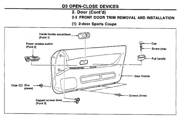

This is copied from your workshop manual:
Hope it helps !!

Just for reference.
Drivers door - basically as above .. BUT
Passenger door.
Screw behind bottom of hand grip
Screw behind window switch
then the same as driver door .. BUT
Don't do what I did and leave the windows open - dismantle car then realise that I no longer have a switch to close windows with !! .. doh
