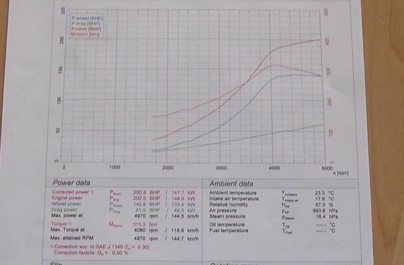

Down to buisness finally we have a power graph, and video and to follow
Run was stopped at 4900rpm due to the car starting to pink, caused by fueling lean at the top end, this will be sorted next week :-D

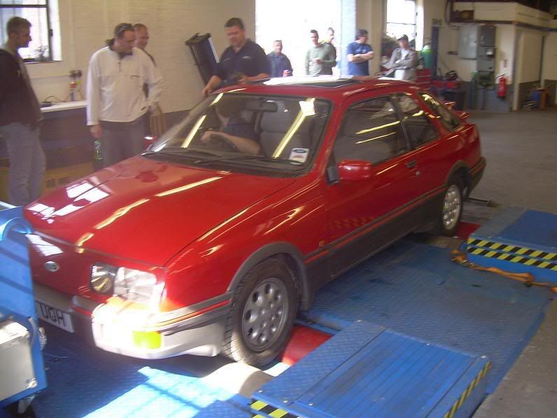

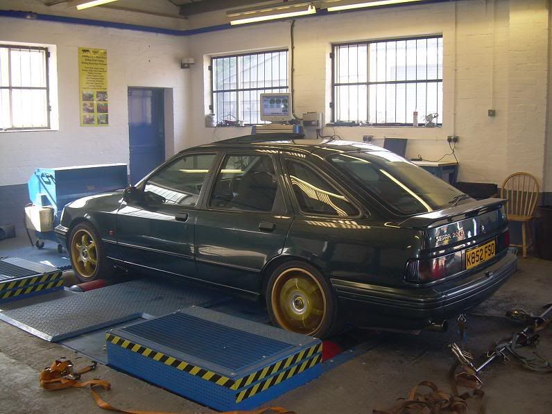

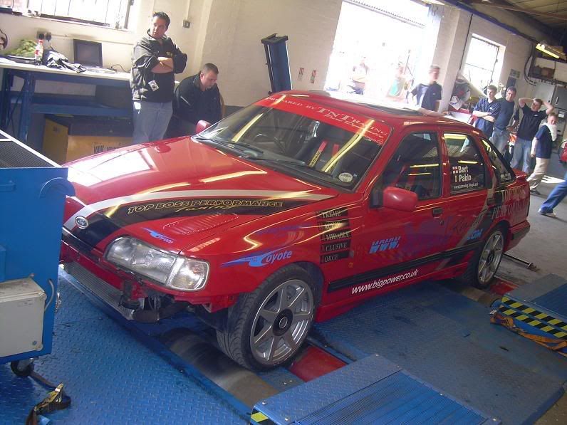

Here are some pics of the track car, Al's XR4i and sierra Gt
