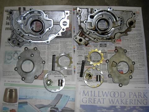

The rear of the pump
Oil pump
Flywheel showing no sign of drag launches
Crank pads not worn
Big ends showing wear
A worthwhile exercise then, should be rebuilding with Tomei bearings, Jun pump and drive, Tomei sump baffle or big capacity sump .
