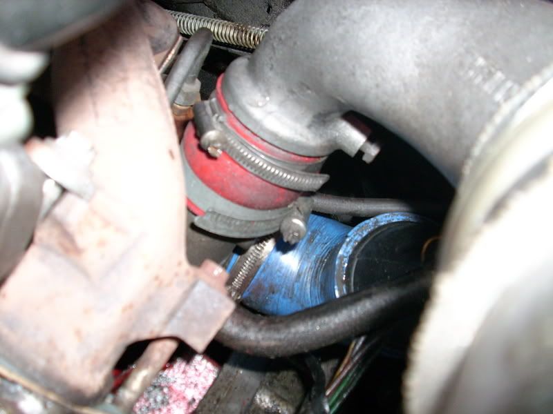

Something i remembered which may be of relevance -
A while ago i noticed a metallic like dust in my engine bay in the turbo area, originally there was quite a bit on the bulkhead and surrounding pipes.
You can see some on the red hose

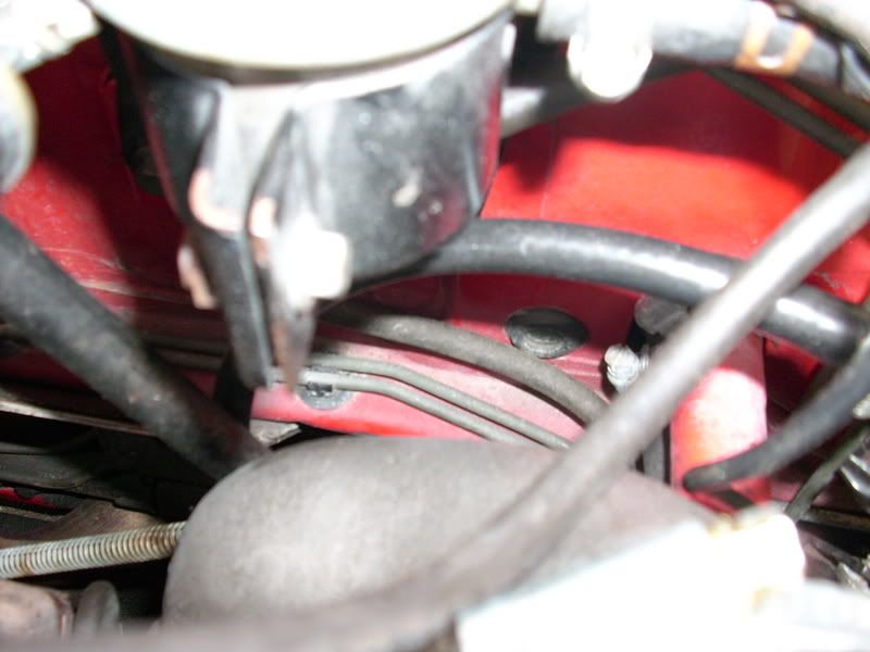

On this one you can see dust on the bulkhead where the brake pipes are, and also the heater hose.
At the time i couldnt figure out where it came from but its now just clicked - must have been the turbo to manifold gasket blowing out :roll:
