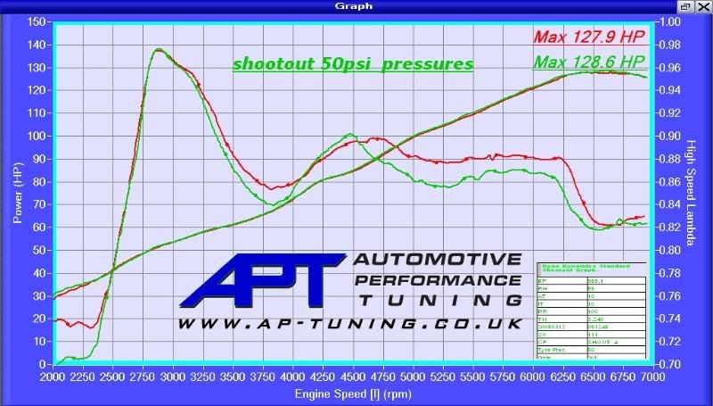

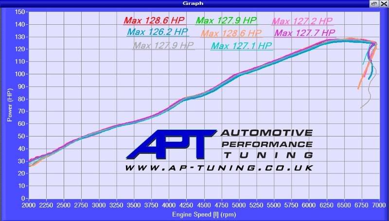

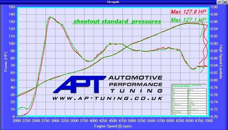

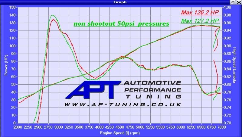

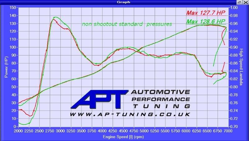

i dont normally get in to arguements with dynos as some other people always seem to have the answers so heres the test you asked for
i dont use 50psi in tyres unless i have probs with grip or its a big car or its a dyno day
i think graphs explain themselves,the lats one is all runs together so you can see bugger all difference!!
