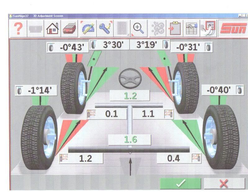

Hi, just got the new print outs scanned in.
The first one is the inital reading the second is after adjustment. The settings are Prodrive on the rear and Prodrive on the front with a bit of tyre wear compromise. The car feels so much better but still has a little more to give. Are the Prodrive settings bad for tyre wear? Let me know your comments.

Those settings wont wear your tyres much at all.
They seem to have evened them off well but still low on Negative Camber at the front for some reason - were they not able to get it more than that? 1-1 1/2 Degree at the front would have been nice and help reduce understeer even more.

dynamix wrote:Those settings wont wear your tyres much at all.
He was able to do more but he thought it would improve the handling but not wear tyres too quickly.
So a bit more camber at the front then?
JM
1 negative at the front would help remove/reduce understeer as you cant get much more than 3.5 degree caster.
It doesnt wear the tyres too much and will actually help save them when your car is on track (I presume it will be)

Ian from Autotest just rang me to see how i was getting on with the car, had a chat about the settings and what you guys have said and it is back in on Wednesday to stick some more camber on the front. :grin:
Has anyone got the prodrive settings so i can make a comparison on the figures i have?

Not for a classic I dont.
Mine (on a hawkeye) are:
Front:
Camber: -2.5 Deg
Caster: 5.5 Deg
Toe: marginal Toe Out
Rear:
Camber: -1 Deg

JM - I've used 1.5deg camber all-round on my classic for the last year, with a bit more dialled in for trackdays on adjustable topmounts. Tyres are down to 3mm now but an inch on the front inside shoulders is bald. So, slightly uneven, with mostly road-use on that particular set of wheels.
I'd go for 1deg camber if the car is going to do road work predominantly, or 1.5+ for track work.
