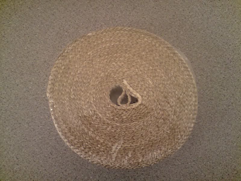

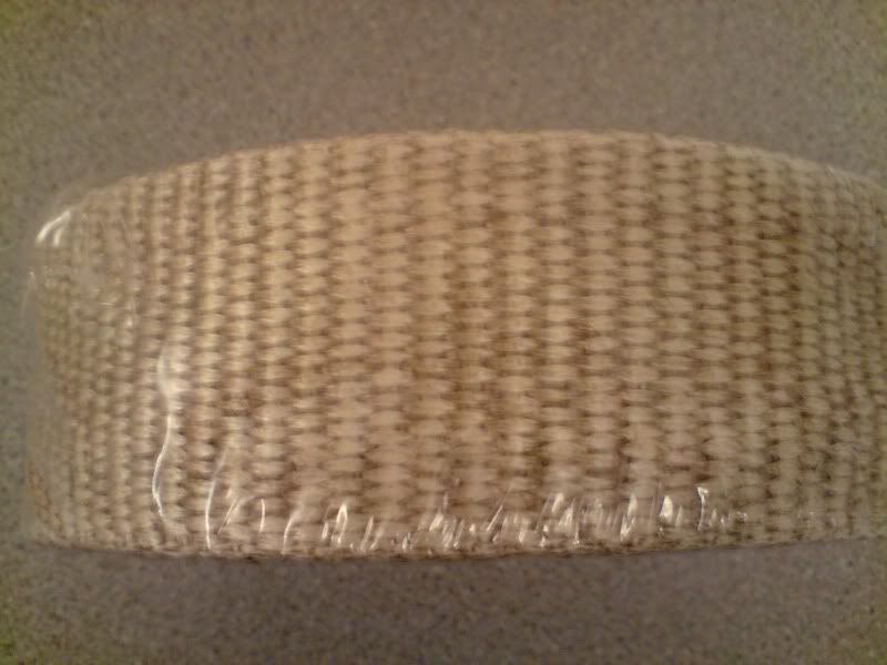

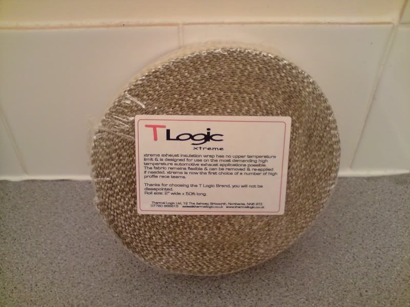

the pics you have put up and the link to Ebay i would guess that ZEN and RCM will have a major problem with as that looks like the cheap stuff and not the same at all like the stuff we generally use/supply which to my knowledge is the same a Paul and Olly.................

The rallydesign wrap looks good value if that's the stuff you've had good experience of ... about half the price of DEI.
