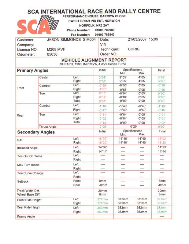

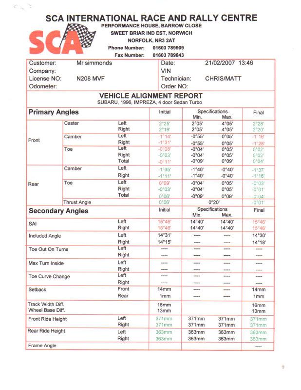

jazzymonkey
Posts: 294
Post by jazzymonkey »
dynamix wrote:What geometry settings did SCA use ? - they make a massive difference to the feel and performance of the car.
If they gave you a printout of the settings - can you scan and post it?
Just got the settings scanned in. The first one is standard suspension with lowering springs that were on the car when i got it. And the second is with all my suspension goodies fitted.
Looking forward to my visit to Autotest tomorrow!
JM
Let me know what you think, thanks.
