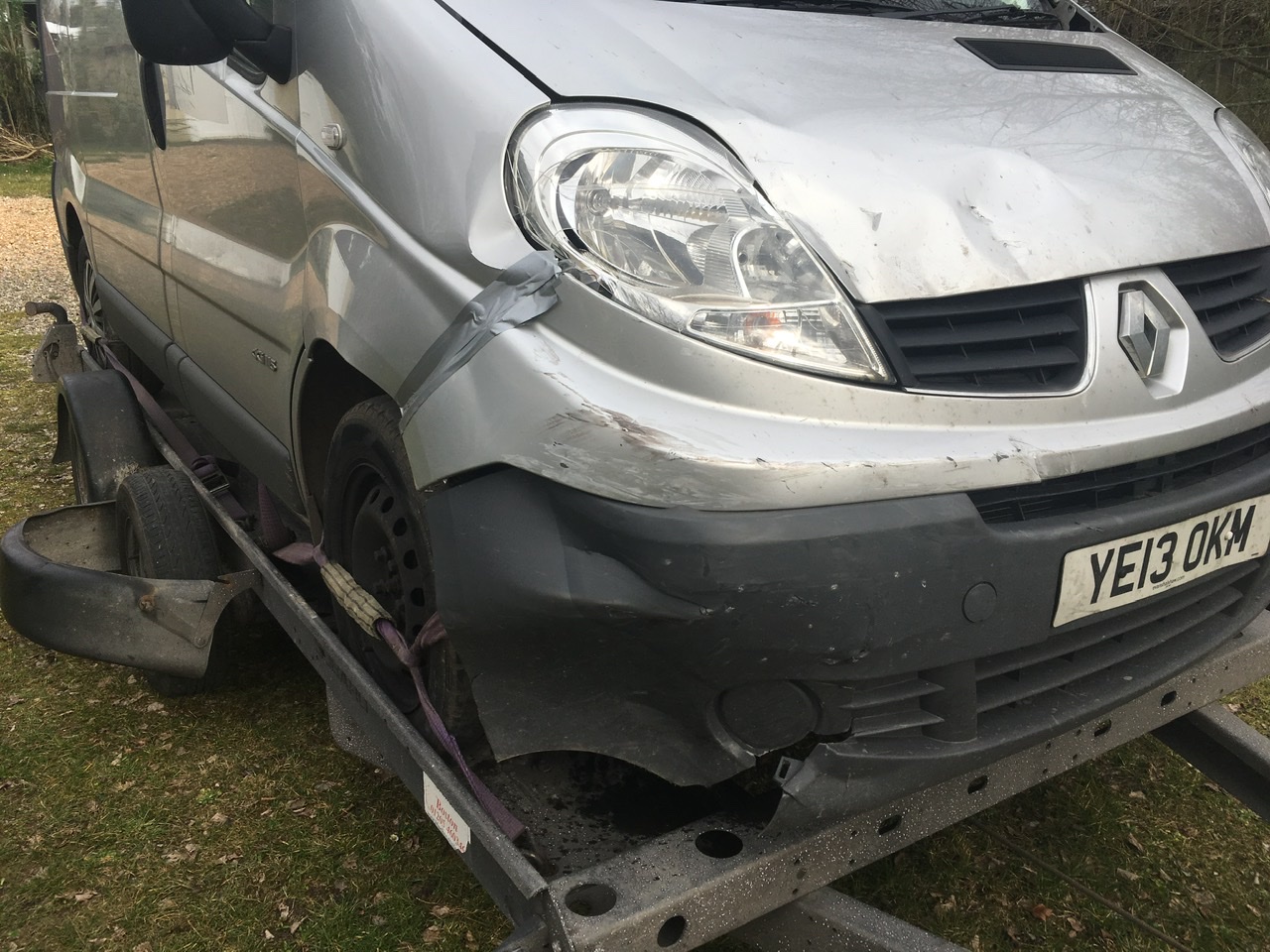

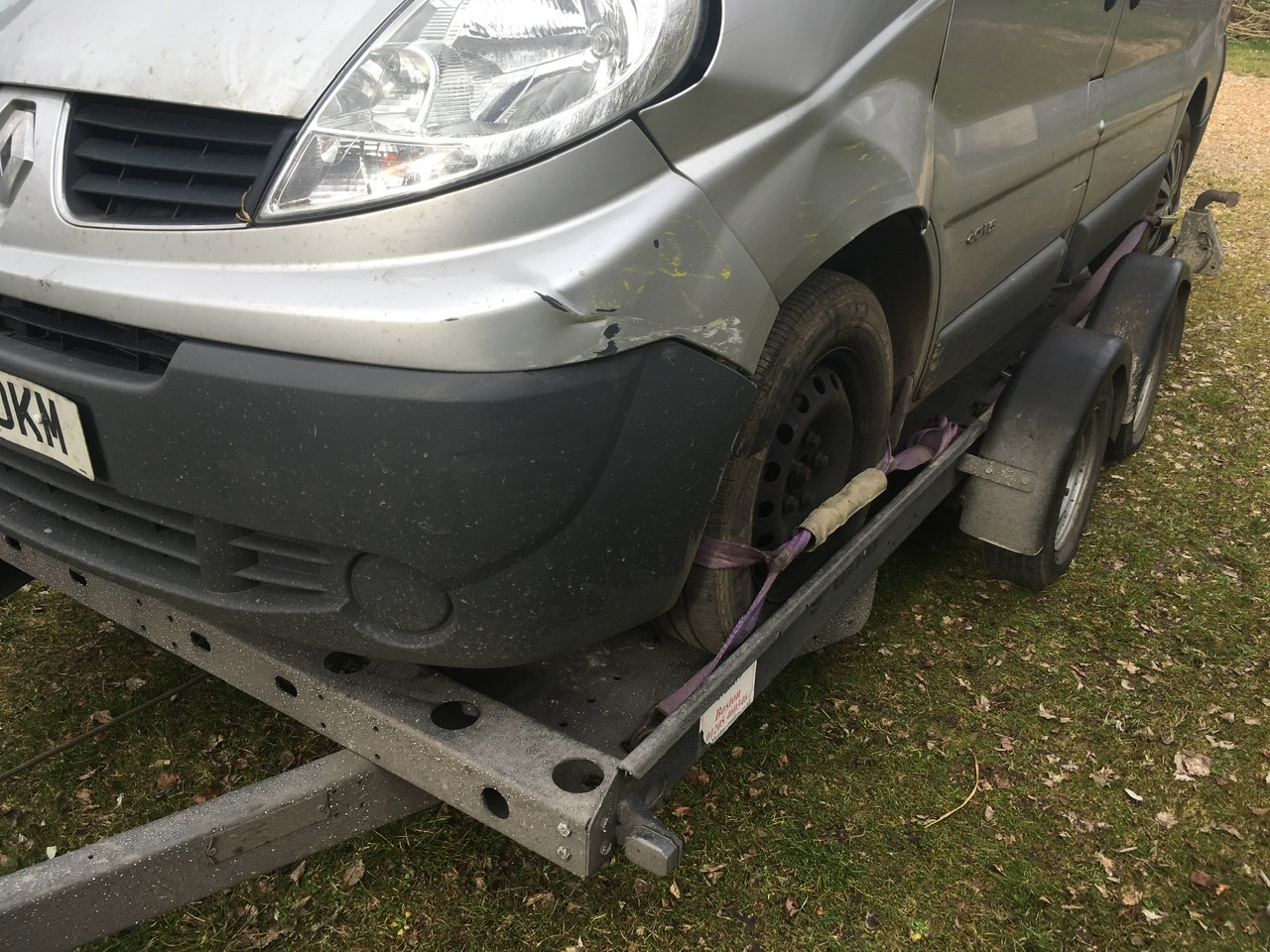

So after hunting around for quite a while I came across this one that was light cat N bolt on panel damaged and didn’t have the seat bolsters ripped and holed like so many I’d looked at, and I actually won it for a price that wasn’t knocking on the door of retail like most that I’d been trying to win - I know the commercial vehicle market is fierce, but oh boy it was an eye opener! :eek:
This is as I collected it, a totally bog standard SL27 van.

I throughly enjoyed spending time with him pulling it apart (sorry no photos taken of the rebuild as I didn’t think it would be going into a build thread) he talked about how cool it would be to build a day van and that sowed the seed and started another slippery slope :D

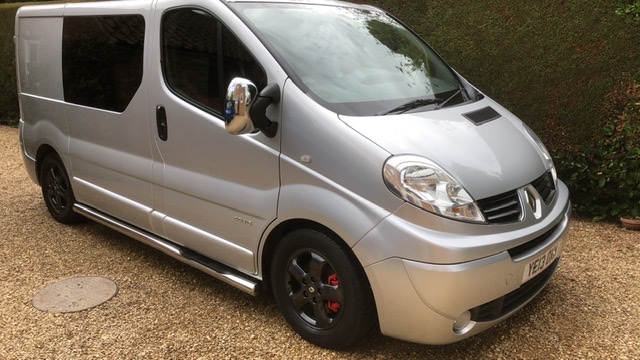

I bought two front wings, two headlights, bonnet, front panel and all the genuine sport colour coded body panels including the front bumper and all in silver so no painting- result!
The wheels are genuine sport ones that I refurbished in graphite grey.

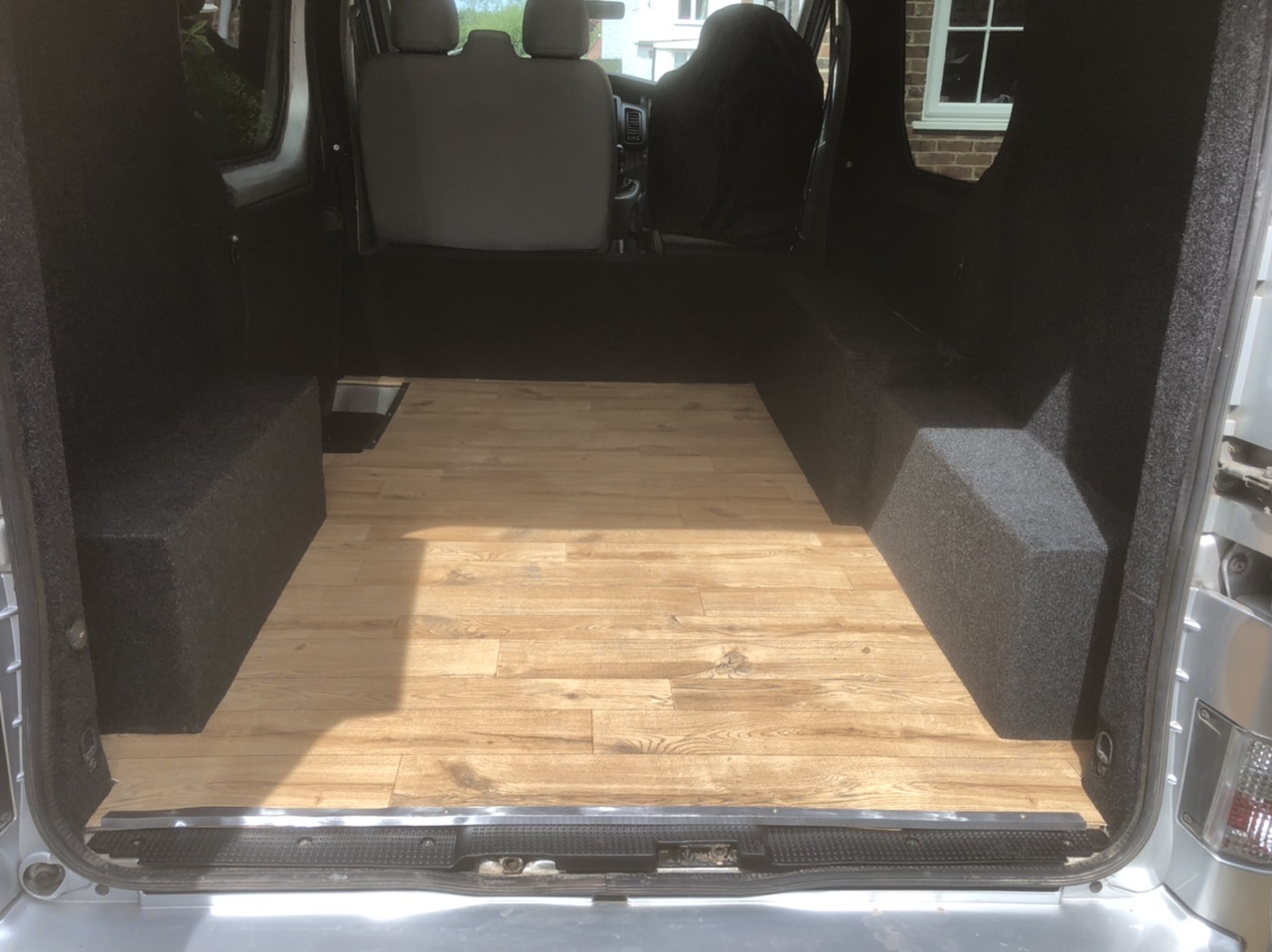

One of the best jobs I did was lining the entire van including all doors with dodo mat sound deadening. Anyone who’s been in a van with the bulk head removed will know what a booming, noisy things they normally are - not mine now. I’ve had comments that there must be voodoo as a van shouldn’t be that quite!

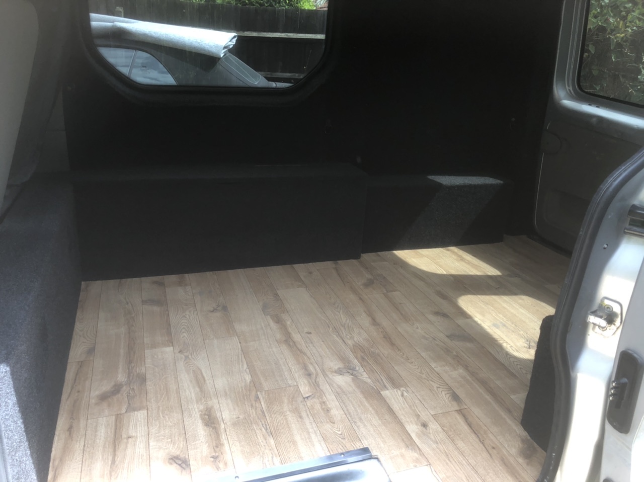

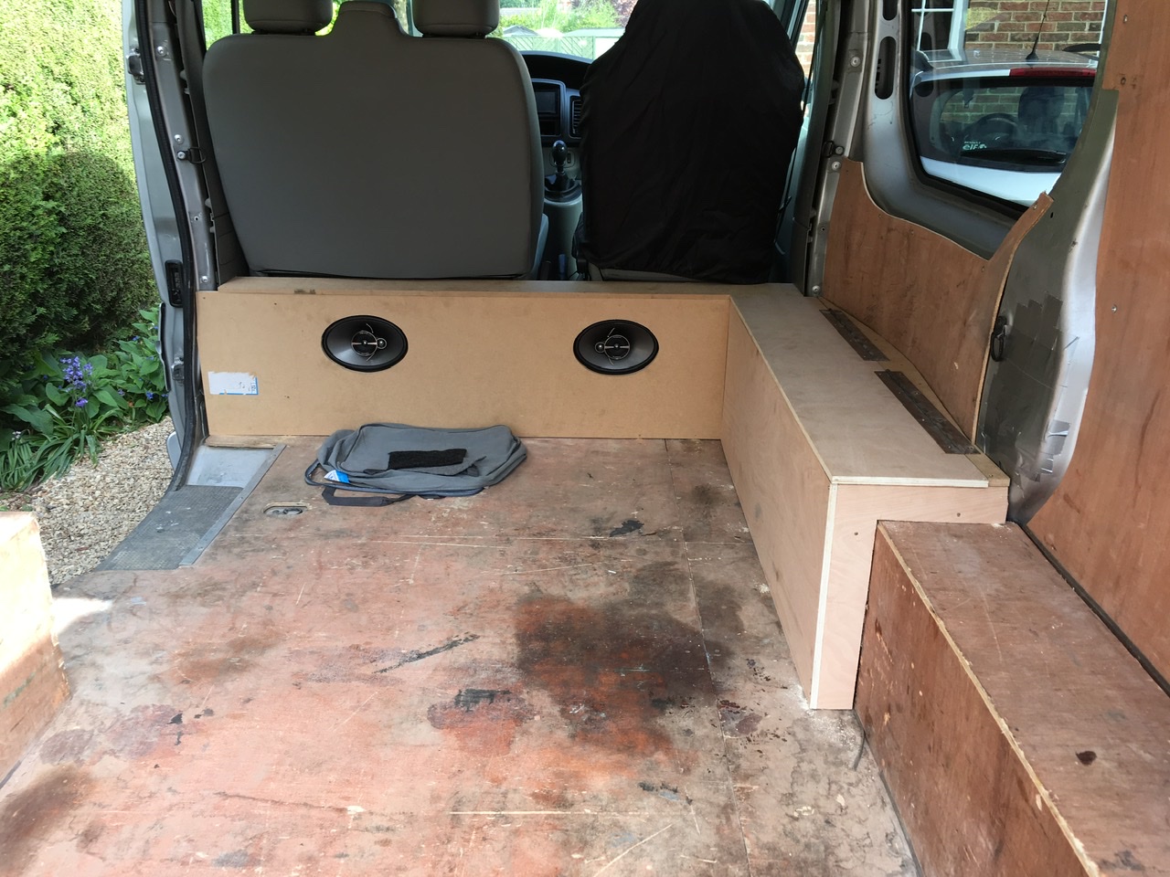

We also set about building some storage boxes with hinged top and fitting some 6x9’s in the rear. We then cut out the holes for the side and rear windows and bonded them in. We then carpeted all the rear including the roof lining in four way stretch carpet, although I’ve still go the rear doors to do.

So far it’s had the full sport colour coded kit added and sport wheels - although I do now want to fit some 18” wheels as they look too small.

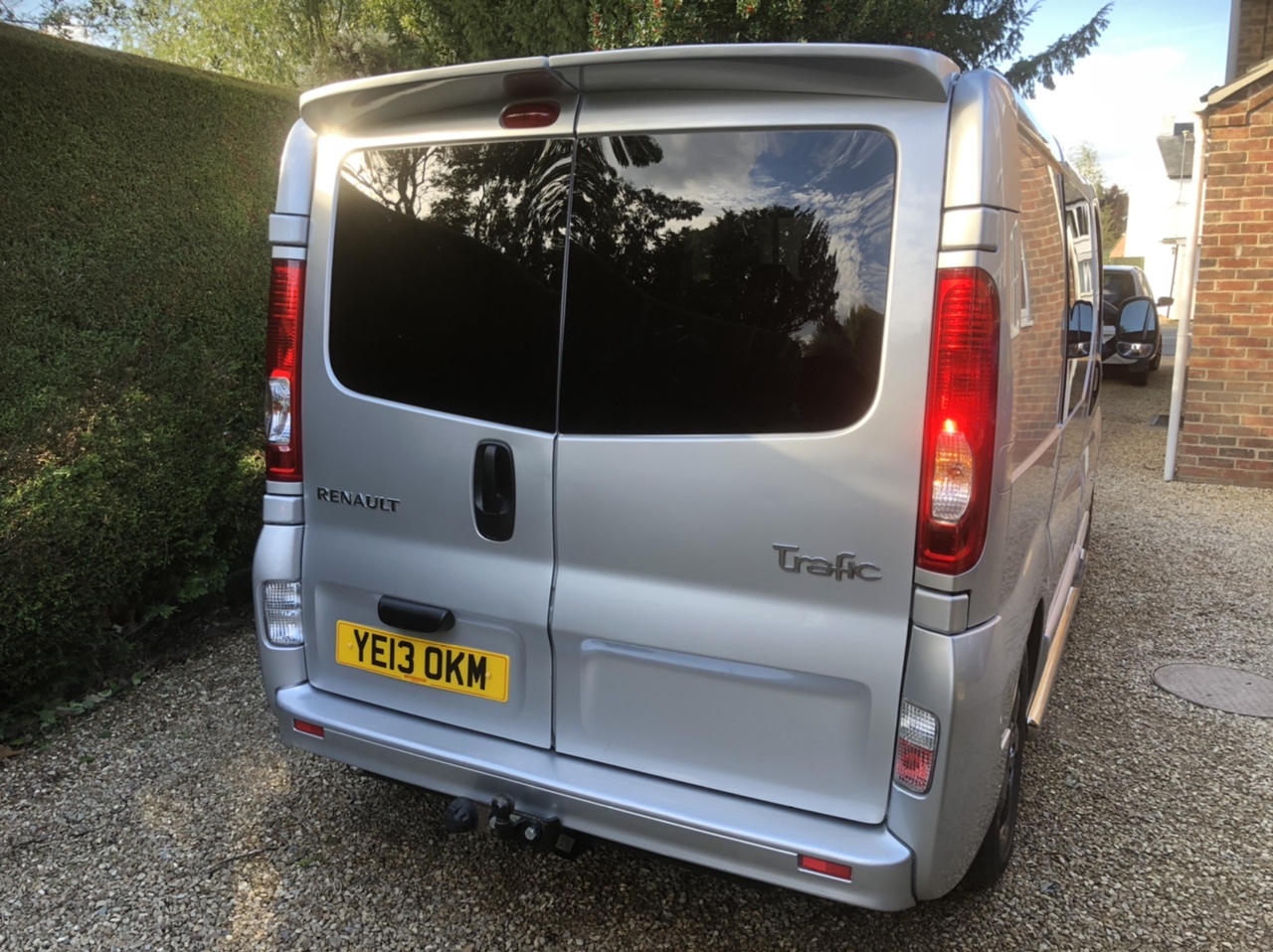

A rear spoilers been fitted along with chrome side steps and wing mirror covers.
Side and rear windows fitted.
Lowering springs fitted (I can’t remember if they are -35 or 40mm?)

Fully sound deadened and carpeted with extra rear lighting and power outlet. I do want to make a drop down table too.

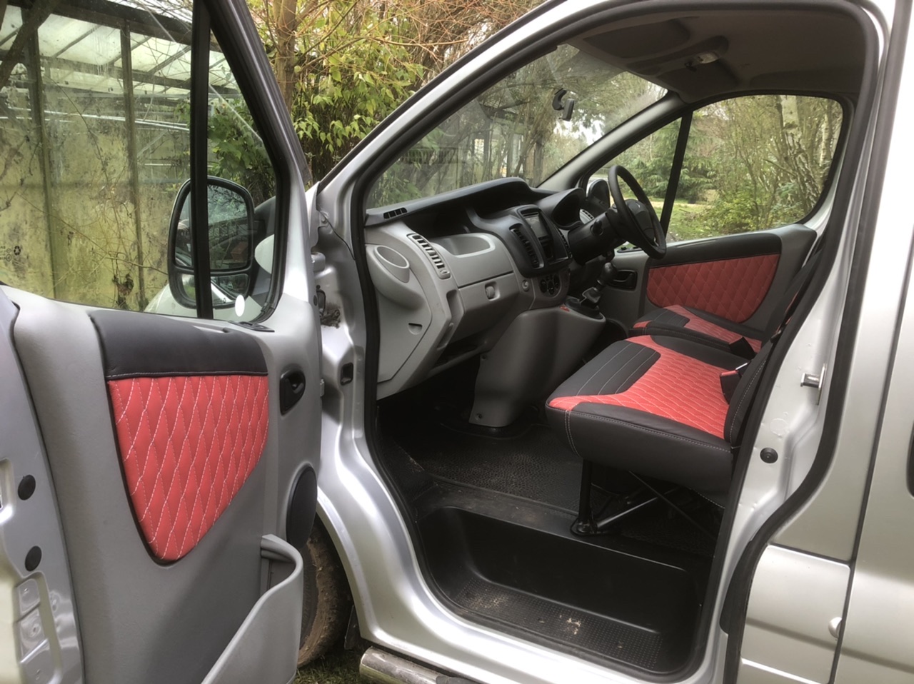

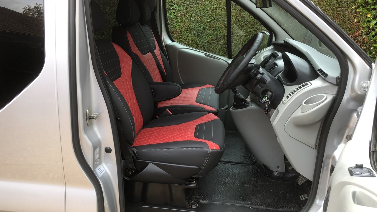

Full leather one off custom re-trim (the pictures make the red much brighter than it is) mostly cut out by myself but expertly stitched by my good buddy lee at Enigma interiors. I would give his business a plug here but I know he’s stacked out with waiting lists running off for months.
