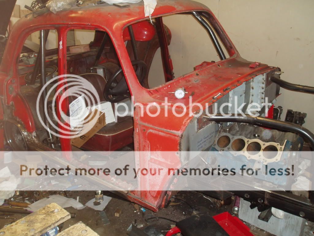

this is a 1960 ford prefect , proper old school , it was going to be a drag race with a 6 litre v8 but i changed my mind and iam going with a lighter rover v8 and 5 speed manual . I stuck with the hefty box section chassis and ford 9 inch axle but changed the old Cortina wish bone front suspension to the mk1 Escort struts with coilovers . Iam doing the pedals at the moment so i can work out where the clutch and brake master cylinders go.Yes i know my garage is a shithole , cleaning it up is my next project. Pete:Chevy_anim:
