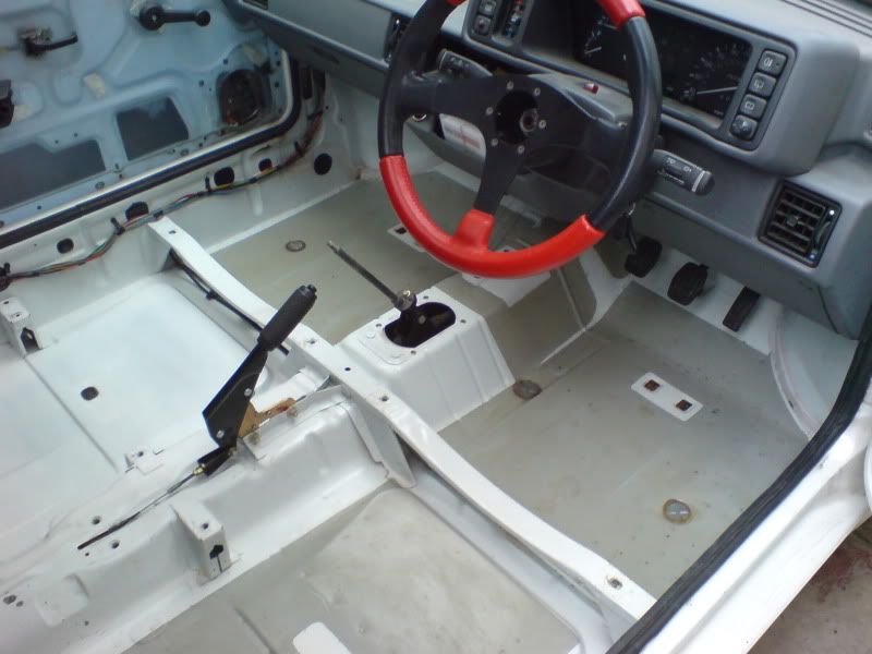

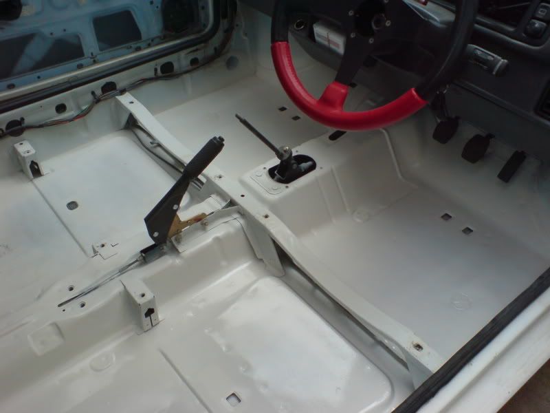

i thought i would save a few kg's. I have stripped out door cards, trim, carpets and sound deadening.
The floor is very sound for a 17 year old Metro.
Cleaned up just the areas of the floor where the sound deadening was and painted. No point in adding paint for the sake of it.

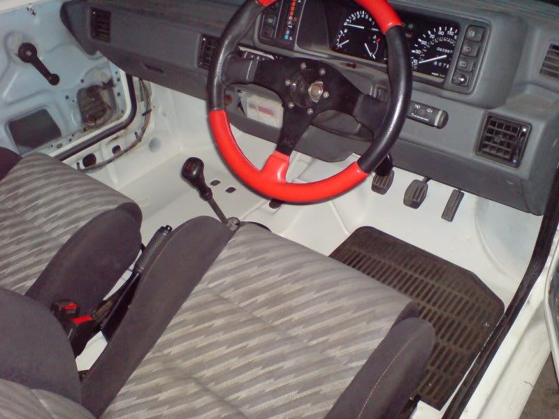

Original seats back in as they are mega comfortable (reputed to be made by Recaro) and not that heavy. I also need to keep these as they are adjustable as i sometimes have to move the passenger one forward or recline to get stuff in.
I think i may have saved around 50kg including losing the rear seats/belts so should be under 800kg.
