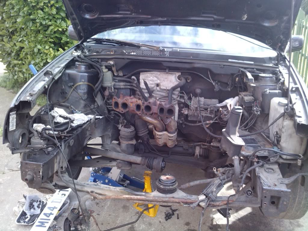

Well here goes chaps and chapesses, a little project a mate and myself have been working on. Having decided that i really enjoy doing track days i decided that it would be best to dedicate my car to it, but thought it was worth too much so a friend and my self went halfs on a golf vr6 :D . Though when i went to look at it the engine had a bad knock to it :( though the body work was good and a few nice parts on it we decided to take a chance.
When we got it back we had a good look round and found it had coilovers, poly bushed wishbones, remus catback exhaust, 2.9 inlet manifold and throttle body been told its been chipped but no proof, and i believe the rear arm my be poly bushed aswell, but as for the engine we hoped it was the head/lifters that were faulty but after giving it a service and changing them it didnt help so i droped the sump and oil pump and started checking the shells only to find it had spun one :? having priced up the cost of repairing it we decided to replace the engine. So with a hunt round (good ole ebay) we found one, I've changed the chain guides and checked the clutch, ive also striped out the inside of the car (which becomes addictive) its just waiting for a weekend to change the engines over. with any luck it will be at marham on the sunday :)

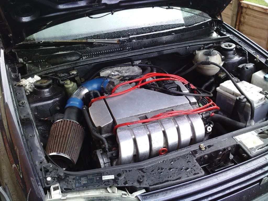

managed to resize the pic, yesterday ian came round and took the engine out and dropped the other one in, today I managed to wire up and plump in the new one, thankfully i had one to copy as ive never done this before and when you've got 2 of the same wire it doesnt help matters :? any way i turned the key and it fired up :D :D :D :D

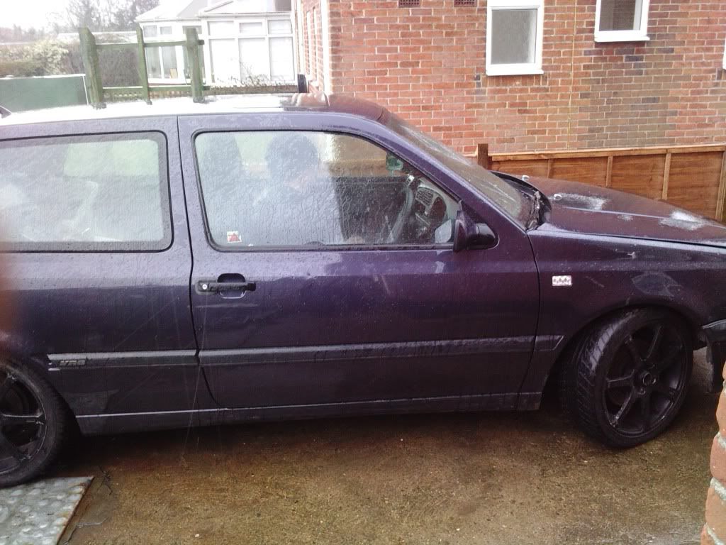

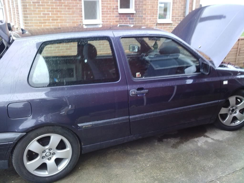

The old wheels were audi some things and didn't clear anything, no idea why they were on.
Bargin new 17's with ok tyres and a tart
And the new engine, which works!!! :-D :-D :-D
