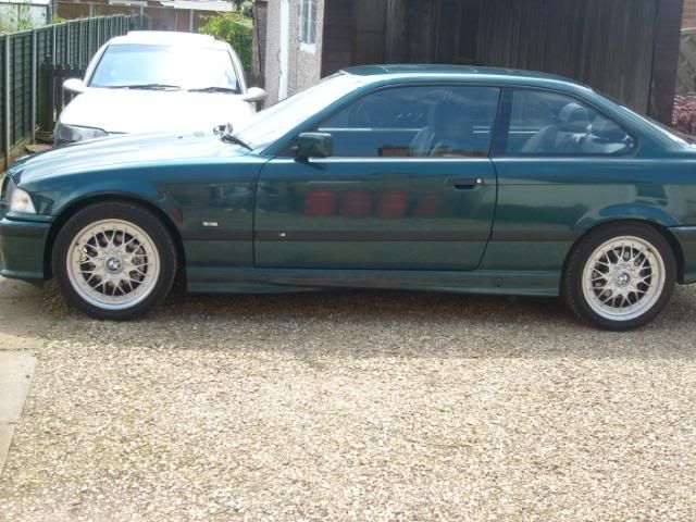

So a week and a half ago i brought a
1996 BMW 328i sport , 97,000 , full(ish) service history , not bad condition and e/w, e/s , c/l , metalic paint ,1/2 leather, air con .. . . etc
to be honest i knew nothing about these cars as will be shown later :roll:

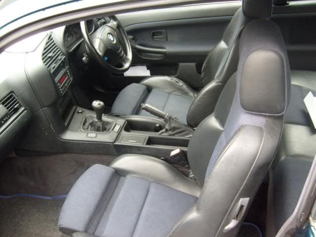

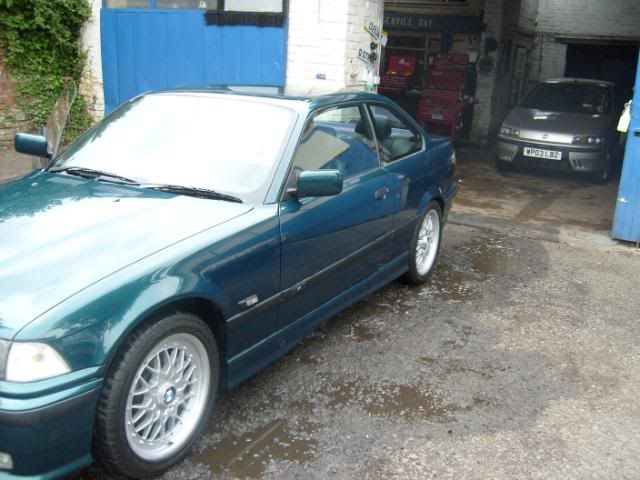

so here is a few pics of the day i brought it ,

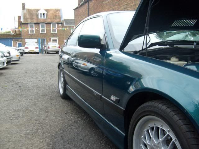

Right so the next day as you do gave it a good old clean and a polish i am not into the detailing thing so just a wash and some autoglym super resin polish for me .
and the somewhat disapointing result ,

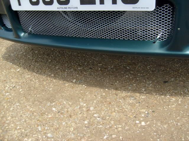

a picture of how some idiot has spray painted the grill on the car so they also got the fan aswell , what is rong witht the black grille :roll: idot ! so now i need to source a new one of those . #
GREAT

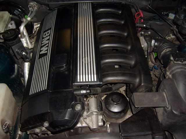

Hurd the niskali tale and what a tale and after some searching i found this ? :oops: :roll:
yup thats right i have the niskali engine .
At first i was gutted but just after much persuading thought well if it has done 97.000 and its still going it aint gonna give up the ghost now is it !

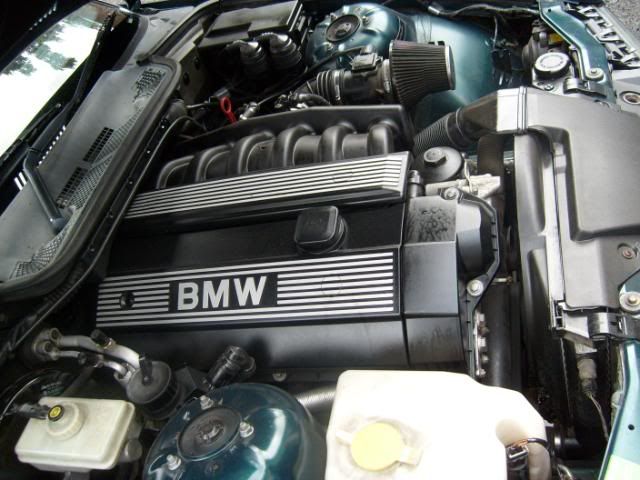

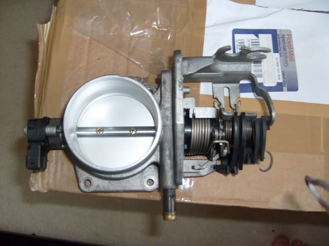

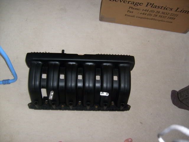

The plan witht the car is to make it look standard is but make it go like stink so out came the mobile and a short call later this arrived in the post thanks to alpina57...

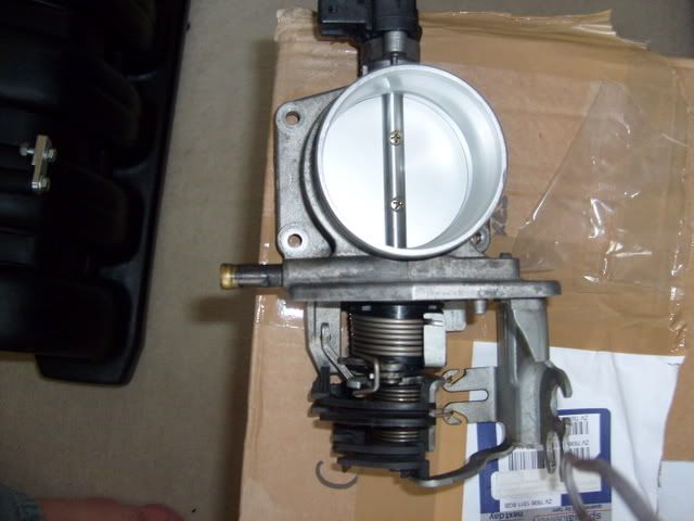

big throtel body manifold conversion righness , so thats i a box waited to be fitted in the next few days i hope when i get around to it ,

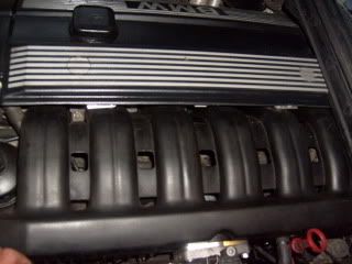

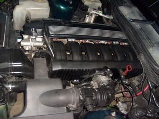

Right hello again all , thought i would come and give y ou a few updates about what has been happening over the last few days , so here goes . . .
Well i had the manifiold and bbtb to fit (aplina..kit) so i thought after putting it of with fear of not being able to do it i would get around to it , it was not acctually that bad tbh , the instructions were very clear but i could not have done it without the support of IAN on the telephone , unlike most (if not all ) other who have fitted this kit rather than just fir the manifold and leave the fact that the injector cover does not fit around the manifold (which imo looks crappy) or some people dremel the slots out to make it fit !..
I tried this but i found i could not get a decent cut out i could get it to fit ok but getting it to look "FACTORY" was difficult so after an hour or so of trying i decided to just cut the whole lot off and make a straig edge along the recess that is already in the injector cover looks alot better and more factory i think see for your seves here is the finished article with the bbtb and manifold fitted.
Opinions welcome ?.

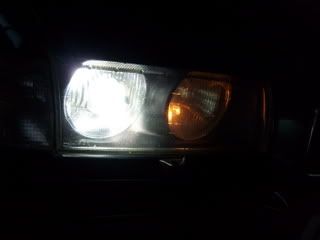

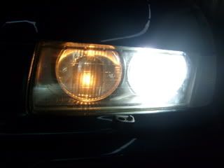

I sourced a set of chromline desighns HID's fitted them with very little effort and they look like this
i know they look crap agianst the yellow side lights so back on the phone i got to ben and ordered a set of gen 5 angel eyes which will be fitted on sundsay with delensed headlights !!! which should make it look alot better indeed . will update soon

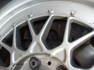

- E36 M3 brakes 315mm x 28mm, discs and calipers , with new discs !
- Uprated brake fluid when i order it !! need to get on that .- braided lines

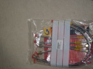

BRAKES
- braided lines brakes

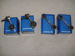

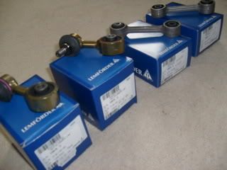

new drop links ready to be fitted

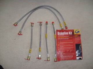

Braided lines

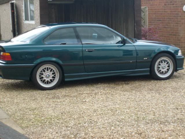

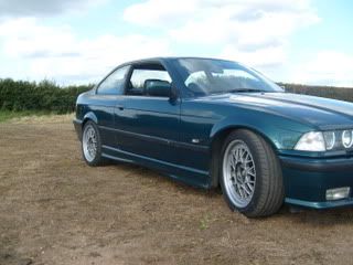

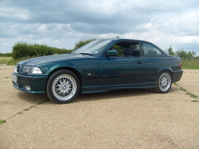

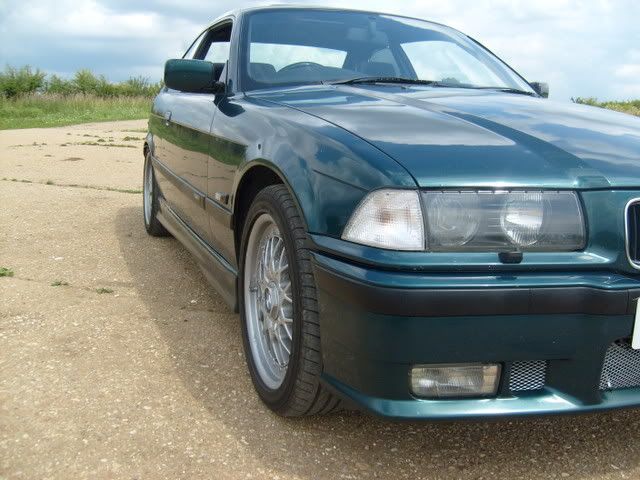

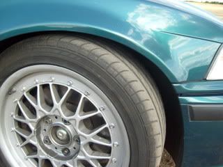

Some pictures of the car all lowered
A little lower than i expected it to be
Here are some very bad ish pictures of the new brakes , i will get better pictures soon
The brakes are amazing and with the new fluid and the uprated (braided)lines they are amazing i really like them they were a weak point of the car before but now all sorted
Sadlly i dont have any pictures of the polly bushes but i am sure you know what they look like lol a full set was ordered and fitted including the off set lolipop bushes with the new E30 wishbones .

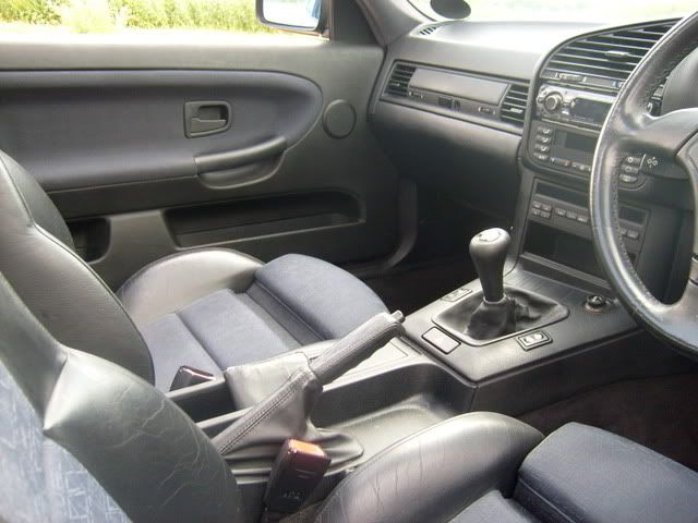

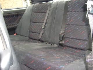

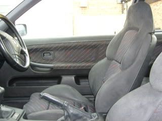

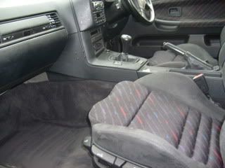

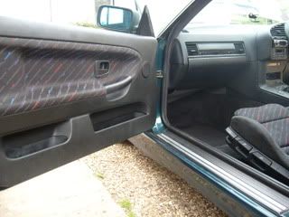

Now the interior Picked this up yesterday
and here it is fitted - with the whole car hovered (inside obviouslly) lol
All in all i am very happy with the way the car handels , i have had the tracking done 4 wheel laser alighned and am running -2.5 degree camber on the front and -2 degree camber on the rear with o toe on the front and 0.20 toe on the rear and it handels really well
The only thing i will say is with the polly bushs fitted the road noise is greatlly increased but hey i can live with that ,
The cg locks are brilliant and a real asset for anyone wanting to get the most from there car imo
And finally the interior is very clean and feels great will be better for track days as it is not leather like my old one , which is why i brought it .

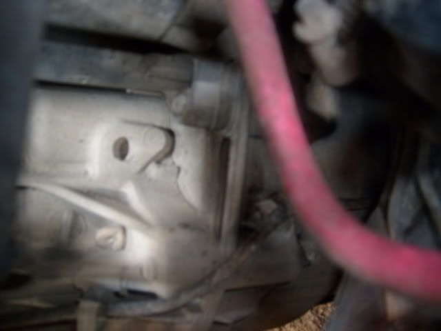

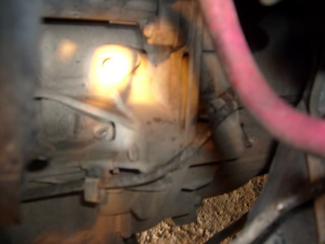

Few people been asking me about the clutch delay valve modification via pm and how to do it so i thought i would put up a guide to use .
I've read a lot about the removal of the "CDV" and why it is nasty - it deliberately slows the release of the clutch.
This gives a smoother "bite" and makes us all a better changer! I've managed without one for years on many cars, and don't need any help thankyou BMW!!
It allows / causes slipping of the clutch slightly on every gear change - at the expense of all that extra clutch wear adding up over time!
Anyways this is what I did - Job time 30min...
Verdict - clutch bite feels the same, but the revs don't hang around mid shift / no clutch slip (probably not noticeable on the smaller engine / less torque models), and if you want to change very quickly, you can! - do it!

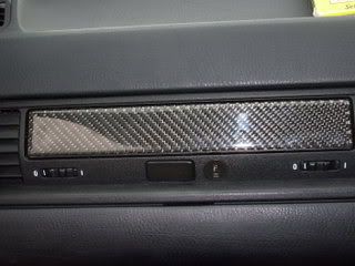

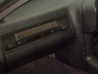

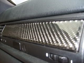

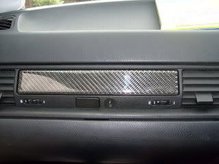

time for another update , Brought and fitted a carbon glove box trim looks good i think ?
Could this be the start of a carbon obsession ??? lool
Pic enjoy :D
COMENTS GUYS PLEASE

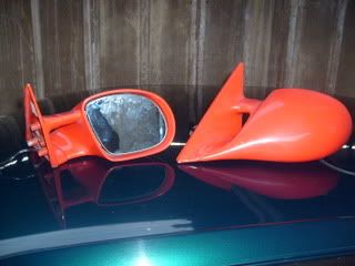

It'll look gay with M3 mirrors on. Be proud of owning a 328, they are good cars and do need to be defaced by pretending to look "M3" from a distance.
360 Gamertag TheTrash
Exactly why my M3 mirrors were never fitted as the shell is not an M one, even though there is no difference.
