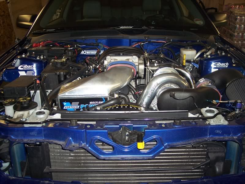

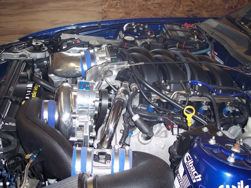

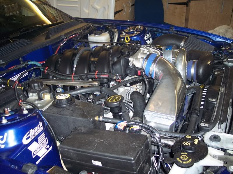

Managed to get away from the burger van for a while today (with permission) to see if I could track down what had happened to the stang, so I started by taking a few photos of the engine as I didn't know how far I would have to strip the engine down and wanted to record the "quest"
I jacked up the car and put it on axle stands and first of all took off the bonnet to get a clear view and easy access

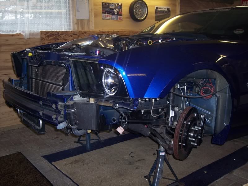

Then I took some bodywork off so I could get all round

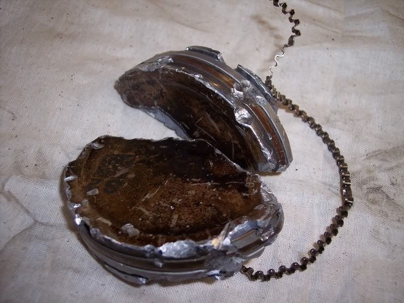

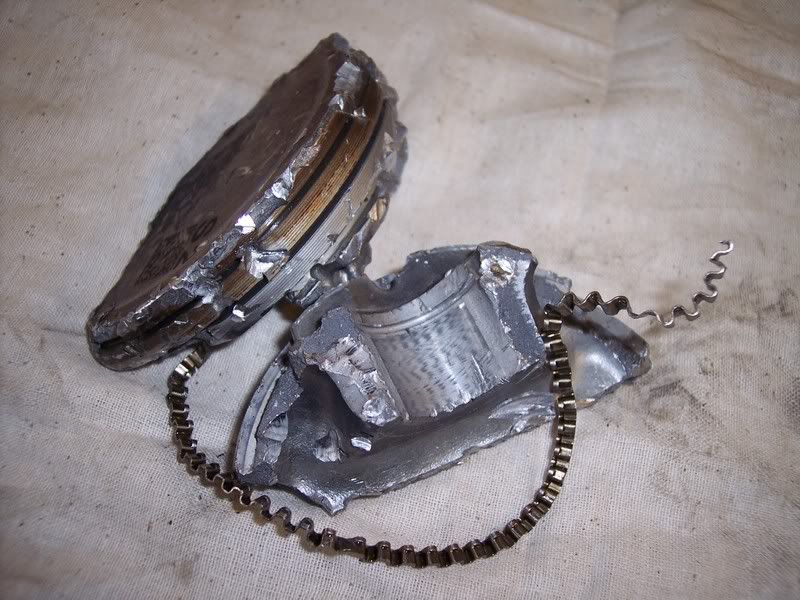

I then drained the oil to see if I could find any metal fragments, I poured it through a strainer but to my amazement there was no evidence of anything. I thought I might be lucky and maybe it would be alright so on to the sump. I loosened the sump but after an hour referred to the manual and found out that you cant get the sump off without lifting the engine.
I had a good look and the sump dropped down just enough for me to get my hand in almost to the bottom so I squeezed my hand in as far as I could and felt something.............
So I think I may have a clue as to what has happened, next job when I get a chance will be to lift the engine out and maybe strip it down to establish how much damage has been done :roll:

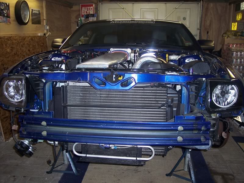

With the front bumper off it bears an uncanny resemblance to the Terminator
I think that may need more than Alraldite mate.........
