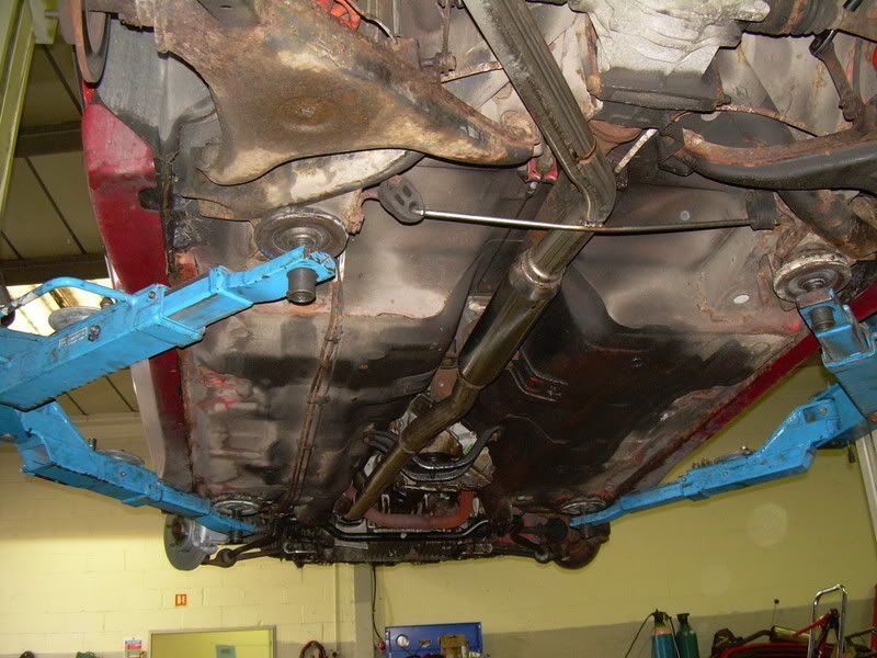

car up in the air minus the bumper and wheels aslo took another pic of the exhaust

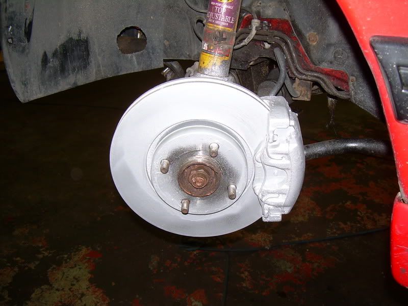

the aim for today was to fit the front and rear brakes from a scorpio cosworth
but only got the fronts done because they discovered a problem with the rear brakes
they were not actually working :o so the last 2 track days we done we were only braking on the fronts :grin:
after fitting the fronts fitz went a bit mental with the spray paint :-D
so after sorting the back brakes out the car stops very hard now
