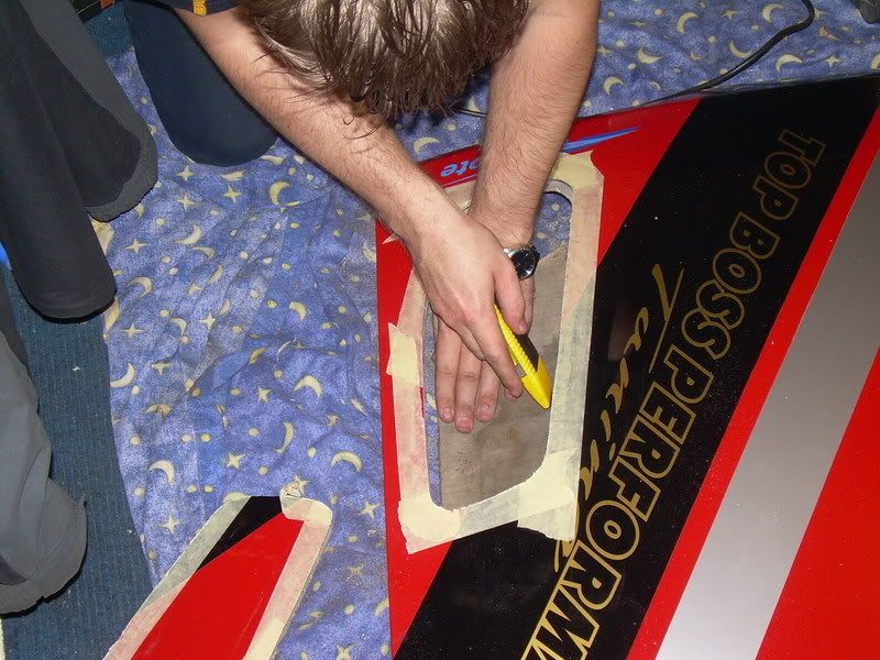

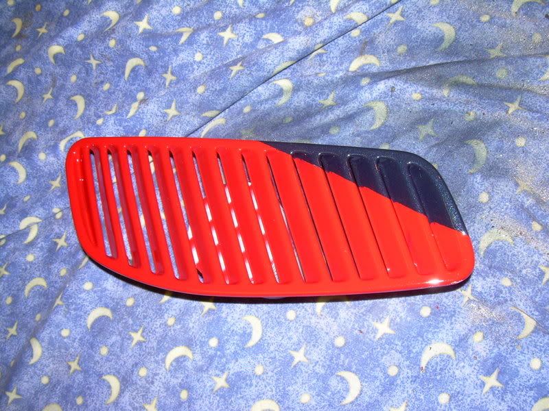

so he came round after work and started the cutting after pre-painting the grill and we took the bonnet off the car
bonnet in my kitchen intact

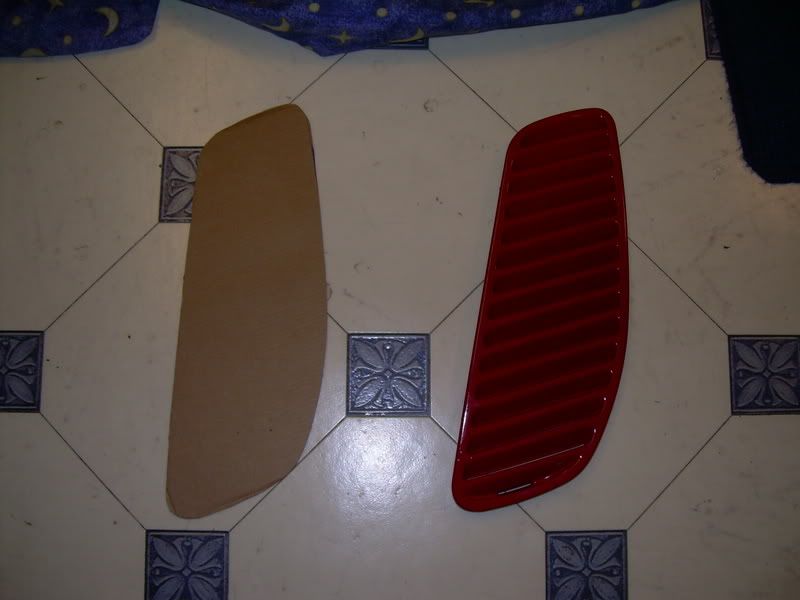

pre-painted grill and template

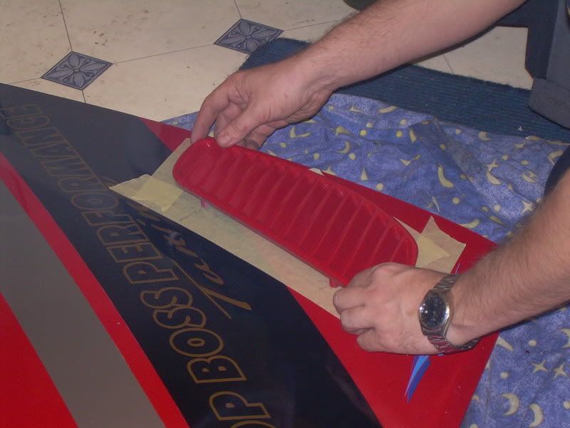

bart masking were the grill is to be fitted
drilling holes to fit the jigsaw through
cutting the insulation away (could not watch him using the jigsaw,cutting the bonnet)
sprayed the corner of the grill to follow the line of the graphics and lacquered

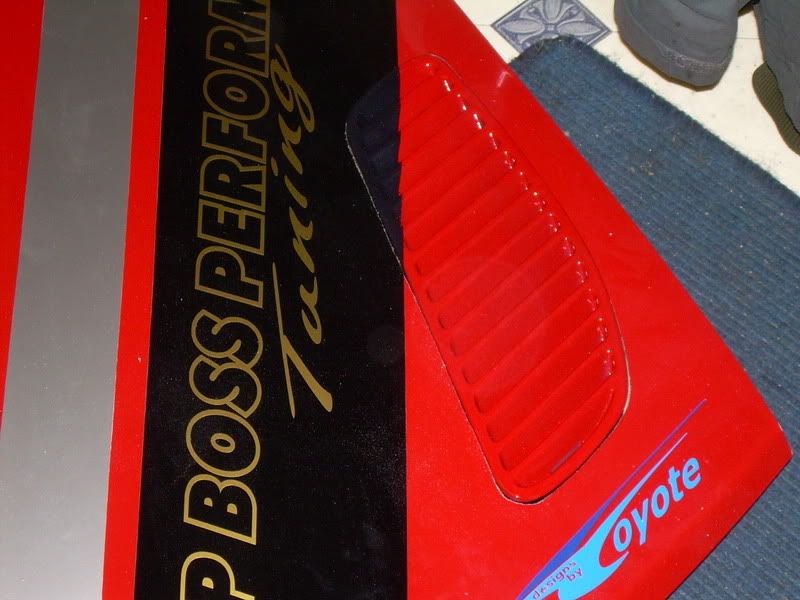

once dried put it into place seeing the end result

Looks an absolutely fantastic job done there :D
Thing that confuses me is that those vents will draw air out of the engine bay wont they?
Great job there chaps !!
Real attention to detail spraying the corner.
Have to agree with Dunc, they will draw air rather than feeding it in.
Good job though !!
The vent sits directly over the air filter which is not of the cone type as you cannot get them for the 2.8.. The hope is that the force of the suction will draw some air in. As our car does not have an ecu sucking in too much extra air could actually result in our air/fuel mixture becoming too weak on boost.
Plus we do need to get heat out of the engine bay, so i am hoping to get dual benefit from where we have sited it :)
Nothing ventured...Nothing gained :grin:
Great effort guys. Nice to see the slim shady workshop is still being used :D
I am sure a cooler engine will be a happier and safer engine. Interesting to see the results next week. Nice paint work again too.
