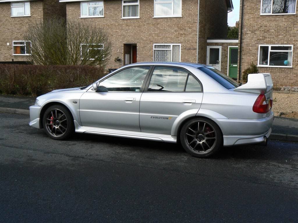

Finally pulled my finger out and got a photobucket login setup etc.
Just fitted the new wheels last week, here are a couple of pictures
Cheers,
Gareth.
Looks really lush Gareth :thumb:
Very very nice! ....

Love the wheels Gareth

Was well worth sticking with it after all the hassle and bad luck mate, looks absolutely stunning!!!! :o 8)
