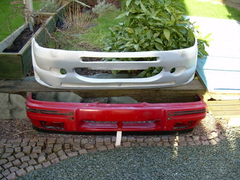

started off with a standard xr4x4 bumper and a wrc escort cossy that got off ebay for 99p, BONUS :lol:
this is how far i have got today

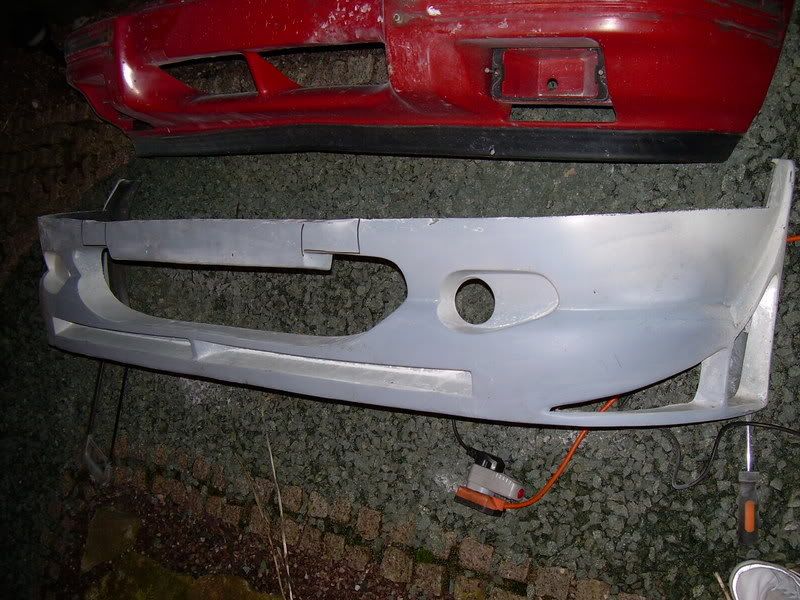

2 intact bumpers

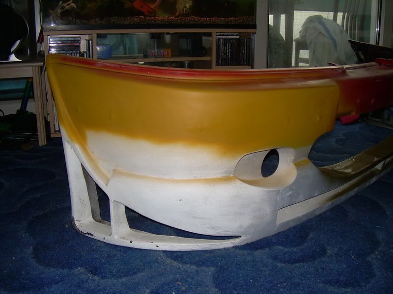

cut top off cossy bumper
check the fit to 4b bumper
cut the bottom half of the 4b bumper off and married up to the cossy and screwed together.

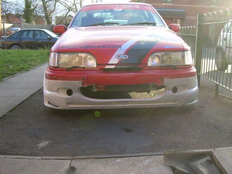

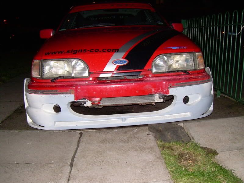

next put it on the car just to see how it might look.
next stage is marry the corners up flush then to potrivit all together, get the filler out and smooth over were the joins are.

Your aptitude for taking an angle gringer to things and getting away with it is superb :thumb: That last pic..............it may be a bit too low mate, it's touching the concrete :lol:
thats the way pablo's drive is. it has a lip at the end but it is 1 inch shorter than the current one so that we can get it on and off his drive :lol:
i love power tools but for some reason pablo dont like me using them when im round his house he some times get electricuted :-D

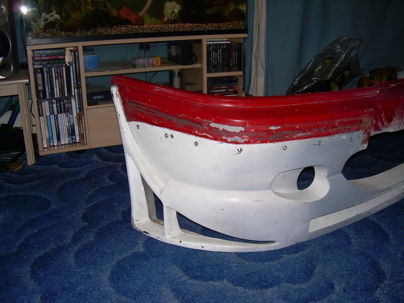

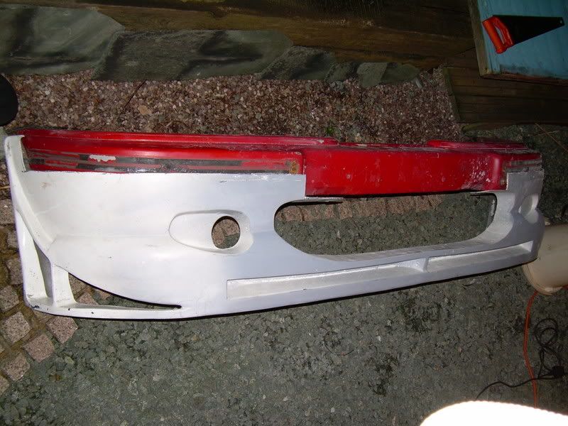

right after another busy day, done some more on the bumper not as much as id like because had to fit the exhaust back onto the track car. so this is what i have got done,

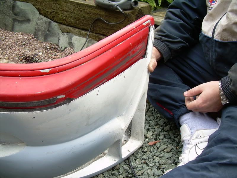

one corner of the bumper.
after some cutting got them lined up,

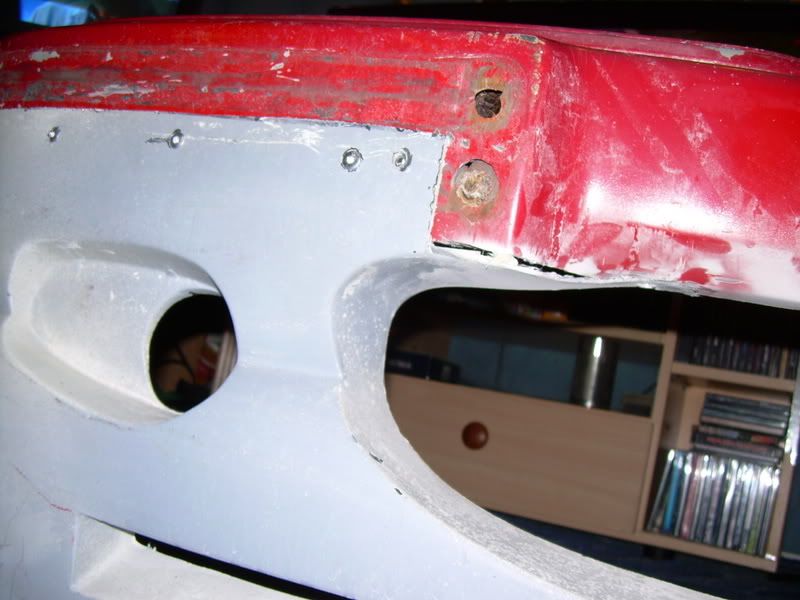

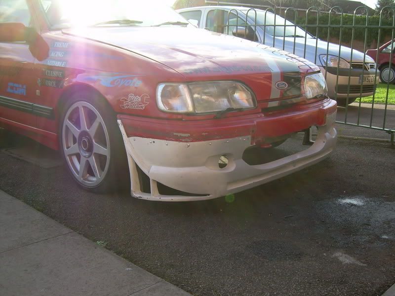

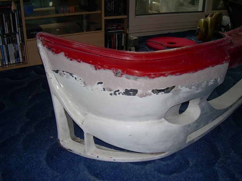

potrivited the two bumpers together and put it on the car again

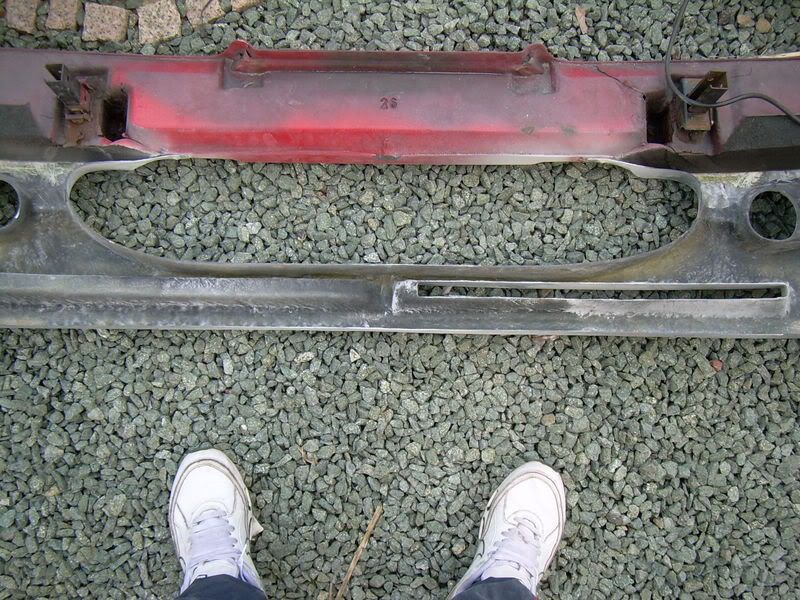

ground out the bottom vents to allow better air flow and less resistance
now its all together next stage will be to fill in the joins and get it smothed off ready for priming :D

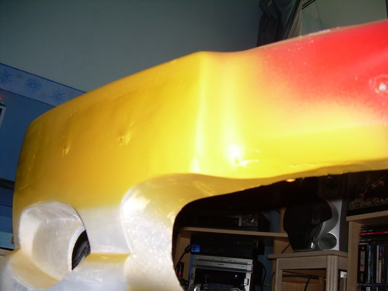

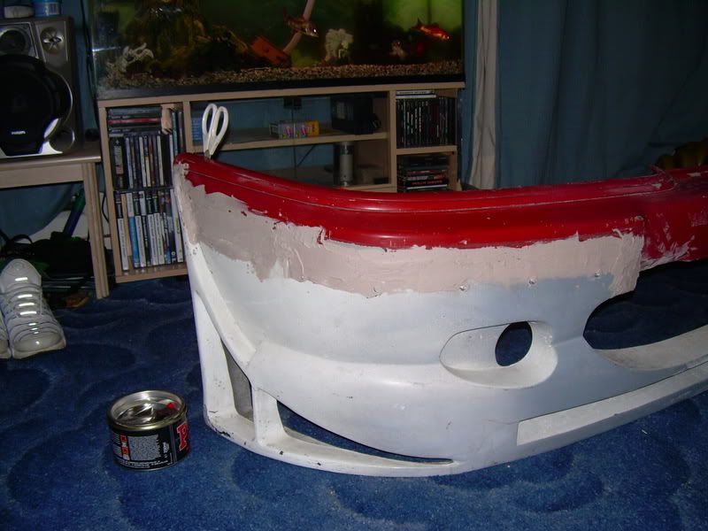

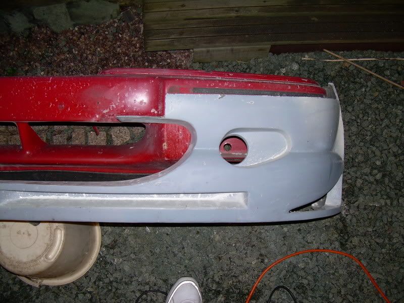

another week of some work on the bumper and its not coming out to badl so far
corner before the filler goes on and at the front
slap the filler on and smoothed it down

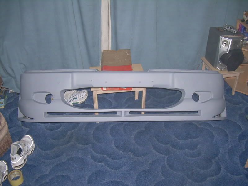

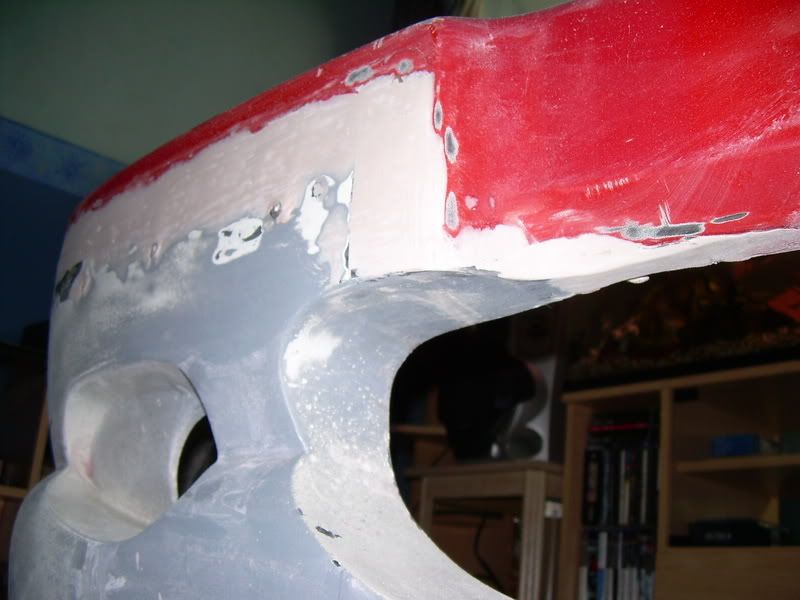

sprayed on some filler primer to find any imperfections

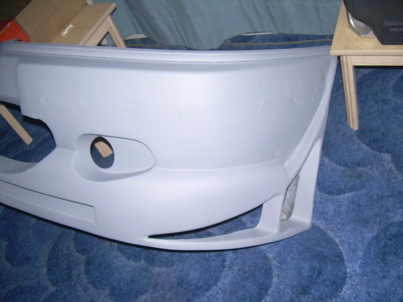

gave the bumper a rub down and sorted the little nicks out and then primed the bumper
my lovely fish were keeping a eye on me to make sure was doing it properly :lol:
