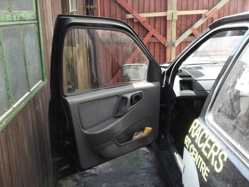

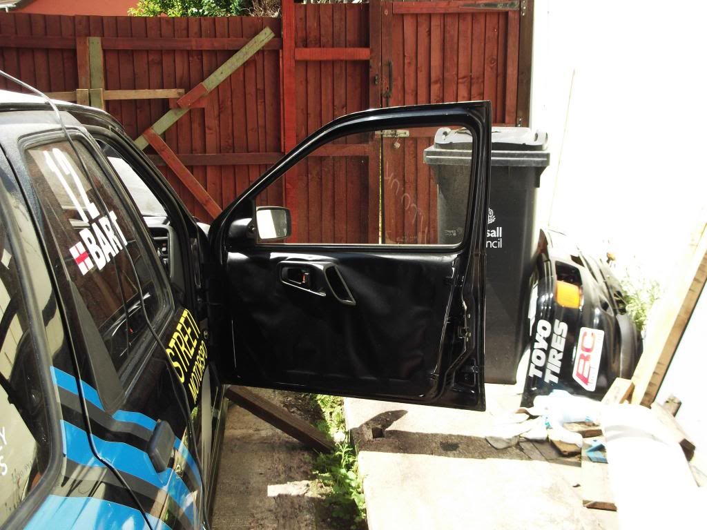

Original door card
New door cards

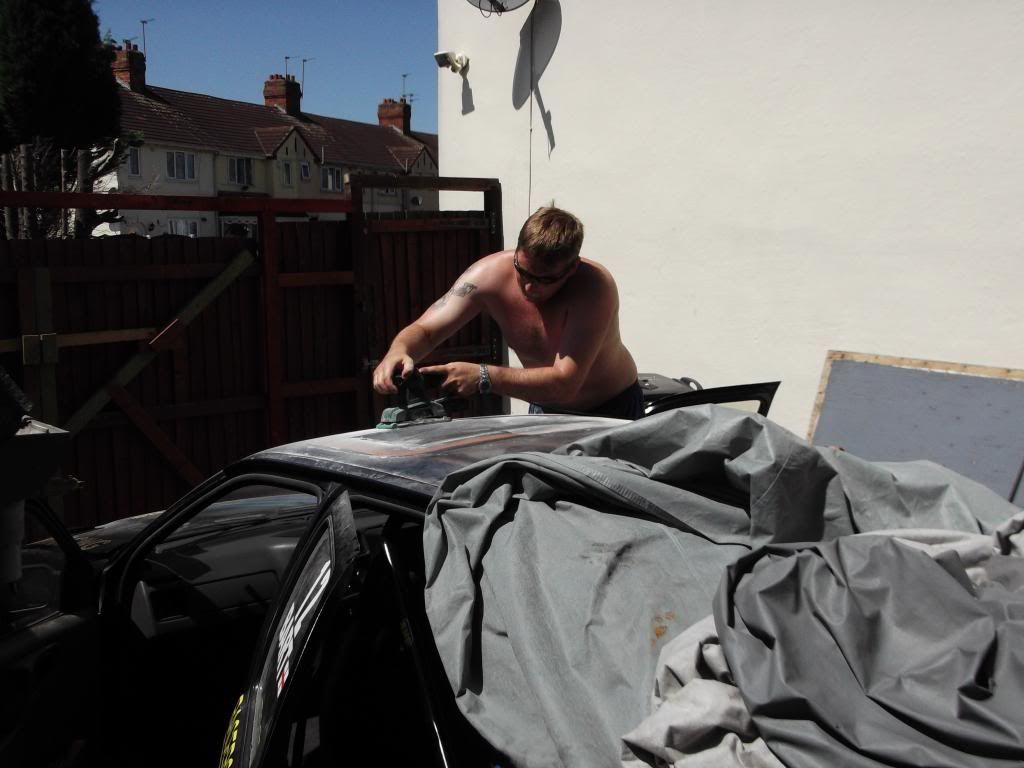

with the weather as hot as its been this last week paul bought over the
gazebo to keep the sun off me and the car.

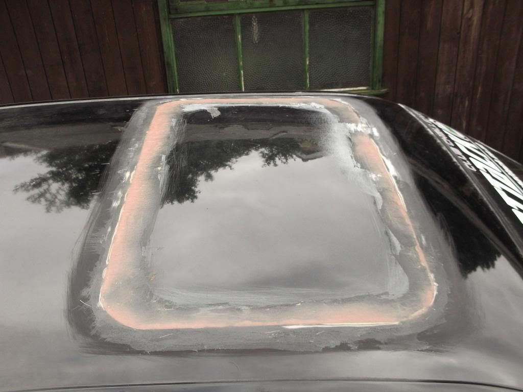

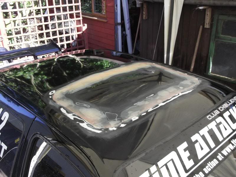

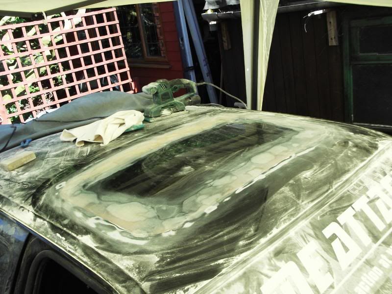

the roof is now hopefully done with the fibreglass filling and skimming
but I had made one hell of a mess doing it:D
before the final wetndry skim
after and had to hose the car off.

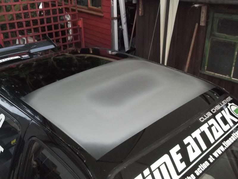

ill give it a coat of primer to see if there are any high or low sections
primed the roof last night
going to leave it till tomorrow then flatten it back
