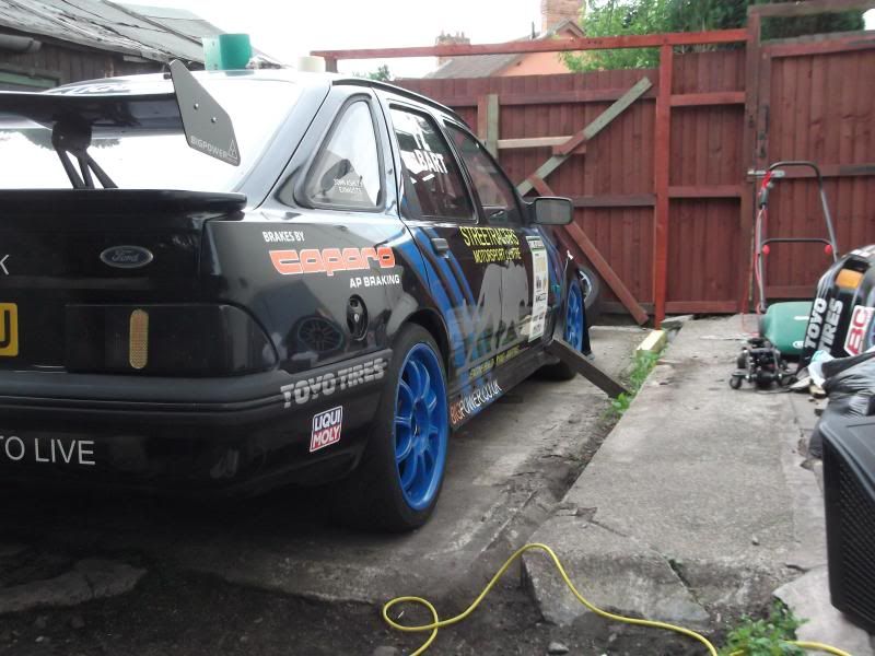

The arches look OK mate........not a huge fan of the blue bit in the bumper aperture but the wheels look nice.......offset may need a boost now. This modding never bloody stops
