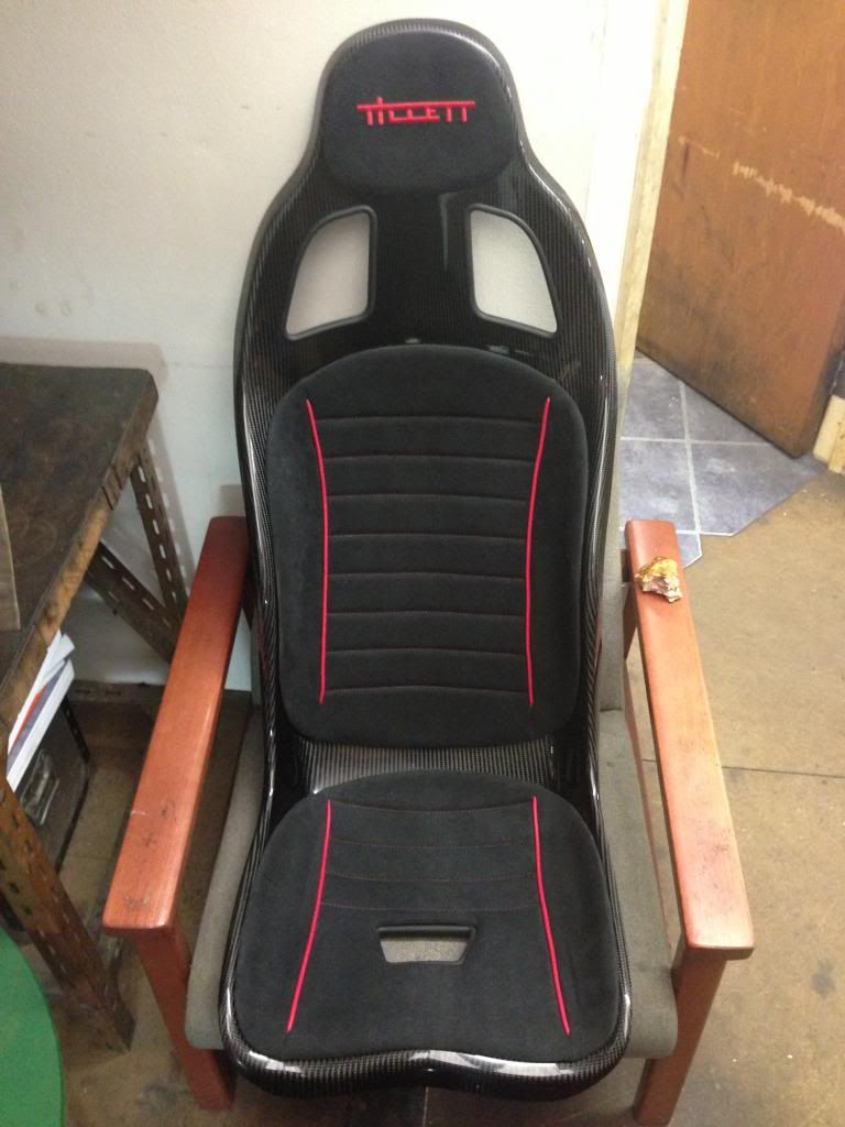

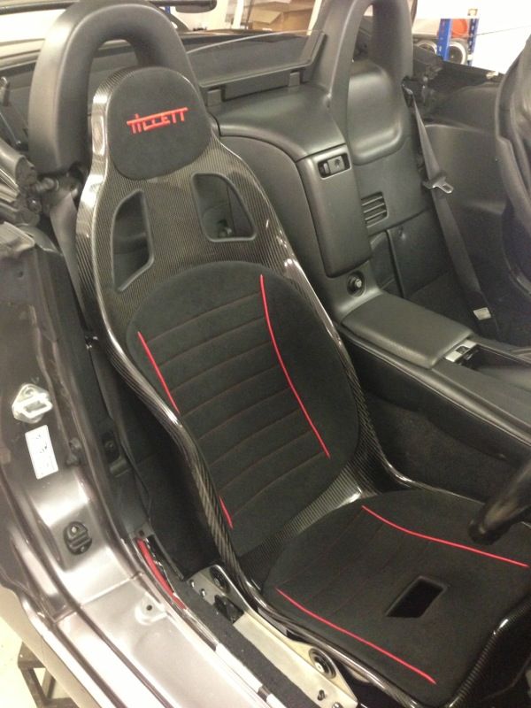

I got my new tillett seats today and they are simply amazing. I had to make some custom brackets to mount them to my replica buddy club rails.
They are so comfy to sit in and so much lower than my recaro's, probably around 1.5" lower.
OMG - they are incredible fella !!!!!
