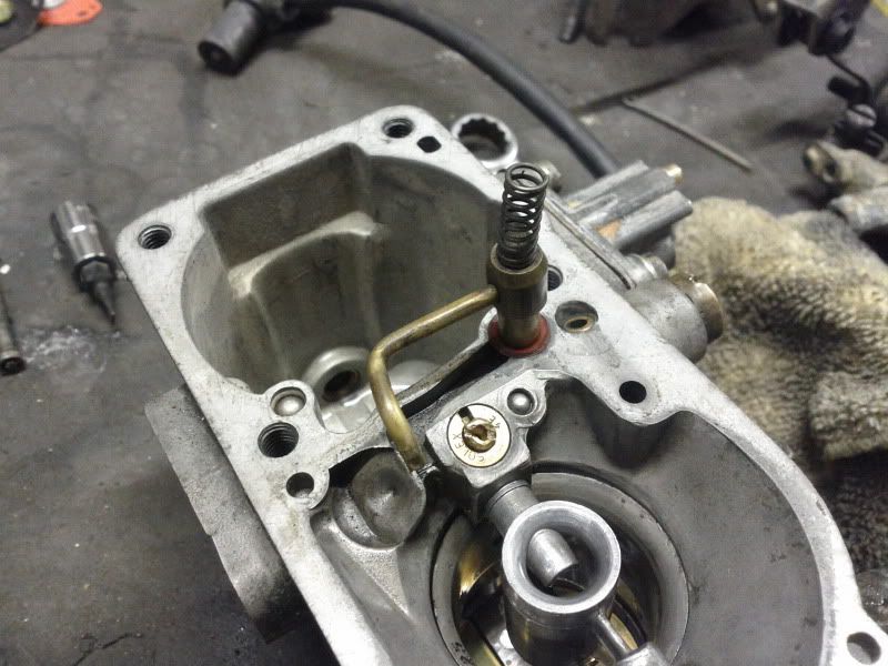

Had the aem uego on the car and it was running majorly lean coming on boost and whilst on boost
So took the carb off the car after fixing the rocker cover leak
Striped the carb from the car and a known good carb in my garage
Gave this little bugger a blowy (accel enrichment jet) and it just wasnt performing :(
So swapped it out with a spare good one, reset the accel pump perfectly paint marked it.
Gave everything a good strip down brake clean and blow out with an air line no dirt to really see as i done it all before.
Then thought bugger it.... a bar of boost sounds nice.... so a few people have run a 1mm air corrector and 1.2mm 2nd stage at the same spec.
So i swapped out the 1.25mm ac jet for a 1mm and then took to drilling out the carb body 2nd stage bush (that if it goes wrong its new carb body time) it quite scary sweat dripping business drilling out the body but it was done quite effortlessly in the end lol
Will get a new fuel filter tomorrow and see what happens fingers crossed at 10psi it overfuels so i can raise the boost up to a bar and its still safe

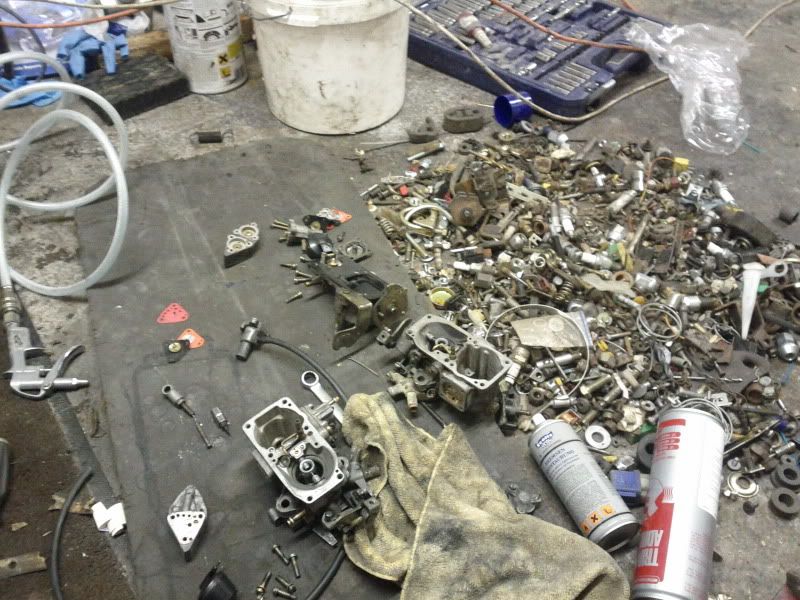

Few piccys
My bucket of bits all over floor looking for new nuts for rocker cover as their some stupid thread m7x1.00 and i have mostly m6x1.00

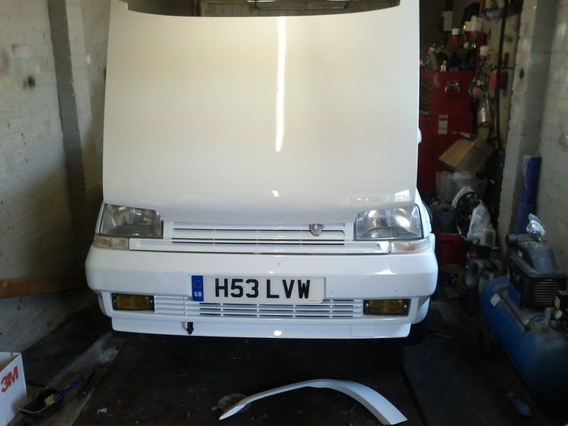

Fixed loose arch and it has a face at last :)

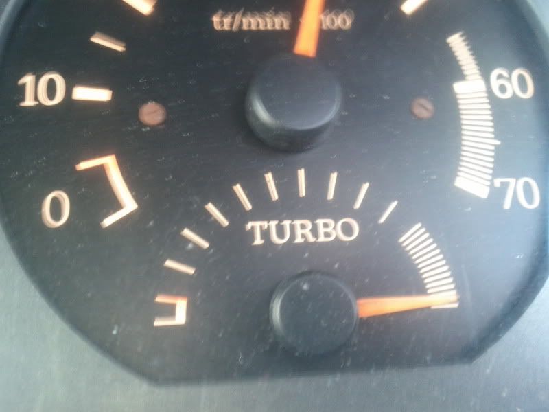

and the good old school dial dash
hehe 14-15psi of boost now :D before it was on the notch above the letter "o"
Fueling seems ok on boost still a tad lean in the middle for my liking so may have a fiddle with the pump adjustment
