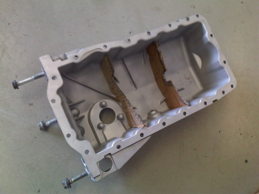

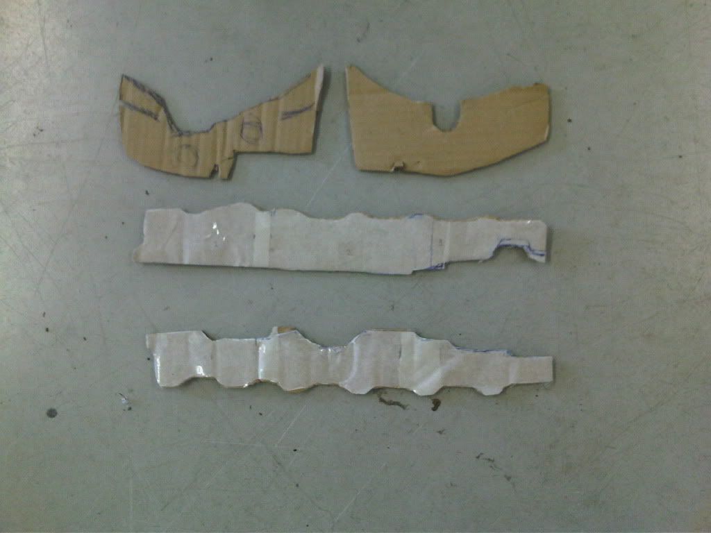

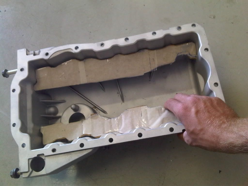

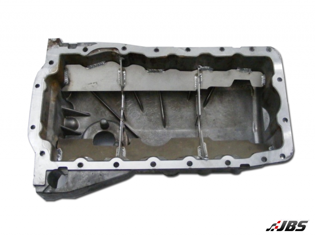

ive been working on mocking up my baffled sump over the last few evenings - i have taken a few pics of my progress
i have made the baffles out of cardboard first of all, next steps will be using this carboard as a template to cut the aluminium, then it will offered up on my old block and crank to make sure it does foul on anything
then will be welded in place and ready to fit :)

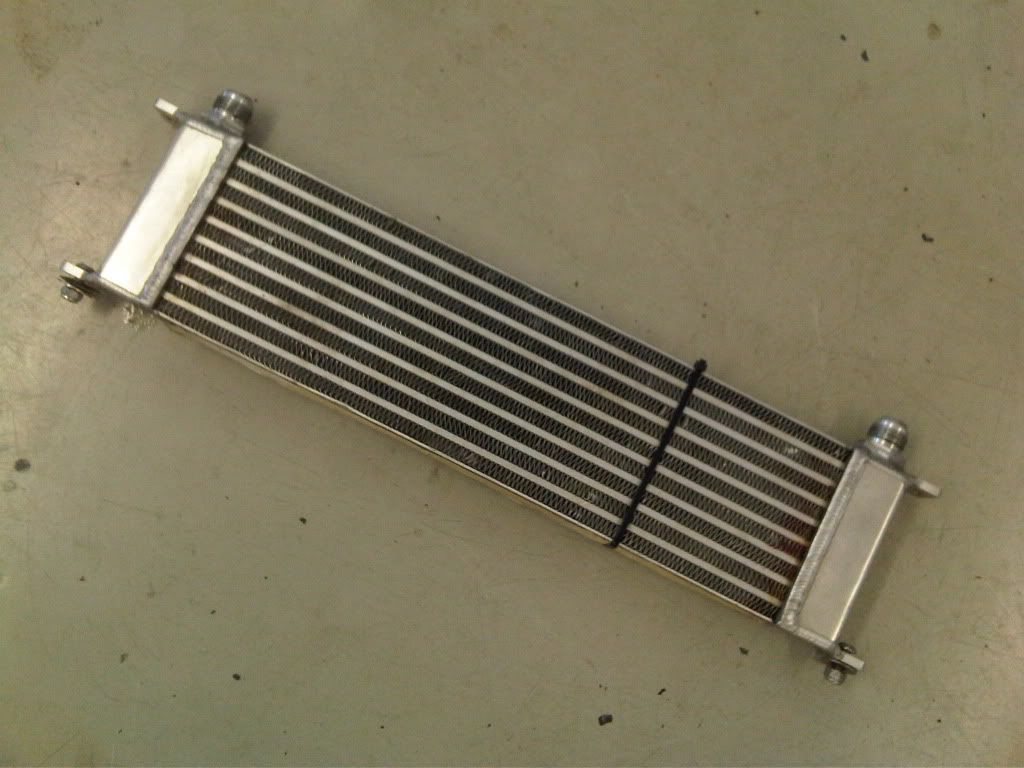

also my uber cheap oil cooler has arrived, im really happy with it - not only is it in superb condition(nearly new) it was also made by AH Fabrications so also a very very good quality item :sifone:

Fair play Rob; I presumed that baffled sumps require some kind of techie style knowledge about flow, pick ups and that sort of thing.............have you seen a 'proper' one and tried to copy that or are you just winging it? (Excuse the pun)

Baffleds sumps arent particularly techie to be honest mate, all they need to do is stop oil sloshing about and keep the oil in the right place(around the oil pick up) the only slight techical pats are making gates help direct the oil where you want it to go/stay
there are alot of decent companies who make them, such as Backdraft motorsport and JBS
this is the baffled sump im emulating:
in regards the induction kit, its a green cotton one which was removed from a 300zx TT, i had a KN panel filter previously...when we got 300zx in for breaking, ben thought it was a good idea to fit the induction fit from that to the S3, i said yes but only if the cone filter would fit straight onto the AFM without any pissing about...and as luck would have it, it did!! :thumbs:

When I said 'techie' I meant if you were starting from scratch in terms of design, which you clearly aren't! :D That JBS one looks similar to the Backdraft one and they are rated very highly. I may have a look at my induction then as I have a stainless cone filter just sitting around doing FA!

yeah all the different companies baffled sump's look identical, if you decide to go down the same route as me let me know as i should be able to get you the ally, the measurements and also i will have a spare sump too ;)

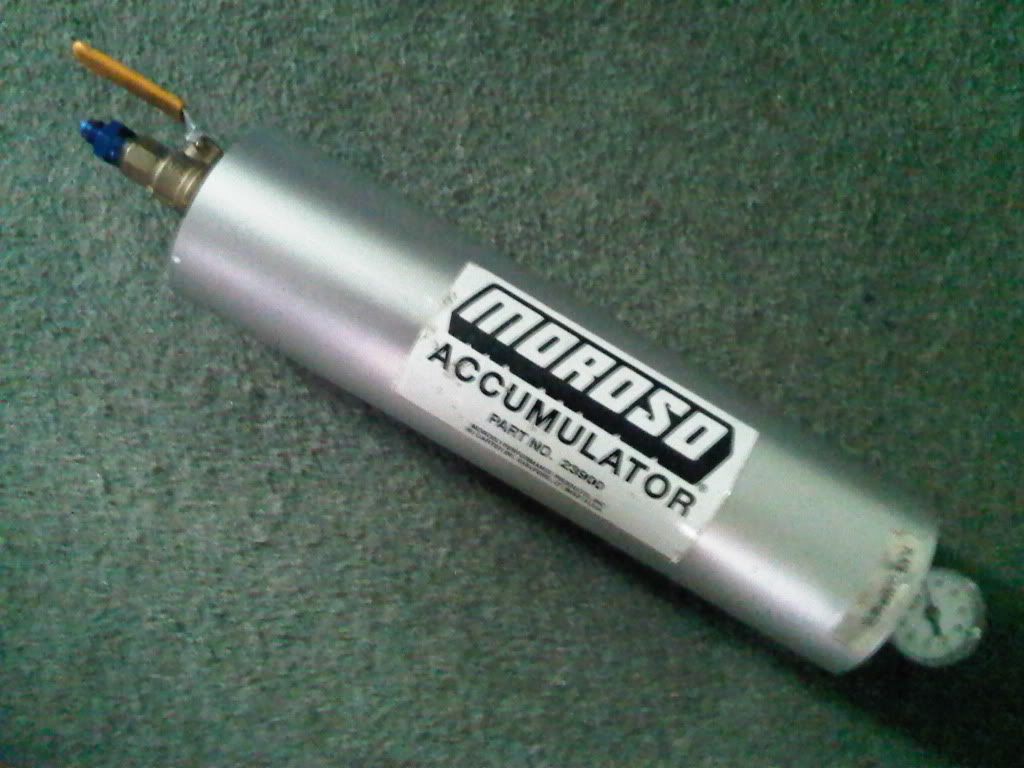

Also my acusump arrived, so now time to plan where the hell its going to go...lol
as you can see its rather large!!

it was a fleabay bargain like the AHF oil cooler - oh and i flushed that out yesterday so its literally good as new and ready to fit
just gonna struggle to fit it in, think i have gone OTT or both the cooler and accusump...its gonna be a squeeze!!
