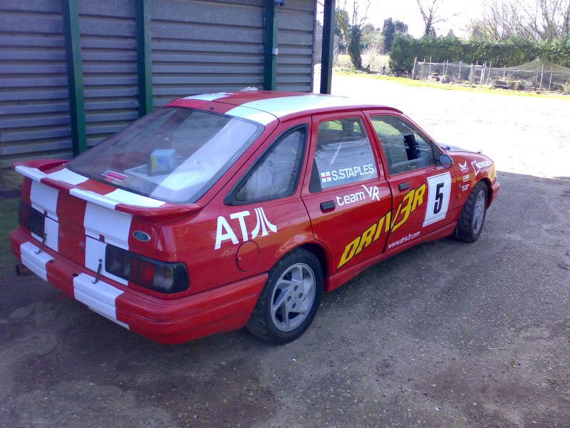

No worries its not as hard as people think. One you have sussed the heat and wire speeds you will be away and welding everthing in sight :-D And i have fitted a few roll cages in my time ones with chick bars into the doors and cages that come through and pick up the front turrets on a sierra and full cages like this the pic is of a sierra cage

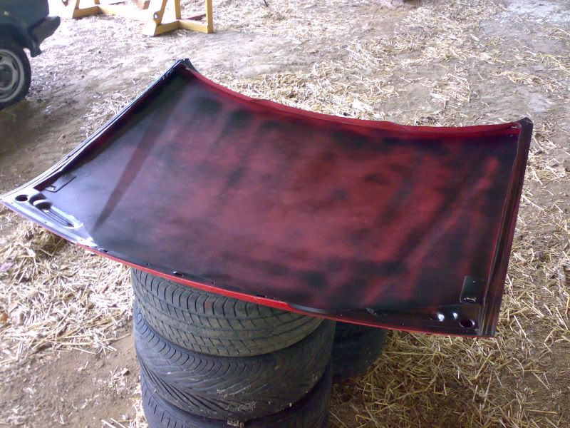

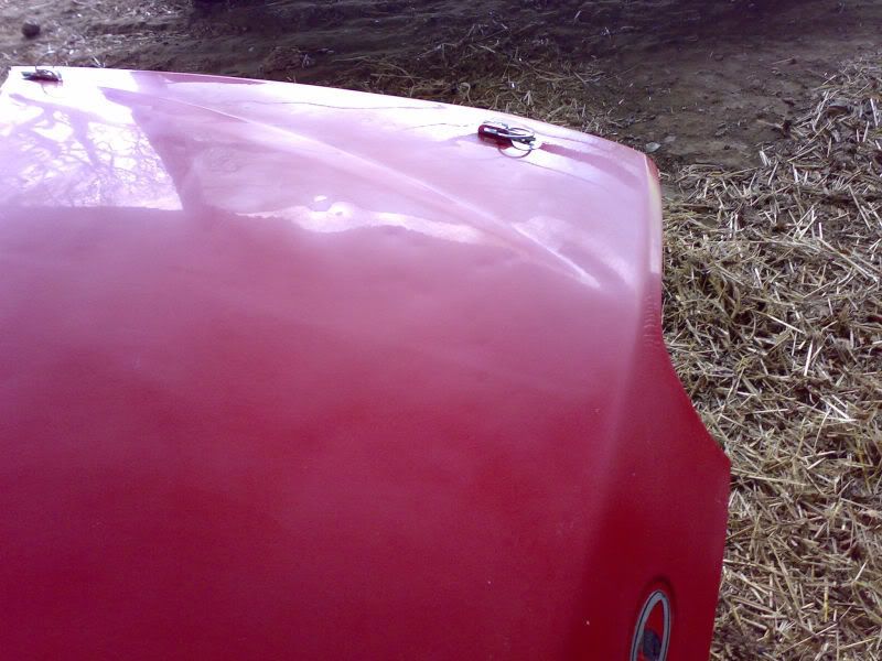

I thought I'd better do a discrete test panel just incase something went horribly wrong.......this is when I found out how much fun painting stuff is :D

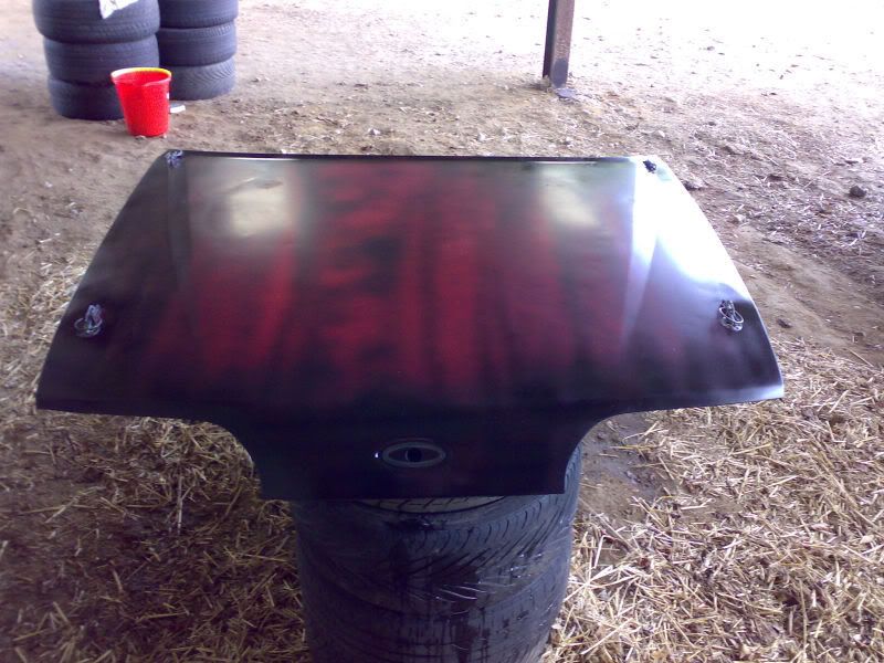

Didn't go on too badly and it smelled great :wack: I did another coat after 20 minutes for drying, and repeated this process until the red was no more. Then flipped the bonnet over for round two.

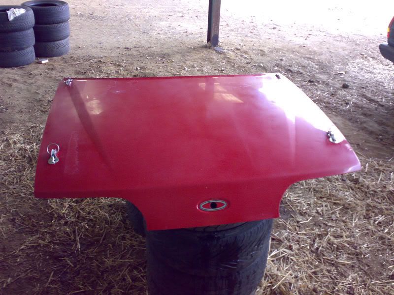

I was going to go for the proper tramp look and paint over the bird shit that was on there, but decided against it in the end. A quick wash was required, followed by a degrease with petrol to remove any traces of adhesive from the vinyls. This left the paintwork looking like this

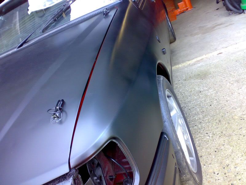

Gary Funnell had told me to gently abrade the surface of the paint with a scotch pad to offer the new paint something to key into. Great advice buddy :thumb: On with the first external coat
A few more coats following the procedure above (paint, leave for 20 minutes, paint again) and this was the finished article

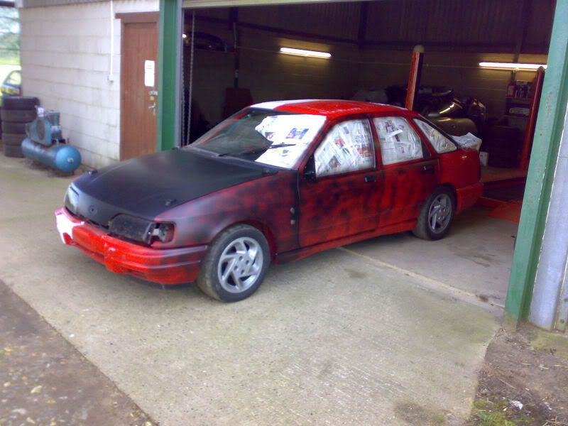

After Princess Womack moved his fake (sorry replica) Nismo 400r I could actually move my car for the first time since we took the unit last Summer. A few groans from the suspension, hopefully that was the lay up and not my new fighting weight that caused it, and I rolled the car outside for more of the same.
More prep

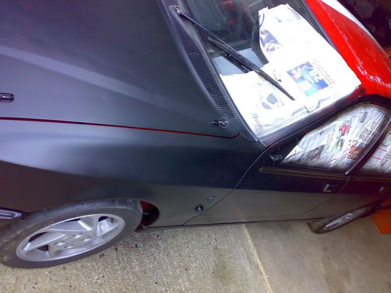

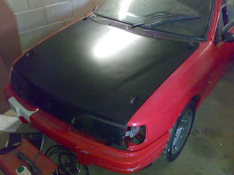

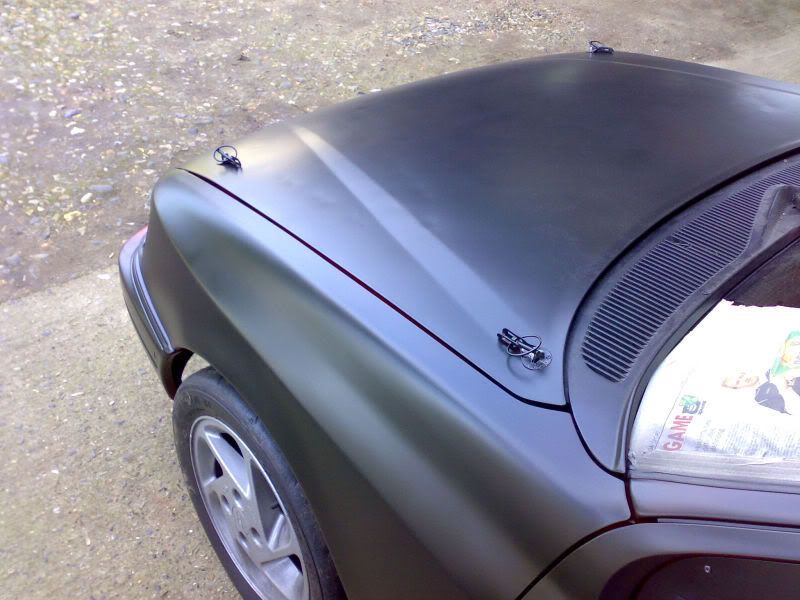

And now the first coat of aerosal number 6

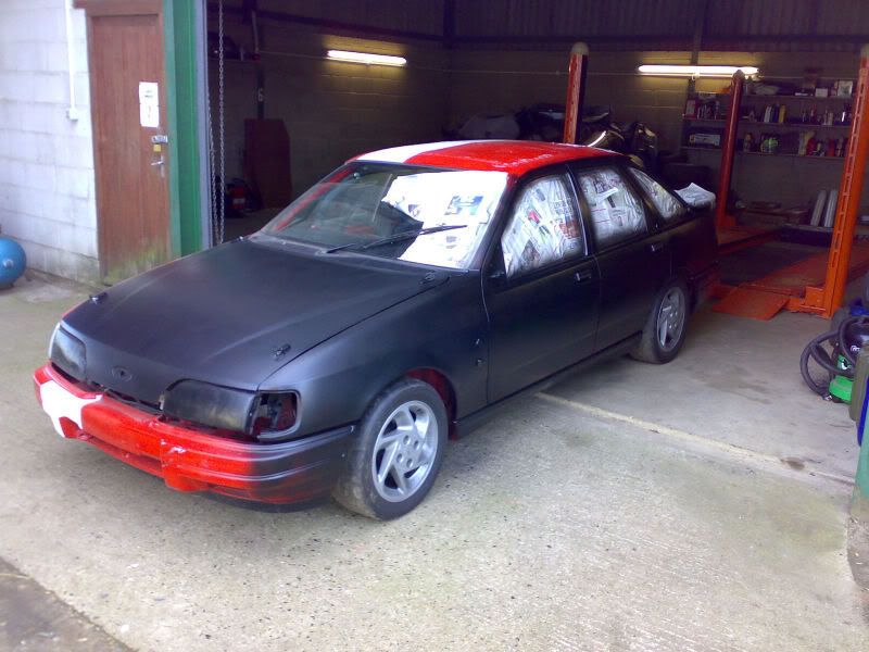

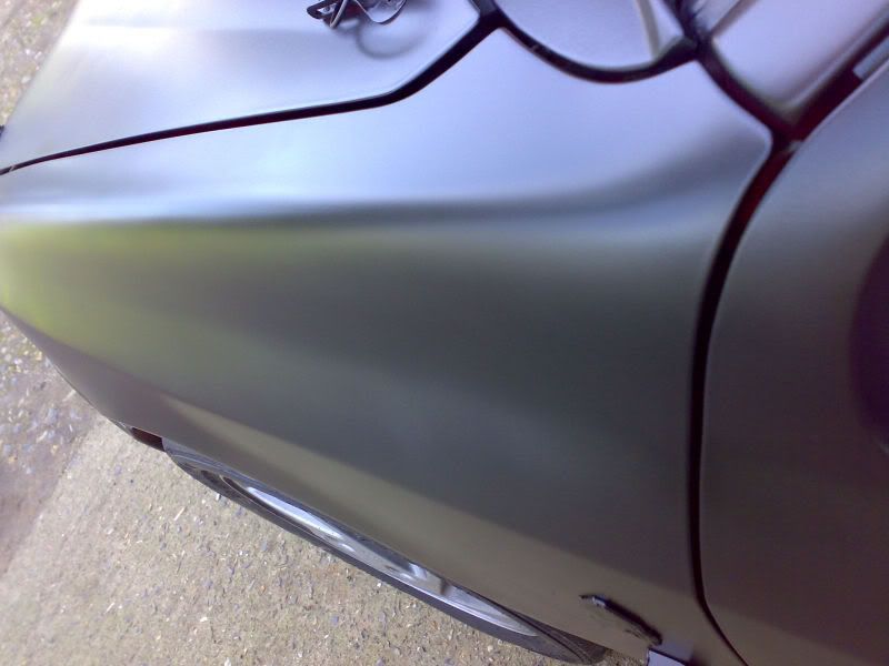

This was the first time I could start to see just what the finished 'look' would be like. I was chuffed :D More paint and some close ups
Look at those swage lines :o Couldn't believe how this colour made them stand out.
