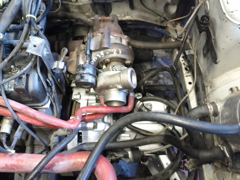

Gearbox is out with the engine in situ.
Its tight but not hard as i've not sworn at it yet this morning.

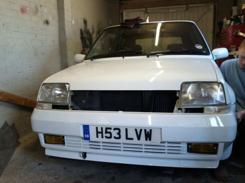

Bonnet and bumper off. Covers on and an no zips on trousers rule set down we like the paint work unscratched :)

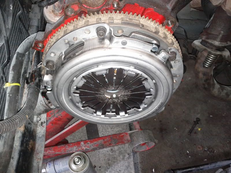

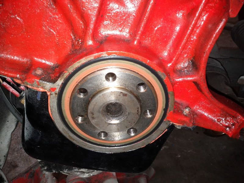

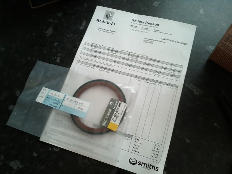

Found my persistant oil leak - rear main oil seal wrong way round
Found a possibly cause to my funny vibration at 50mph

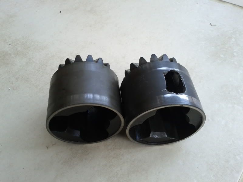

Yup thats a hole in the diff and some pretty deep grooves,
The shaft bearings looks fine and theres no pieces floating in the other half of the diff...

Rear main oil seal fitted wrong way round causing my oil leak thats gone over the flywheel and clutch
Gearbox n/s diff section has a hole in it and deep grooves

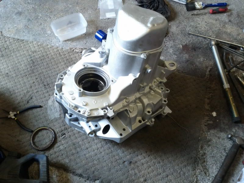

The bro did some cleaning while i removed the gearbox
Now to de-grease and repaint the box silver casing and black end cover like it should be
Nice diff! :)

yup didn't need to drop the subframe
All we did was undo the subframe bar that runs from inner wing to wishbone bolt and remove the front stud in the block, bit of moving about and jacking of engine up with a rubber block on the jack and it soon popped out.
people said its either engine+gearbox out on crane or drop the subframe and tbh this way was much easier after alot of horror story reading on the net

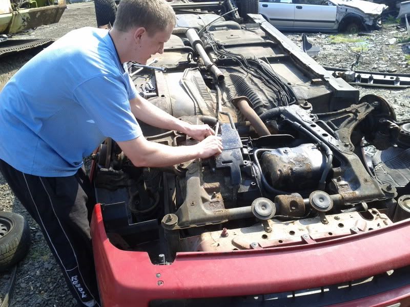

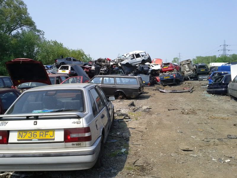

Went on the hunt for a new diff gear and went to the local volvo scrappy as it was the only one open today :roll:
there is a few good 440 turbos in here hiding
Rolled over a 440 1.8 no turbo and got to work
Oh yeah no more holes

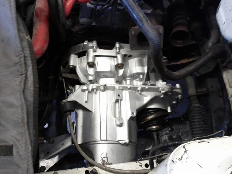

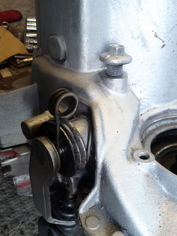

found this awesome idea on the same gearbox, Return spring on the gearbox rather than the linkage. so far it seems to work fine
Gearbox in
Got a mega headache so come in for a rest and tablets so this is as far as i am now

most surprising thing today has been the fact nothing has broken....
suffered
A leaking driveshaft seal so gearoil was coming out faster than we could put it in lol
And a loose starter solenoid wire which made us poo ourselfs a little when the engine didn't turn over
Had a little movement in the garage and the clutch is a bit grabby... nearly run the bro over whoops
Just need to refit the bumper and bonnet and give it a test drive tomorrow recheck for leaks and all being good then go out and buy a roll pin for the drivers side driveshaft

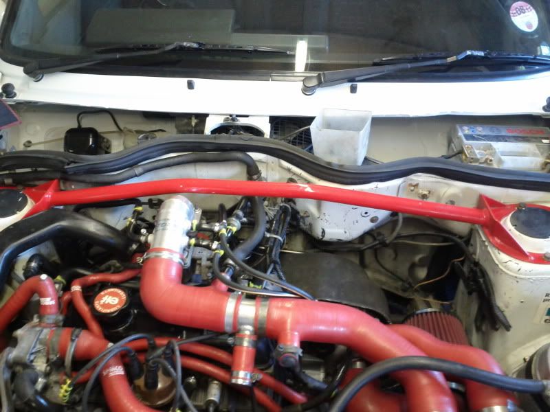

Then we decided to put the strut brace on since "fingers crossed/touch wood" all the engine work is done
We then cleaned up the earths on the front of the car and put the bumper and bonnet back on
