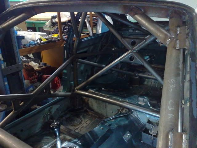

heres a couple of pics to show my progress so far :grin:
still loads to do but i'm getting there slowly :roll:
cheers
jason

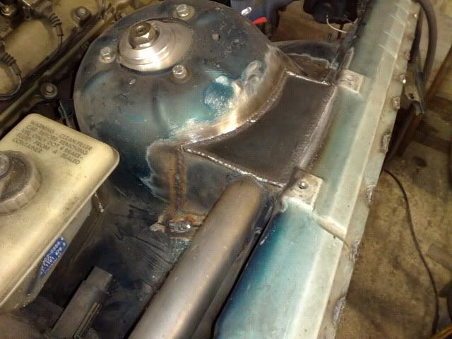

Slowly? Pull the other one :grin: Looking excellent - a proper cage! You realise you're going to have to go all the way with this car - something like a 350+ bhp engine :twisted:
Nice pick up on the front turret and I spy some stitch welding going on too 8)

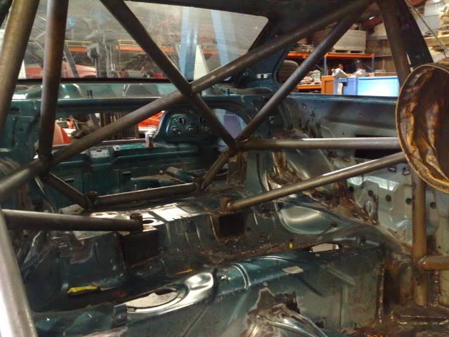

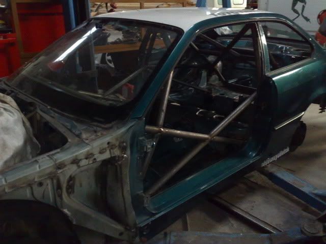

cage finished ,hopfully being painted this weekend :grin:
cheers
jason
Have you checked to see that you can fit in there buddy ;)
The cage looks well put together, nice welding from what I can see also
Keep up the excellent work mate

did you make the cage up on your own ? or buy it and weld it in yourself ?
trevor i bought a custom cages core kit which is basicly four pieces of bent tube , and i made the rest :wink:
cheers
jason
