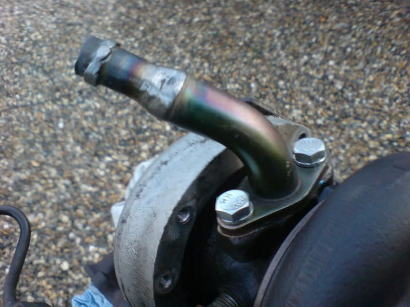

This week i have been fabricating all the little bits needed to run the S13 turbo on a S12. So much for the legendary forum 'bolt on' swap!! :roll:
I had to make this pipe up so the oil return pipe will work, its a combination of a Skyline one and a S12 one;

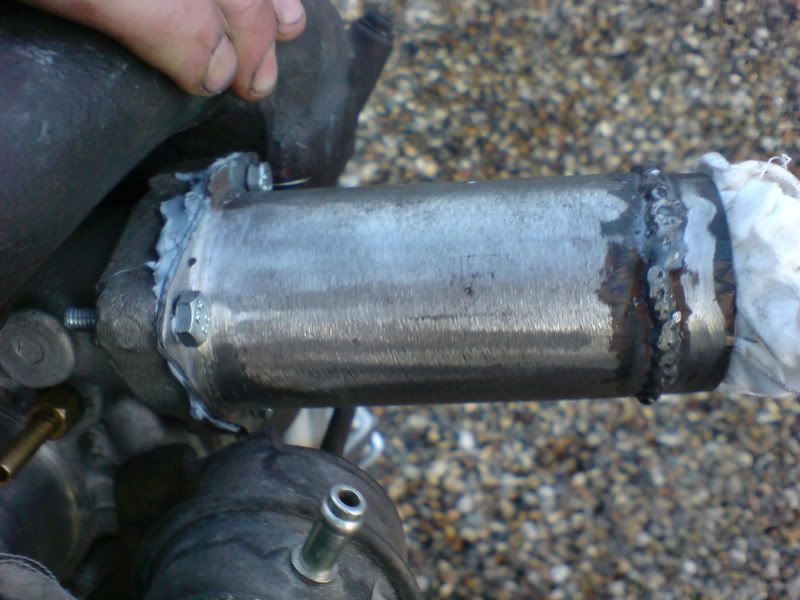

This is the pipe i had to make up to bolt to the S13 turbo outlet, i have left it short so i can build off of it to run an intercooler. Note the ring of weld to stop the pipe blowing off when we are running 3bar of booooost! :P

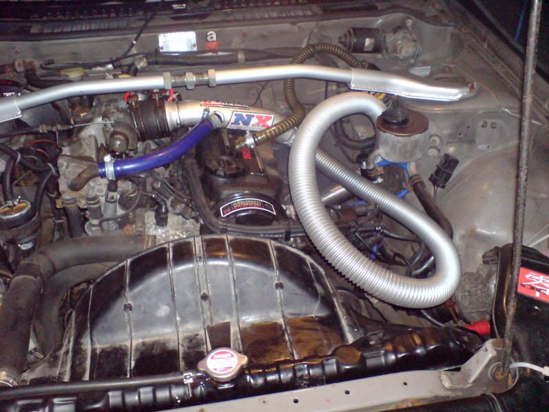

Got the old girl running the other week after we put it all back together with the new turbo and custom oil feed etc.
The only thing we could find to link the turbo to the inlet now that it has all been cut about was Niks vacuum cleaner hose, it was a sacrifice we had to make!!
The noise it made with a bigger turbo and just an elbow on it was so raw!!!

We have found out that the intercooler we bought is from a R34 GTR v-spec!
The vacuum hose certianly is delivering HOT boost untill we get the intercooler fitted and connected up. Not sure my other half likes the fact that the vacuum is now a part of the S12 and she needs to ask for it back to use the hoover.
